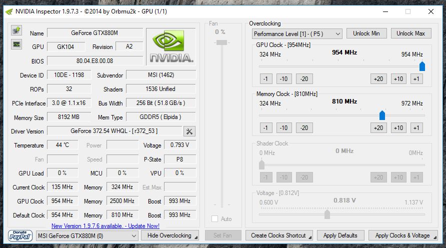

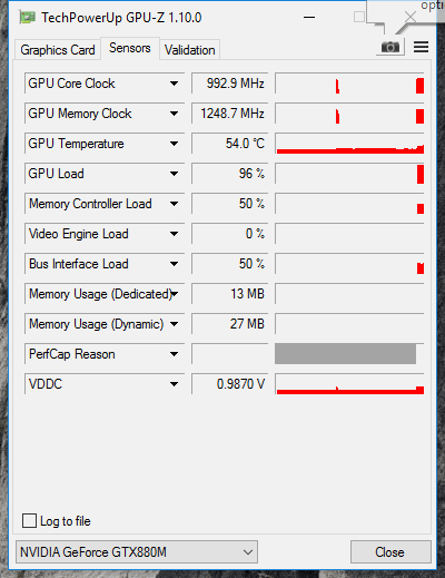

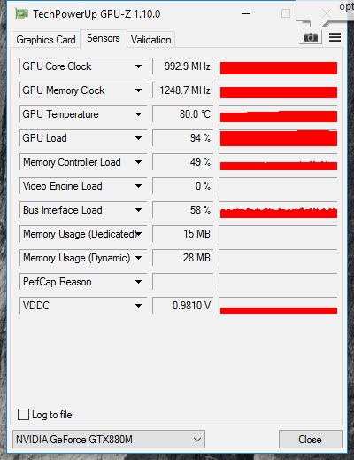

My card maxes out at a VDDC of 0.9870/0.9810 (snapshot attached)

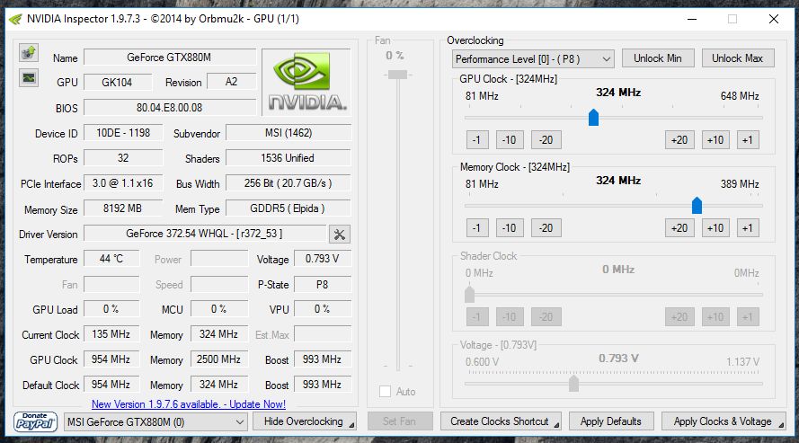

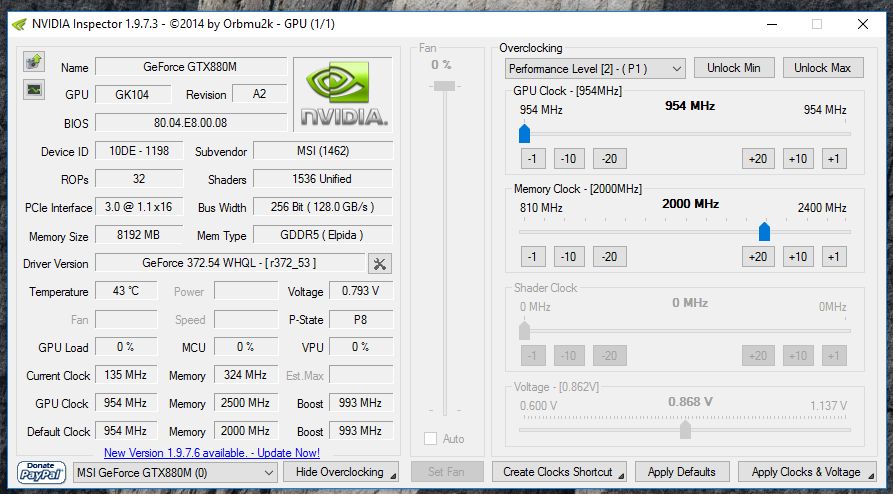

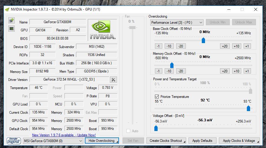

I have also attached the 4 perfomance state snapshots from nvidia inspector. If you see the first three screens, it shows the VDDC range from 0.600V to 1.137V (greyed out). On the last one it shows the voltage offset.

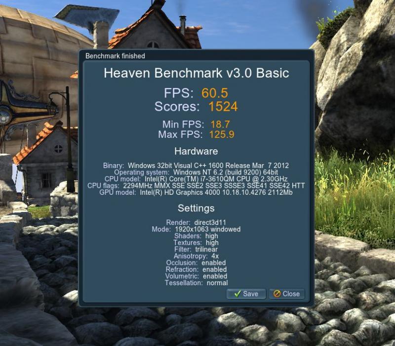

I have also attached a unigine heaven bench result. It shows 60.6 fps. According to NotebookCheck it should be 80!!

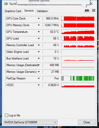

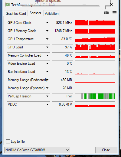

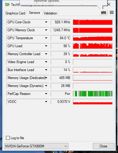

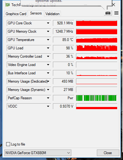

I have also attached the gpuz perf cap pwr snapshots too. Note: I am in a very hot country, ambient temperature is ~35. CPUs and GPUs often go to around 85 degrees or so, we know it is normal here. That aside, if you see the snapshots, everytime the card gets near full load (>95% or so), gpuz shows perf cap pwr, and VDDC lingers around 0.9370. You can see that throughout the benchmark the whole bar is green almost all the way throughout!

Plz note, I do not know what many of these terms mean (VDDC (the gpuz tooltip says it's the voltage the card is getting, thus I guessed that that's what the card isn't getting enough of), Voltage Offset), and I had the urge to change the voltage offset, but didn't before I understood what it was so I didn't burn my card out of dumb trial and error.

In addition, quite oddly, the unigine bench shows the GPU model as the built in Intel HD 4000 :S:S:S

Looks like you are getting some power throttling and possibly thermal throttling as well. The temps are higher than ideal, and the stock 880M vBIOS always sucks. No 880M will work well with stock vBIOS IMHO. Erratic behavior an throttling has been a problem for 880M since day one, and a stock vBIOS really exacerbates its shortcoming. NVIDIA screwed it up very bad and that is why you have a Pwr PerfCap reason. However, with the right vBIOS mod you can get it to perform quite nicely... much better than your old GPU. You're going to need to try to get those temperatures down because they are contributing to the issue. That may have been why the original GPU expired. Heat will shorted GPU life and can kill them if left unchecked.
Grab the modded vBIOS for 880M in the Kepler vBIOS mods thread and give that a go once you earn the download priviledges. Or, you can do a T|I Elite membership if you are in a hurry.
