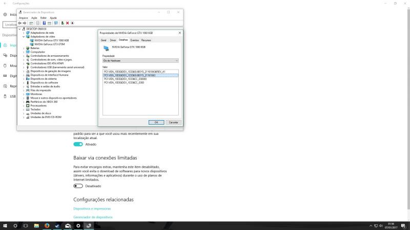

right click on start bottom and choose device manager then go to display adaptors tab and double click on ur gpu
a menu will popup then go to details and choose hardware Ids in menu we will need just secound line

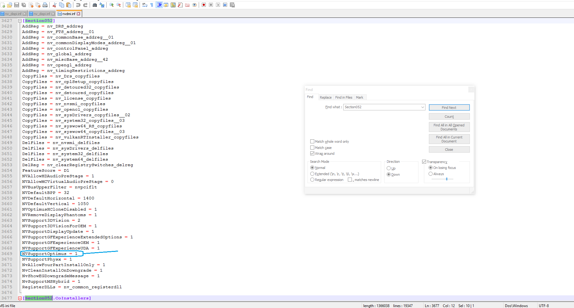

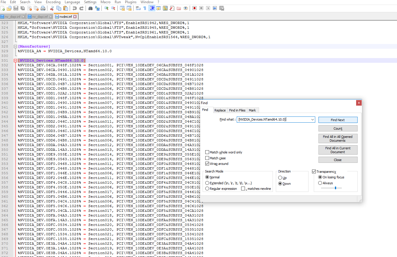

after that in .inf u choosed click on (CTRL+F) a tab will popup and then type >> NVIDIA_Devices.NTamd64.10.0 << hit enter WKNsH6c.png, then type ur Device ID (The number after DEV_ )U6YypH3.png
u will see max 2 lines for ur number but different section no. and also subsystem numbers we need now to just put a line like that for the gpu we have but what section we will choose!!
easy same section for the one of those have (this line >> NVSupportOptimus = 1 <<) so we will just in search tab we will go to both section by type again Section0xx (*xx ur no.s)
and see what section of those have NVSupportOptimus = 1

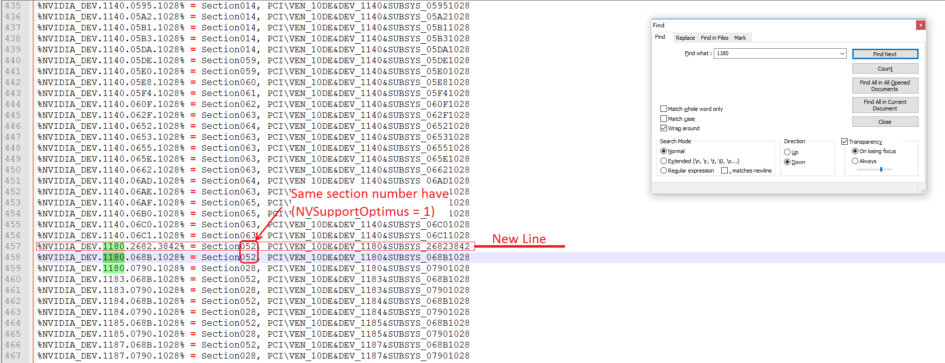

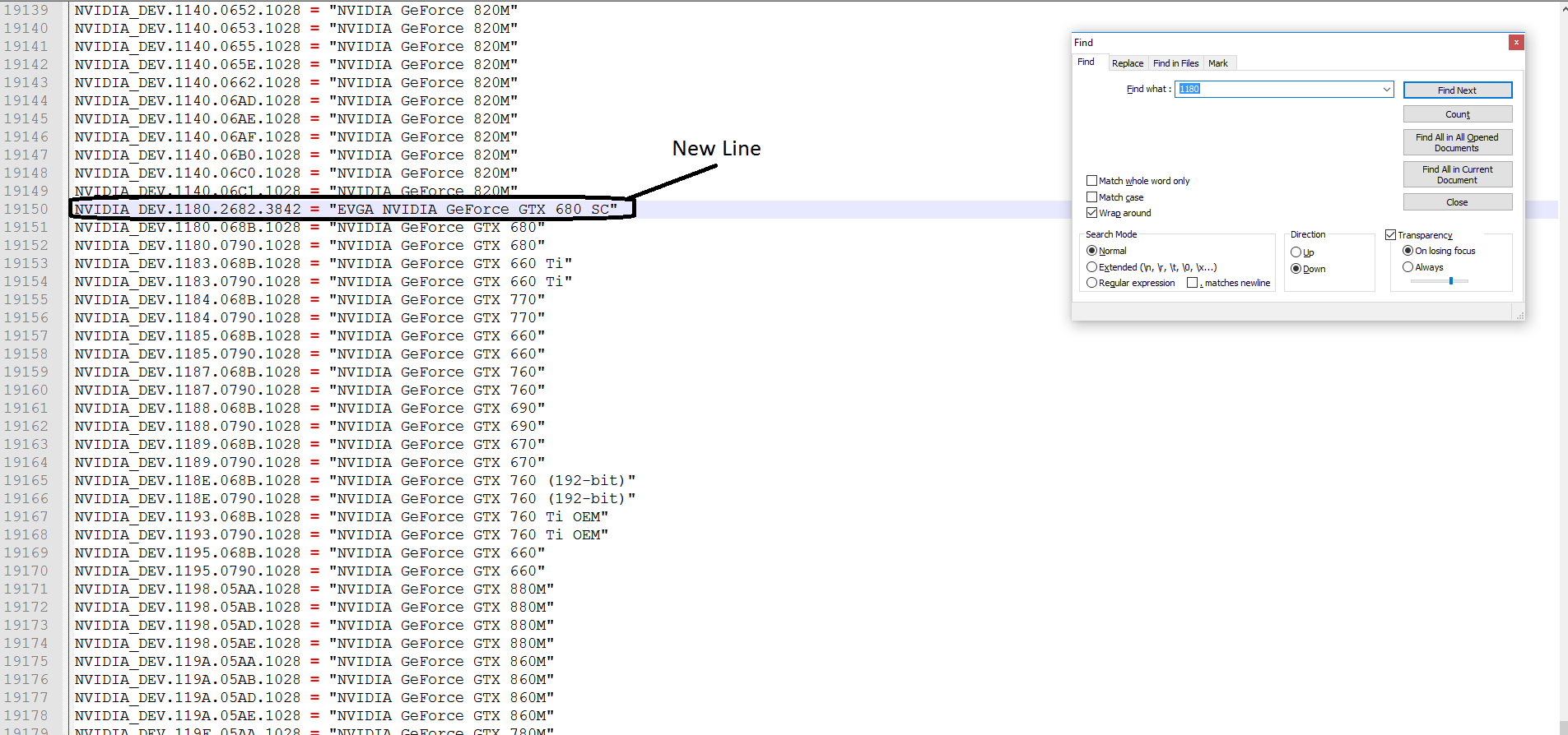

then go back to NVIDIA_Devices.NTamd64.10.0 and add another new line just copy any line under NVIDIA_Devices.NTamd64.10.0
and change as ur PCI\VEN_XXXX&DEV_XXXX&SUBSYS_XXXXXXXX as above photo (New Line)
& section u will enter the one have NVSupportOptimus = 1 (for me 52 not 28 as u see in above photo)
after that we need also to add new line but not under NVIDIA_Devices.NTamd64.10.0
search again by enter ur Device ID (or just type GTX XXX* ) *ur GPU model
untill u go to something like that under [string] menu >> NVIDIA_DEV.XXXX.XXXX.XXX = "NVIDIA GeForce GTX XXX"
and enter as same but with ur NVIDIA_DEV.XXXX.XXXX.XXXX  as collor above (between " ..... " u can enter any name u want for ur gpu :D)

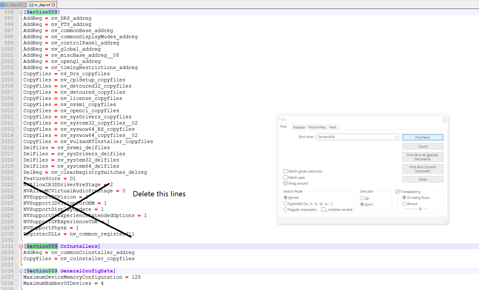

we need also to modify anther .inf in same folder >> Display.Driver <<
but here its just one same .inf file for anyone called nv_dispi.inf

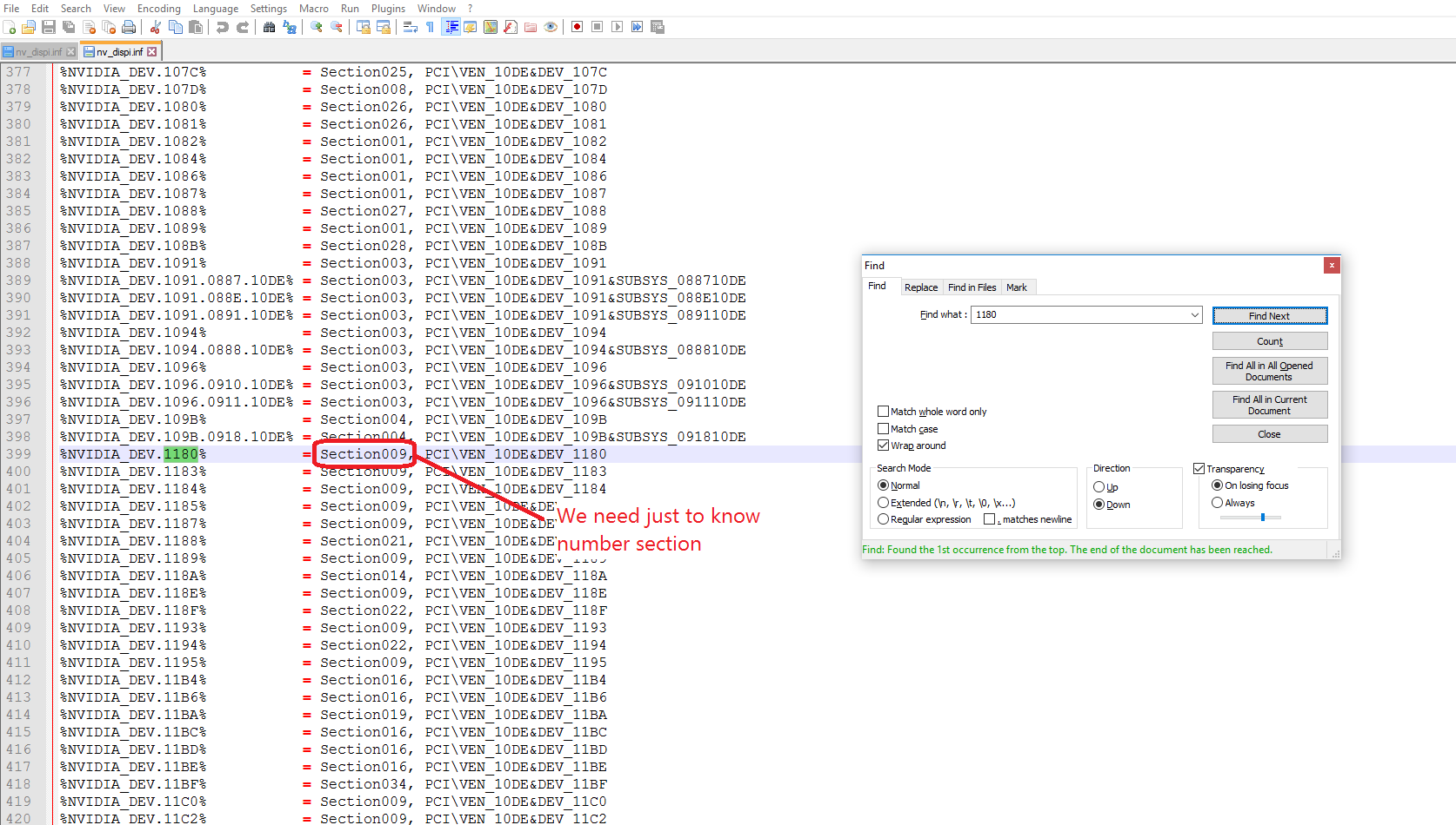

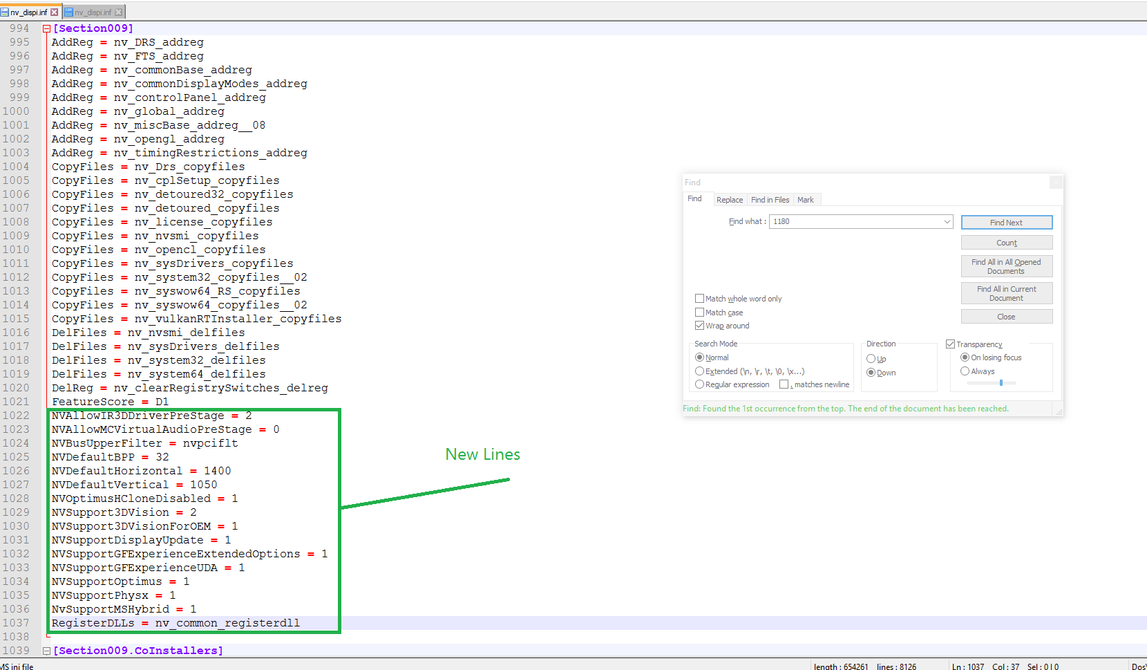

open it by Notepad++ also as above then search by type ur Device ID (The number after DEV_ ) also, then u will just find one line under NVIDIA_Devices.NTamd64.10.0
but here its different section and also line w/o subsystem anyway we just need to know what section for it as mean (section009) but u will be different section no.
then go to [sectionXXX]
we need here to add some new lines under section
replace with new lines
NVAllowIR3DDriverPreStage = 2
NVAllowMCVirtualAudioPreStage = 0
NVBusUpperFilter = nvpciflt
NVDefaultBPP = 32
NVDefaultHorizontal = 1400
NVDefaultVertical = 1050
NVOptimusHCloneDisabled = 1
NVSupport3DVision = 2
NVSupport3DVisionForOEM = 1
NVSupportDisplayUpdate = 1
NVSupportGFExperienceExtendedOptions = 1
NVSupportGFExperienceUDA = 1
NVSupportPhysx = 1
NvSupportMSHybrid = 1
RegisterDLLs = nv_common_registerdll
then hit (Ctrl+S) and exit ...

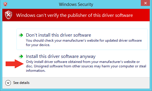

after that also u will need to enter ur windows in "Driver Signature Enforcement (disabled) mode" How >> here u go ..
then after hit f7 restart and login go to nvidia driver folder and double click on setup.exe
u know the next steps :D but w8 when driver is installing the special tab will appear
Hit install this driver software anyway then the setup will continue till finish successfully  & yeah OPTIMUS UNLOCKED :32_002:

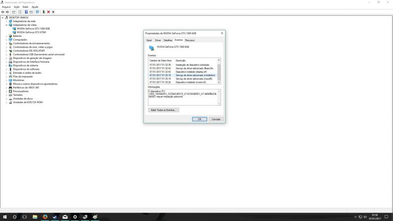

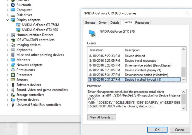

Will this still work with the Windows 10 Anniversary update which requires drivers be signed?
When you go to device manager and look at events, what driver inf file is it using?
I have a similar guide here
But instead of adding lines to nvdispi.inf, I removed the desktop driver so that it HAS to use the notebook drivers.
I think what you have done is add capabilities to the desktop driver.
If your device manager says it is using nv_dispi.inf, you can skip the first part modifying notebook vendor inf and just go straight to modifying nv_dispi.inf.
Its showing now nvdmi.inf (dell) now but thats why >> cuz the modding effect. Before modding if u just install the stock driver w/o mod nv_dispi.inf will just show.. and thats why >> cuz nvdmi.inf wasnt have the right line for gpu to detect so its just picked the line was in nv_dispi.inf (w/o the lines added in there section), so both depend on each other.

When I check nvdmi.inf
  Reveal hidden contents
could I enable optimus ?

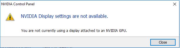

But it still doesn't work.  The optimus icon shows up, but it's always "off", and my card always says "Inactive" when I mouse over the icon.  So even if I tell nvidia to use the "High Performance NVIDIA Processor" by default, it never actually does it.

I opened nvpcdi.inf and found my exact card in there, so I commented out the two lines that reference my card:
%NVIDIA_DEV.13C2.1366.19DA% = Section006, PCI\VEN_10DE&DEV_13C2&SUBSYS_136619DA  (in the [NVIDIA_Devices.NTamd64.10.0] section)
NVIDIA_DEV.13C2.1366.19DA = "NVIDIA GeForce GTX 970" (In the [Strings] section)
Also opened up  nv_dispi.inf and commented out the other two lines that reference my card type (I just ctrl+F my DEV number, which is 13C2)
%NVIDIA_DEV.13C2%           = Section045, PCI\VEN_10DE&DEV_13C2 (In the [NVIDIA_Devices.NTamd64.10.0] section)
NVIDIA_DEV.13C2 = "NVIDIA GeForce GTX 970" (In the [Strings] section)
Finally, since my vendor .ini (Apple), did not include my type of card, I just went through all of the ones you listed and found my type of card (13C2) in nvdmi.inf (for Dell, so same as yours).
I ctrl-F for my DEV# and found the section that has NVSupportOptimus = 1 (section 113 in my case)
So I added:
%NVIDIA_DEV.13C2.1366.19DA% = Section113, PCI\VEN_10DE&DEV_13C2&SUBSYS_136619DA (to the [NVIDIA_Devices.NTamd64.10.0] section)
NVIDIA_DEV.13C2.1366.19DA = "Zotac NVIDIA GTX 970 eGPU" (To the [Strings] section, I modified the name)
Then I ran DDU on my nvidia drivers, restarted, installed everything, restarted again and boom.  Everything worked.
I'm still curious about the "easier" solution you mentioned.  Maybe it makes more sense than what I just did haha.
EDIT:
I'm using nVidia drivers 368.81 Windows 10 64-bit, and Iris Pro drivers 15.40.25.4463.  These steps might not make sense for other versions.
Edited by UncleGravity
@UncleGravity ooo im rly so glad its worked, xD i think nvdmi.inf is the king here haha
so now i suppose u got in event >> Device installed (nvdmi.inf) << , right?

Frist : Disable Disable Driver Signature as described >> Click Here
Second : replace both files into setup folder then hit setup.exe

Can anyone help me?
I did everything right, my egpu is recognized and functional except by the fact that when i try to play any game it only use intel hd and don't use the GTX.
I'm trying to play using my internal monitor, is it possible? With an external monitor the GTX Works.

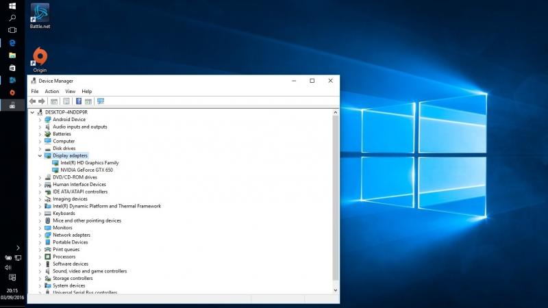

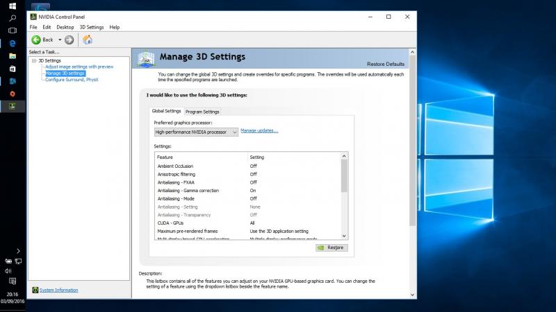

Thanks AGmR, this method really worked for me.
The only problem was that my PC has a dedicated graphic card(Nvidia 820m), i have to disable it first and now everything is working fine.
I'm Using GTX 650 and my notebook is Asus X450LD.

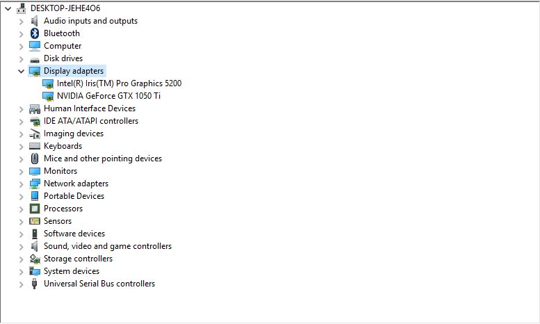

I am trying to enable Optimus on my iMac, as of now i have the following :
- Akitio Thunder 2
- EVGA GTX 1050 Ti SC
- Windows 10 Home
- booting the iMac with apple_set_os.efi, in order to have the Iris enabled so i can see :)
On this setup, the driver (378.78, latest) is installed from nv_dispi.inf section 088, i checked and no NVSupportOptimus exists in that section.
I searched in nvdmi.inf (because this is the only INF that has anything with GTX 1050 Ti ) and for my card i can only find these entries which none of them have Optimus enabled
%NVIDIA_DEV.1C82.068B.1028% = Section277, PCI\VEN_10DE&DEV_1C82&SUBSYS_068B1028
%NVIDIA_DEV.1C82.0790.1028% = Section260, PCI\VEN_10DE&DEV_1C82&SUBSYS_07901028
%NVIDIA_DEV.1C82.079A.1028% = Section275, PCI\VEN_10DE&DEV_1C82&SUBSYS_079A1028
My device should be 1C82.6253.3842
However, connecting the same setup to my Macbook pro retina late 2013 works like a charm and Optimus is enabled, and surprise, the driver is loaded from the same nv_dispi.inf.
Any ideas how to enable it on iMac ? Is there other check that gives result that iMac is not notebook platform and disables Optimus ?
Thanks

I have a desktop with a gtx 1060 the only file that shows up in logs is nv_dispi.inf and also in it i found my card in 2 sections (Section 135 and Section 136). I edited them both, installed the driver and still optimus is not enabled. What i did wrong?
Also dirver version is 388.59
