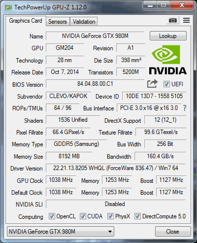

  5. 5 hours ago, sslmm said:
    With the modded inf of clevo (non-optimu) it worked and everything seems do work fine, except the context menu where i could choose the GPU to use with some programs...nothing major as i can do that manually on the nvidia control panel.
    Thanks for all the help.
    Heres my GPU-Z screenshot to add the p150em to the device list if anyone wants it:
    Here you go *nvcvi.inf*, like the P170EM I'll add P150EM from now on.
    nvcvi.inf_v382.05_Win7_8.1_P170EM_P150EM_GTX980M_970M.zip
    nvcvi.inf_v382.05_Win10_P170EM_P150EM_GTX980M_970M.zip
