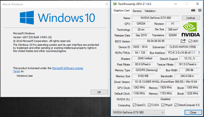

  3. Driver Signature Enforcement. Open command prompt in Administrator mode then type: "bcdedit /set {default} bootmenupolicy legacy" (without quotes) -> Hit enter -> reboot -> Keep holding "F8" key -> Select "Disable Driver Signature Enforcement" -> finally Install drivers.

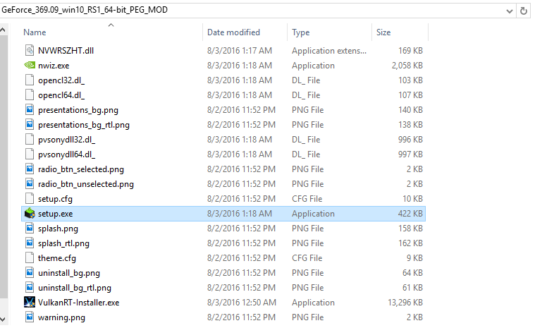

  5. @HaloTechnology Run Memtest then try clearing CMOS, This was after upgrading to RS1? if so try a clean install and use Win10 native AHCI drivers. @haXBOXpro, @Shiroe you need to clean install modded Creative drivers from HERE (latest full package), otherwise Recon3Di control panel won't work. Just disable DSE (F8) before and after installing drivers.

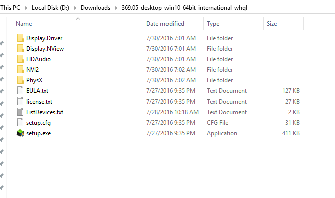

  6. GeForce 372.70 *Install drivers at your own risk* Windows 10 + GeForce Drivers are Killing Samsung and LG Notebook LCD Display Panels Uninstall both PrecisionX & MSI Afterburner (Keep RTSS) including screen overclocking tools *Still at risk* Requirements: Flash latest @Prema's v2 980M & 970M (Please consider donating to Prema) Win10/8.1 'F8' Boot options 'Safe Mode' & 'Disable driver Signing' cmd (Admin) bcdedit /set {default} bootmenupolicy legacy -> reboot -> F8 -> select 'Disable Driver Signature Enforcement' -> Install drivers Run DDU "Clean & Shutdown (Safe Mode) Extract driver using 7-Zip Display.Driver folder, copy/overwrite the proper .inf file(s). Extracted driver package >> delete the following folders as shown below (don't skip this step) -> run setup.exe >>> Keep these folders only <<< INF MOD v372.70 nv_dispi.inf (including nvdmi.inf) PEG/Dedicated All Models: M15x, M17x, AW17 R1, M18x, AW18 R1 (including Optimus/M17xR4) excluding AW 2015 - GTX 980 , 980M , 970M , 965M , 880M , 870M , 860M , 780M , 770M , 765M , 680M , 675MX , 670MX , 660M nvcvi.inf: Optimus Alienware 17 / 05AA (only) GTX 980M - 970M - 965M GeForce 372.70 Win 7/8.1 GeForce 372.70 Win10 RS1 Alienware Laptops nv_dispi.inf_v372.70_Win7_8.1_PEG_Dedicated_Alienware.zip nvcvi.inf_v372.70_Win7_8.1_Optimus_Alienware_17.zip nv_dispi.inf_v372.70_Win10_PEG_Dedicated_Alienware.zip nvcvi.inf_v372.70_Win10_Optimus_Alienware_17.zip Clevo Laptops (non-Optimus) nv_dispi.inf_v372.70_Win7_8.1_PEG_Dedicated_CLEVO.zip nv_dispi.inf_v372.70_Win10_PEG_Dedicated_CLEVO.zip AW 900M Throttling workarounds: M18xR2 Flash @Swick1981 [Bios Mod] M18xR2 - Legacy Support now Available M18xR2 980M workaround Hibernation method HERE and HERE @ All please use the SEARCH function to see if your question has been answered/posted already.

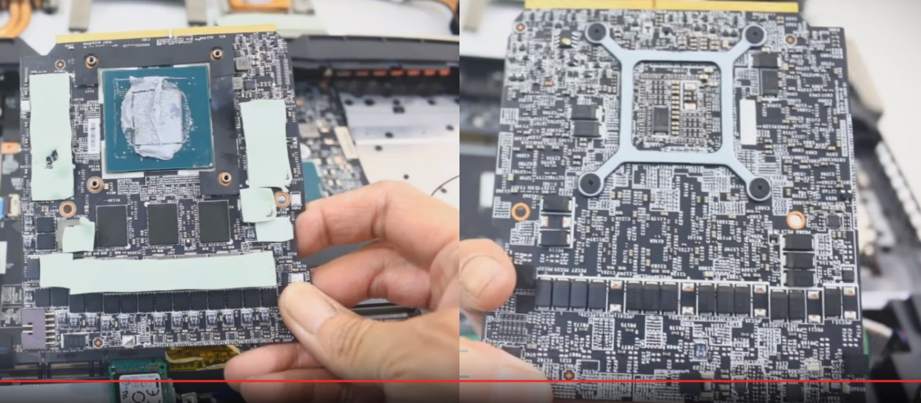

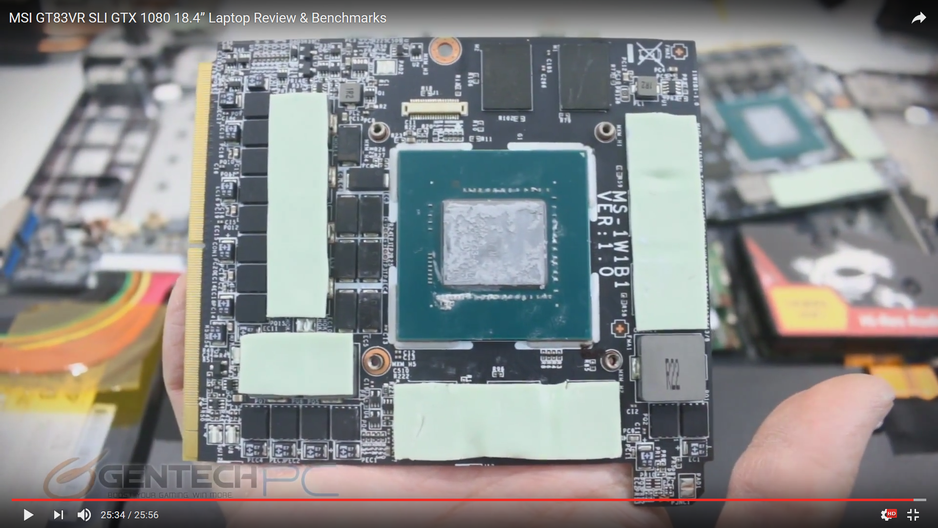

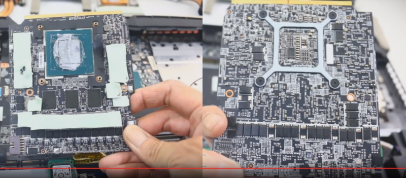

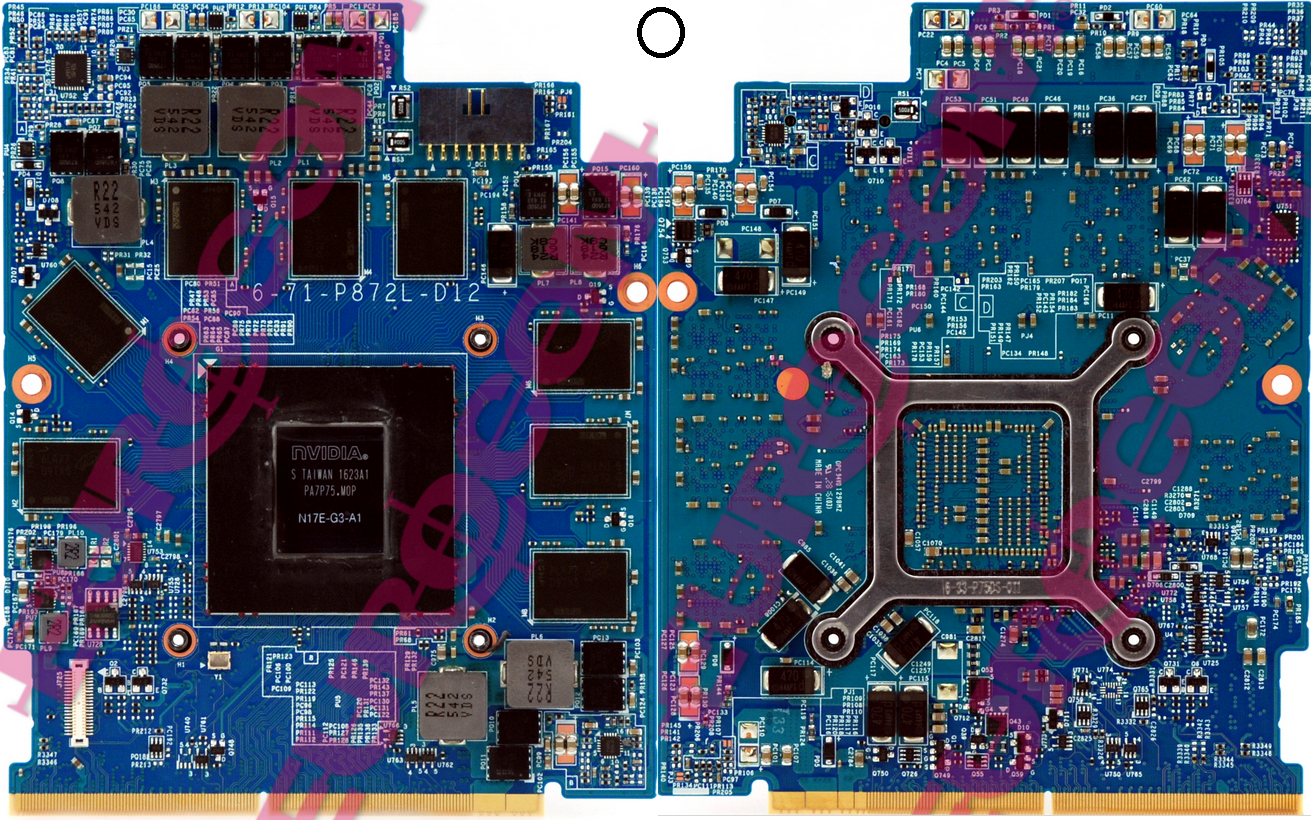

  8. Yeah, I want the card not the laptop. Although MSI understood pretty quick the importance of GPU Upgradability, they're still lousy in the CPU department, incl their ultra-restrictive warranty policy. Greedy bastards, done with laptops.
  9. Clevo 1080 MSI 1080 Cutting corners, besides the obvious Cubist adventure *Duchamp* Gone, gone, gone missing Inductors, Caps and MOSFETs...filling pockets. Hopefully MSI's 1080 won't include this wonderful EC feature. Lesson learned: don't trust Clevo with anything beyond 1K.
  10. Yep, already obsolete P870DM-G flagship, hopefully MSI's 1080 will work fine, even if I need to hard mod it...just not to spend a single dime on Clevo anymore... GeForce 372.54 *Install drivers at your own risk* Windows 10 + GeForce Drivers are Killing Samsung and LG Notebook LCD Display Panels Uninstall both PrecisionX & MSI Afterburner (Keep RTSS) including screen overclocking tools *Still at risk* Requirements: Flash latest @Prema's v2 980M & 970M (Please consider donating to Prema) Win10/8.1 'F8' Boot options 'Safe Mode' & 'Disable driver Signing' cmd (Admin) bcdedit /set {default} bootmenupolicy legacy -> reboot -> F8 -> select 'Disable Driver Signature Enforcement' -> Install drivers Run DDU "Clean & Shutdown (Safe Mode) Extract driver using 7-Zip Display.Driver folder, copy/overwrite the proper .inf file(s). Extracted driver package >> delete the following folders as shown below (don't skip this step) -> run setup.exe >>> Keep these folders only <<< INF MOD v372.54 nv_dispi.inf (including nvdmi.inf) PEG/Dedicated All Models: M15x, M17x, AW17 R1, M18x, AW18 R1 (including Optimus/M17xR4) excluding AW 2015 - GTX 980 , 980M , 970M , 965M , 880M , 870M , 860M , 780M , 770M , 765M , 680M , 675MX , 670MX , 660M nvcvi.inf: Optimus Alienware 17 / 05AA (only) GTX 980M - 970M - 965M GeForce 372.54 Win 7/8.1 GeForce 372.54 Win10 RS1 Alienware Laptops nv_dispi.inf_v372.54_Win7_8.1_PEG_Dedicated_Alienware.zip nvcvi.inf_v372.54_Win7_8.1_Optimus_Alienware_17.zip nv_dispi.inf_v372.54_Win10_PEG_Dedicated_Alienware.zip nvcvi.inf_v372.54_Win10_Optimus_Alienware_17.zip Clevo Laptops (non-Optimus) nv_dispi.inf_v372.54_Win7_8.1_PEG_Dedicated_CLEVO.zip nv_dispi.inf_v372.54_Win10_PEG_Dedicated_CLEVO.zip AW 900M Throttling workarounds: M18xR2 Flash @Swick1981 [Bios Mod] M18xR2 - Legacy Support now Available M18xR2 980M workaround Hibernation method HERE and HERE @haXBOXpro try a clean install HERE, also disable DSE before and after installing Creative drivers. @ All please use the SEARCH function to see if your question has been answered/posted already.

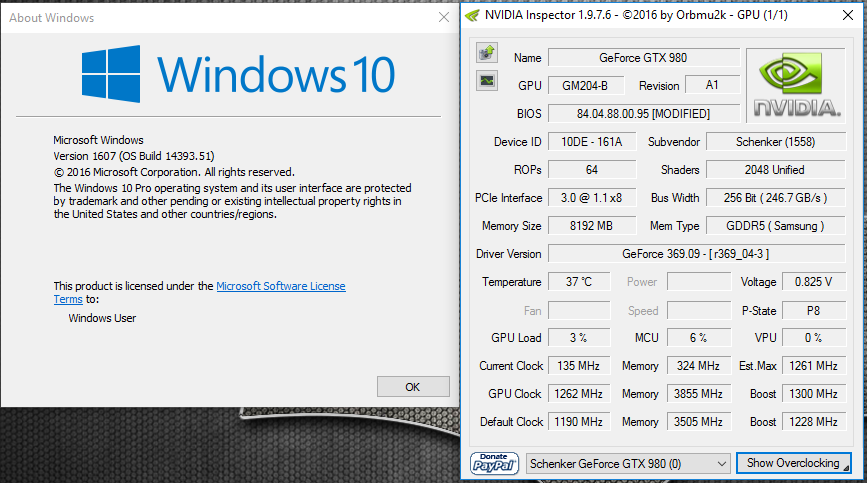

  15. That's an Inspector issue or P-States matching behavior, nothing to worry about. Flash Swick's mod (M18xR2) and follow the instructions above. @anarky321
