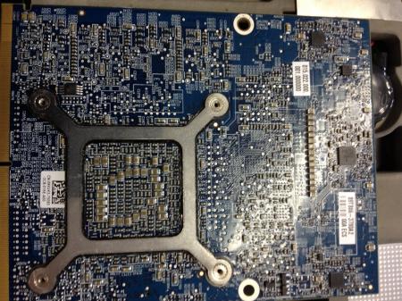

I am in office now, and can post pictures of card and some screens, Let me know if this helps, and do u think this is Dell card. BR, Ivan

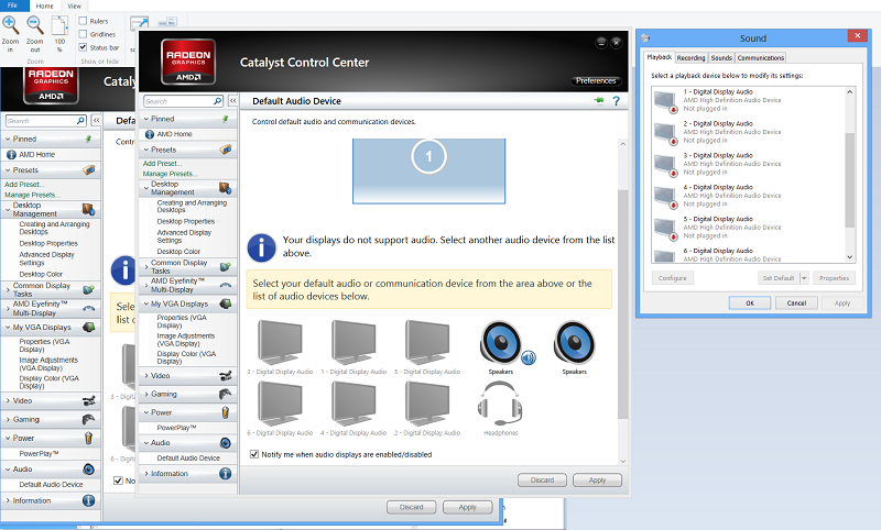

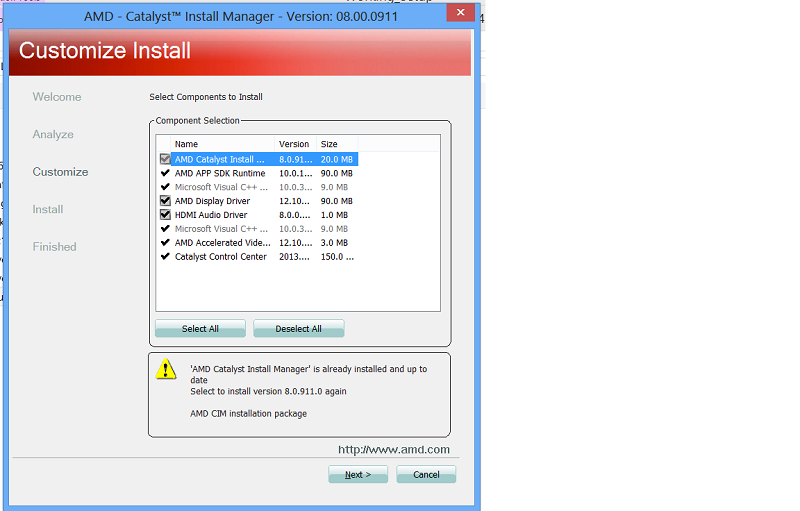

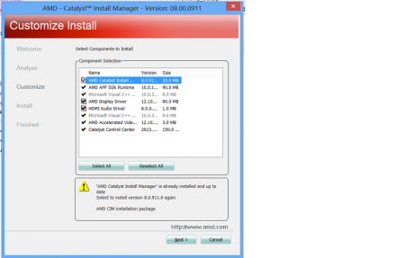

Hum, I think I see it installing hdmi audio driver, also what was interesting I see hdmi sound device 6 times , like hdmi audio 1, hdmi audio 2 etc to 6, but on all of them it say not pluged inn. Tomorow I can post screen shot maybe since now I am on my iPad..... Card is supposed to be Dell, I buy from NBR market place from same person like lordvader and seller clame it is original one, will post picture of it tomorrow as well to advise me.

Already done with clean install, but was same story, about sound I don,t think it is driver related, since it say not plugged in like it have driver but device is missing. I will try to reset bios, and will ket you know result. Btw you have 015.022 isntaled on dell card?
Hi Nylon, I think me and u stuck in this DP problem but I will go to bottom.... My card is supposed to be Dell, or at least I buy it to be Original Dell card from NBR Marketplace. Unfortunatly he is with most resent Dell Vbios 015.022. I think but I am not sure that this is root of my DP problems. Btw in my case DP not working at all not in boot not in windows. Also in windows what I see is that In sound settings it say HDMI sound not plugged in, and this sound device is found 6 times. About performance settings I installed latest beta drivers and now it work fine for now, but I still testing. One more thing I think is interesting, card seems to not go to 850/1200 at all before I installed Dell OSD driver"....... After Installed it all run flowless.
Display port not working in my case, it is original Dell but still not working. I think something is changed in 015.022 vbios. But this is just my suggestion. What is you vbios version and is it Display Port working ? I am just trying to figureout why mine and I think to few other people DP not work.

Hi I am using Belkin DP/DP cable, also my monitor is Dell U2412 with DP port. All this cable and monitor was working fine on my old HD5850, so I don;t think this is cable/monitor issue. Also what I see is that Digital Display Audio, say not plugged in which mean that system don;t detect Digital out/ DP/ HDMI interface at all. BR, Ivan
