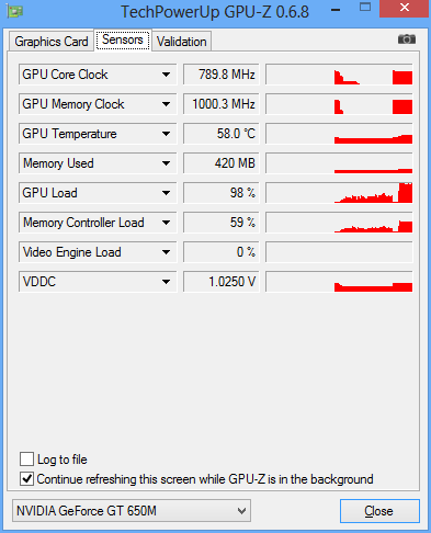

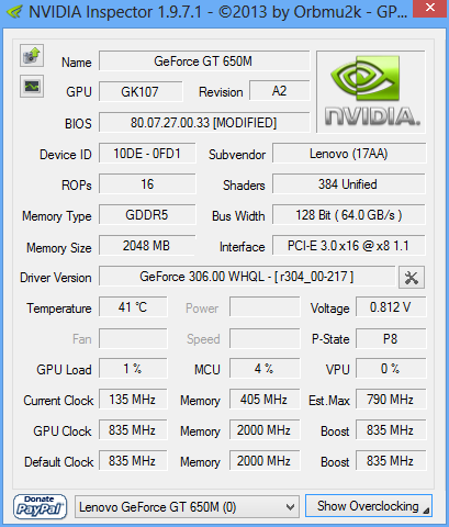

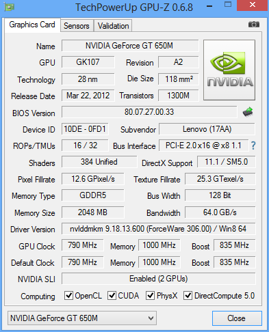

  11. What exactly was the issue with the clocks?
    After flashing the modded BIOs and vBIOS, the default core clock changed from 790 MHz to 835 MHz even though it did not actually increase. So now the number is always reported as 45 MHz higher than what it actually is. For instance, if I overclocked my core by 100 MHz to 890 MHz, GPU-Z and Nvidia Inspector will say 935 (890+45) instead. Anything that reads the core clock from the sensor, however, is still correct. This bug is present on both the internal and Ultrabay GPU.
    Before:
    After:
    However, the sensor readings are still correct:
