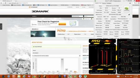

tnx for advise but i know it have been testing at different clocks. Actually i can push my mem +910 where i usually gets bsod and that result is with 830 on mem which is totally stable no flicker no bsod no speed related issue. I knu most of ppl face a problem when they r on high mem oc however mine seems to have very good factory build... however the core max out at 1160mhz for the sake of no bsodKhenglish: Just because he's got it running that fast doesn't mean it's a good thing. The faster it runs the more memory errors it hits and the slower it ultimately goes.buluunee: Try running your memory at 1200ish. At 1250 my card actually scores lower than it does at stock memory clocks, but 1200 helps quite a bit.
this is my max point and beyond this one i get bsod and temps max out at 75C
NVIDIA GeForce GTX 675MX video card benchmark result - Intel Core i7-3630QM Processor,Micro-Star International Co., Ltd. MS-1762 score: P6702 3DMarks here is my score

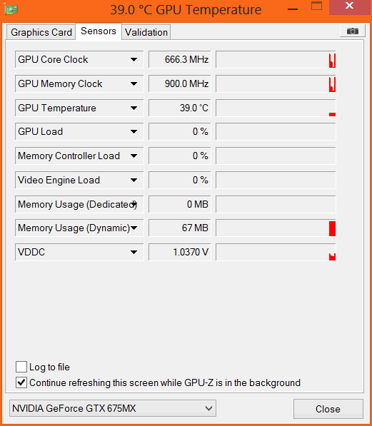

@svl7 so i am sitting on 1030 max voltage or something else? coz seeing those gtx 680m vbios from the second post which are O,volted at 1050 or 1000 etc.@svl7 here it is: GoGo Share and my current voltage which i see from gpu-z is 1.0370 that means i am sitting on V1030? or something else?- - - Updated - - -
[ATTACH=CONFIG]6823[/ATTACH] here is the gpu z ss

@svl7 here it is: GoGo Share and my current voltage which i see from gpu-z is 1.0370 that means i am sitting on V1030? or something else?Can you send it to me again? I lost the original.- - - Updated - - -

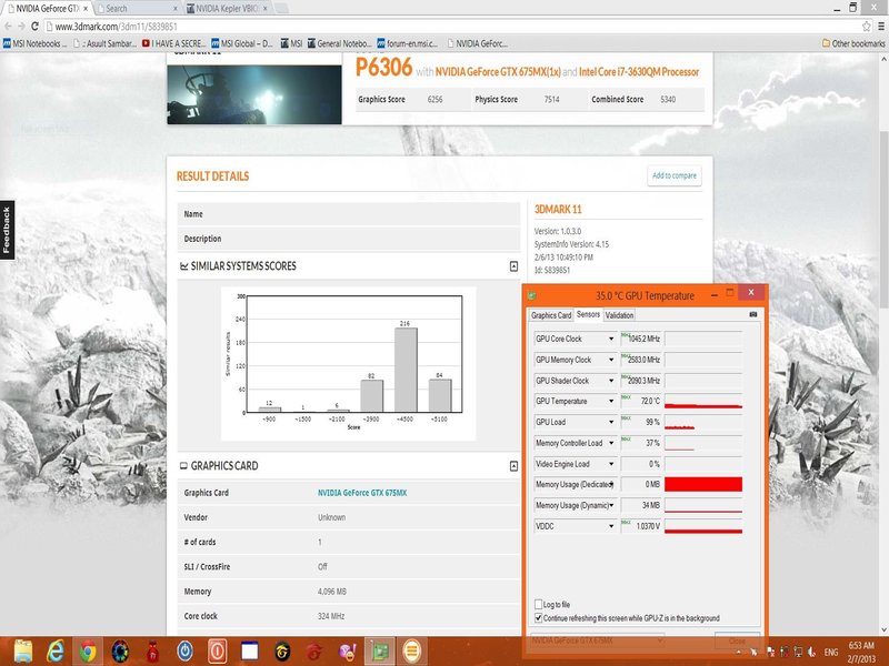

okay here is the first benchmark with unlocked vbios modded by svl7 on gtx 675mx
stock voltage max 1.037
390mhz + on the core
780mhz +on the mem
max temp is 72C
kombustor Test pass!
seems stable with the first glims
edit: pic was too small so uploaded onto share site http://postimage.org/image/i8gjuo7tz/full/ and http://www.3dmark.com/3dm11/5839851
