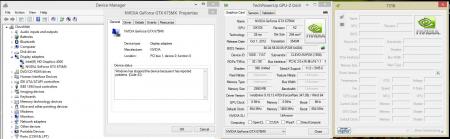

RIp my poor GTX675MX, you were so kind to me with your locked bios chip that I had to source spares and a programmer, flash a new chip and perform open vbios transplant surgery so I could clock past 823Mhz. Good thing I had a rework station already. Anyway from what I can tell it seems that one of the ram chips has died a horrific death (maybe), I can still flash/read/change the bios etc so its not that. Was running at ~1130GPU and 1230(4920DDR) on the ram, pushing for higher without thermal throttling in kombuster when everything crashed and upon restart I'm left with this. Now go to hell you dam 675mx that required surgery to flash you vbios, I was looking for an excuse to upgrade to a 970/80M anyway so here it is. However in the meantime(until prema gets these bios mods done) it surely will be missed.
