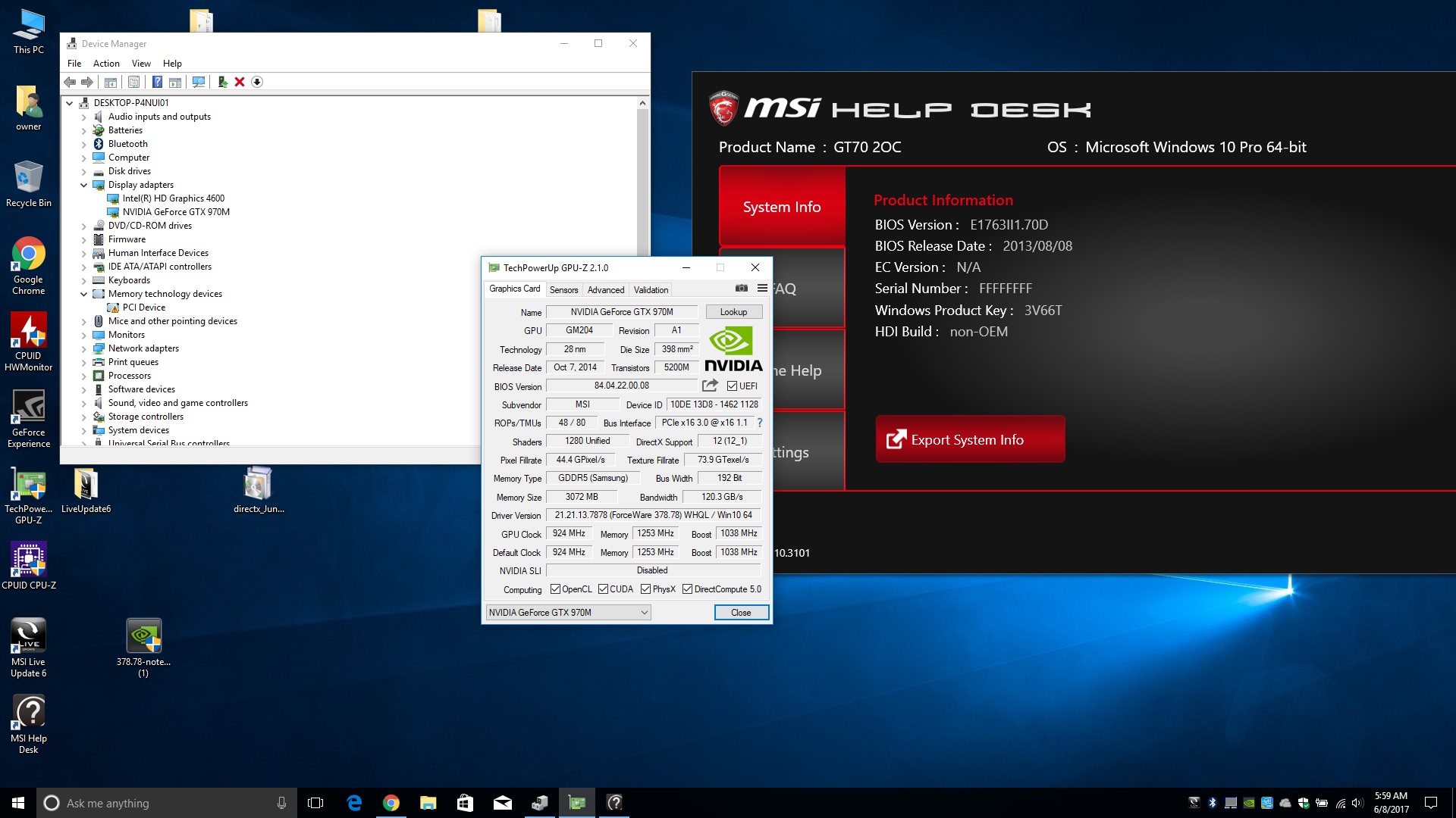

  1. I will be selling it shortly i managed to get the 970m to work. had to update bios
  2. Ok so i successfully installed a GTX 970m instead of my GTX 770m into my GT70 barebones (ibuypower cz27) Its registered under device manager and i have nvidia control panel and i can view the cards temperature. However i cannot use the graphics card with anything, it only uses the intel graphics. i have a haswell system and the card came from a GT72 so the vbios is correct. I cannot update my bios on the motherboard thanks to ibuypower not supporting update (terrible company) Does anyone know what to do? i apparently do not need a modified driver since it installed just fine.
  3. Thank you, I did end up buying one however it installed the drivers for it but i cannot get it to do any 3D tasks in windows. i can get a temperature report and see it in device manager but i cannot select it for any games.
