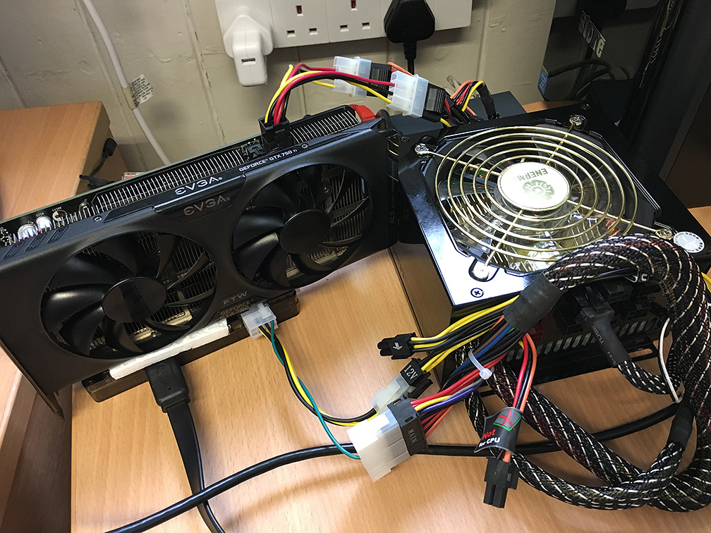

  5. I have a Enermax 500 watt modular PSU. The card is powered through the 8-pin connector that connects to the 24-pin (motherboard) and 4-pin (CPU) cables on the PSU. There is also additional power to the card using a dual molex to 8 pin cable. Here's a picture of my setup at the moment. It should have all the power it needs...
  6. Nice to hear it's working for you. I wish it was for me! I have a Lenovo T530 (i5-3320M, 16GB RAM) and the EXP GDC v8 ExpressCard adapter and I can't run a 3d benchmark test without the eGPU turning off immediately. I have Setup 1.30 that performs a DSDT substitution and that works with no problems, but it seems when I run anything remotely graphically intensive it turns itself off.
  7. Hello guys, I’m stuck on an issue and I don’t know how to resolve it and I'm so close to getting it working! Some background info: Windows 10 Lenovo T530 16GB RAM EXP GDC V8 Adapter Intel i5-3320M @ 2.6GHz TOLUD = 3.49GB NVidia GTX750 Ti FTW GPU iGPU Intel HD4000 Enermax ELT500AWT (500 watt) PSU I’ve got an EXP GDC V8 adapter that plugs into my laptop via the ExpressCard slot. I bought the eGPU Setup 1.30 as my laptop has more than 3GB of RAM and I didn’t want to take it all out. I’ve managed to successfully (after many hours!) create an AML file so that I can perform a DSDT substitution using Setup 1.30. That all works fine and I get the large memory appear in Device Manager and my system boots fine without the BSOD. I install the latest drivers for my card and disable my internal screen and have only my external on. I’m trying to play 7 Days to Die – it loads fine and I can start a game and then 5 seconds later…The eGPU turns off and my internal display turns on and it’s just running the iGPU. I’m using 36-bit compaction on both iGPU + eGPU with chainloader is set to 'mbr' and I don't get any errors in the Device Manager. Am I doing something wrong? I’m pretty much just doing trial and error with the configuration in eGPU 1.30. Here's my setup currently: Regards, gooch
