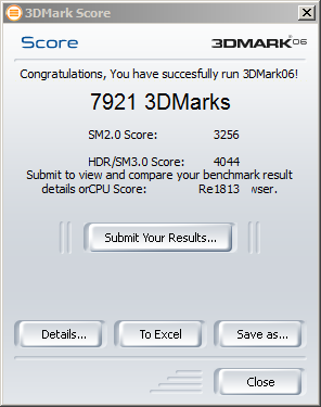

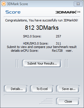

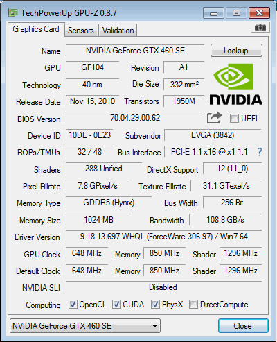

Finally, the Windows part of my project is completed... Win 7 64 bit 6 GB RAM DDR2 Pentium Dual-Core T4300 @ 2.10Ghz Intel 4500MHD Evga GTX 460 SE EXP GDC Beast v8.3 EC1 Dell DA-2 Python with Theano on GPU (Cuda 5.0) Benchmarked with 3dmak06, almost 10x the old score! Now I'll try to my luck with CUDA on Linux Min 17.3 -

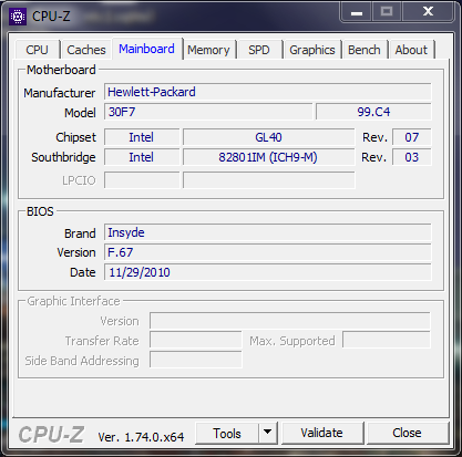

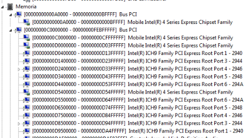

Based on what you guys have posted here, I found my system's TOLUD size is 3GB, so it seems i won't need to perform a PCI "All" compaction. Ideally I would aim for an Optimus x1.Opt implementation in order to use the Internal LCD for display purposes. Some specs for the chipset I am dealing with: Intel ® 82801IB ICH9, ICH9 Mobile Base PCI Express* Interface The ICH9 provides up to 6 PCI Express Root Ports, supporting the PCI Express Base Specification, Revision 1.1. Each Root Port supports 2.5 GB/s bandwidth in each direction (5 GB/s concurrent). PCI Express Root Ports 1-4 can be statically configured as four x1 Ports or ganged together to form one x4 port. Ports 5 and 6 can only be used as two x1 ports. On Mobile platforms, PCI Express Ports 1-4 can also be configured as one x2 port (using ports 1 and 2) with ports 3 and 4 configured as x1 ports. I booted into windows 7 to check first PCI address... -

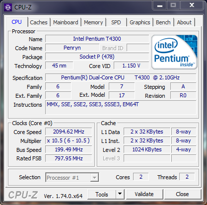

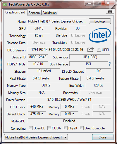

Hi guys, I have been following your friendly and helpful community for some time and after reading lots of success stories I decided to jump into this eGPU world! So I am looking for your guidance/comments/tips. My current laptop is an old HP DV4 1523la with an Intel Pentium Dual-Core T4300 @ 2.10 Ghz processor, 6GB DDR3 800Mhz, integrated Intel GMA 4500M. I am considering the Express Card version of EXP GDC v8.0 and an Asus GT-740 OC 1GB GDDR5. I am a Linux user and a very occasional FPS gamer (Nexuiz and Xonotic). My main interest in this project is to provide this laptop with entry level CUDA capabilities with the least investment possible. As such I would not mind just using the card as a processing unit but if a successful implementation has the added benefit of enjoying my favoured games with high frame-rate and visual settings, it would be AWESOME! So in your experience guys, what do you think? Does my project seems promising or most likely to be a complete failure? Cheers!
