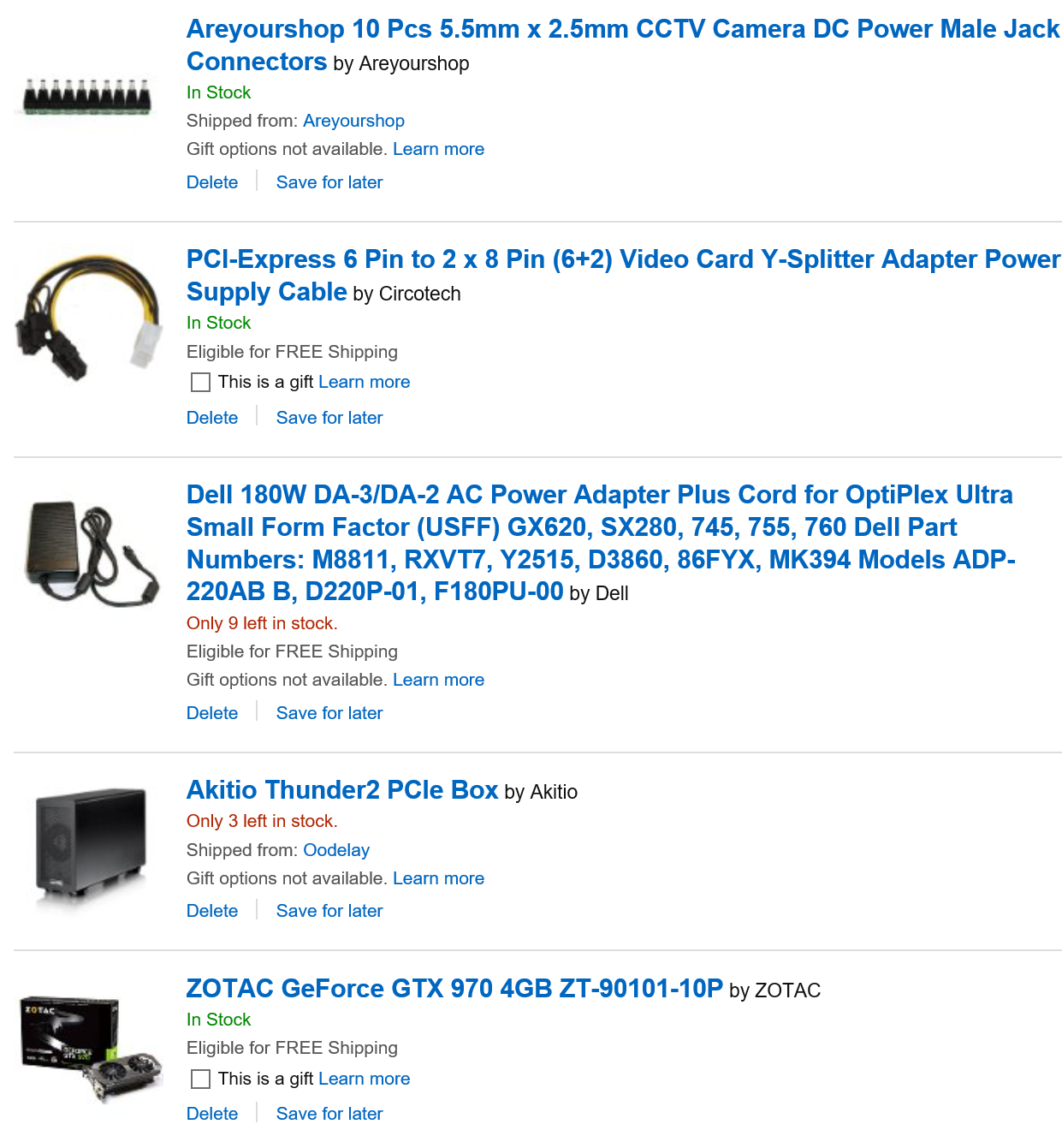

  8. Thanks so much. I was using your completely closed guide to start and I keep re-reading that DA-2 power adapter post and looking at my parts list. I'm just a very visual person and it would help to have an annotated picture of a the popular GTX 970 MBPro complete build, closed case, DA-2 power, and cable list. Best I could find is this picture (which isn't a closed unit, but I understand that is just a space issue from Graphics card choice): Here is my parts list so far: It looks like I need to add the 8-pin PCIe extension female to male, and I don't need two of the y splitters? Thanks so much for any further guidance! Maybe I'll create that screenshot with arrows and wiring when I build if it will help anyone.
