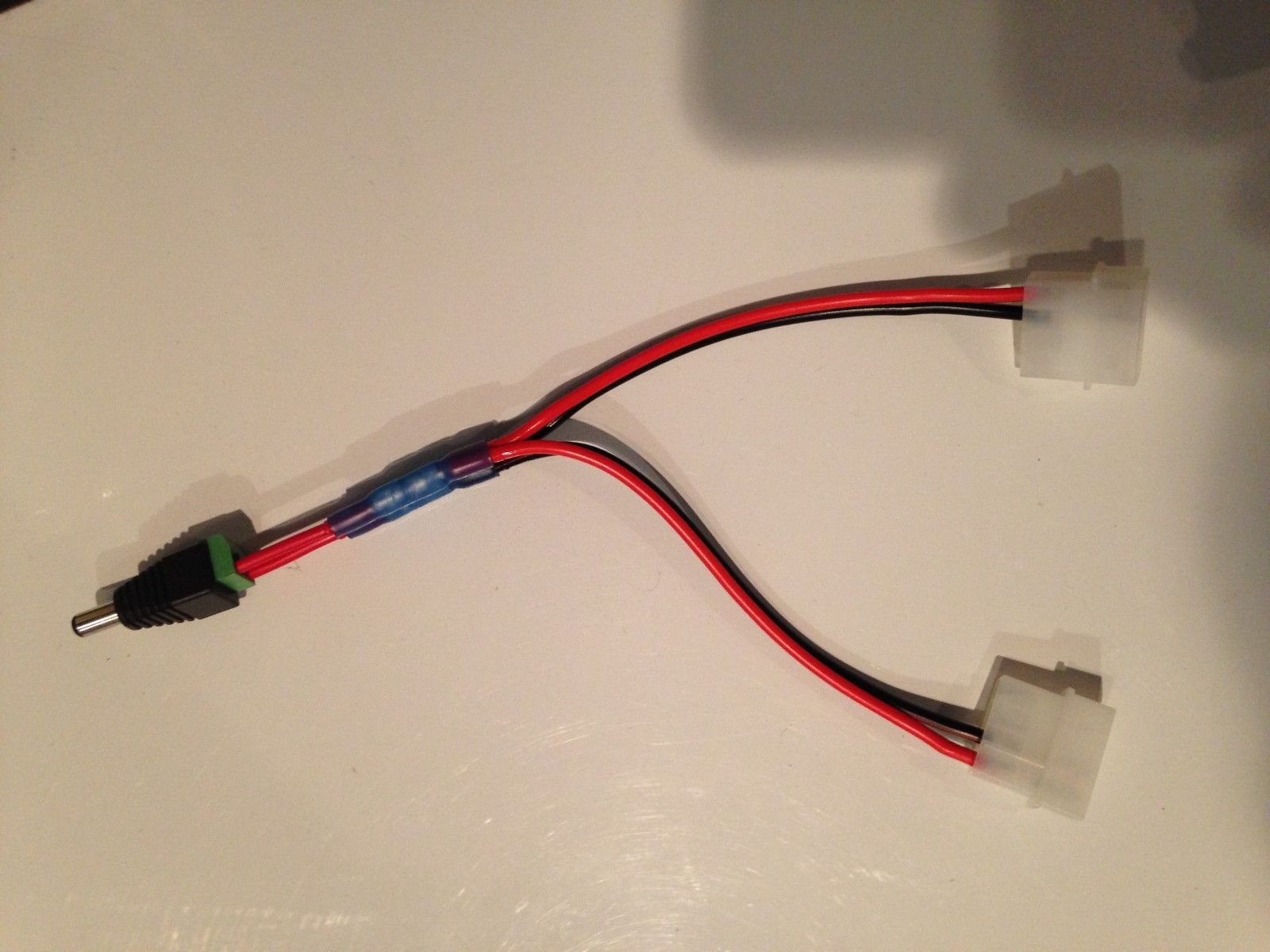

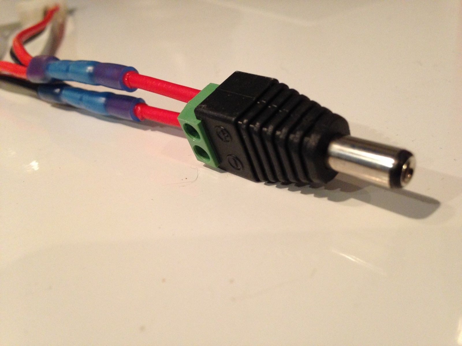

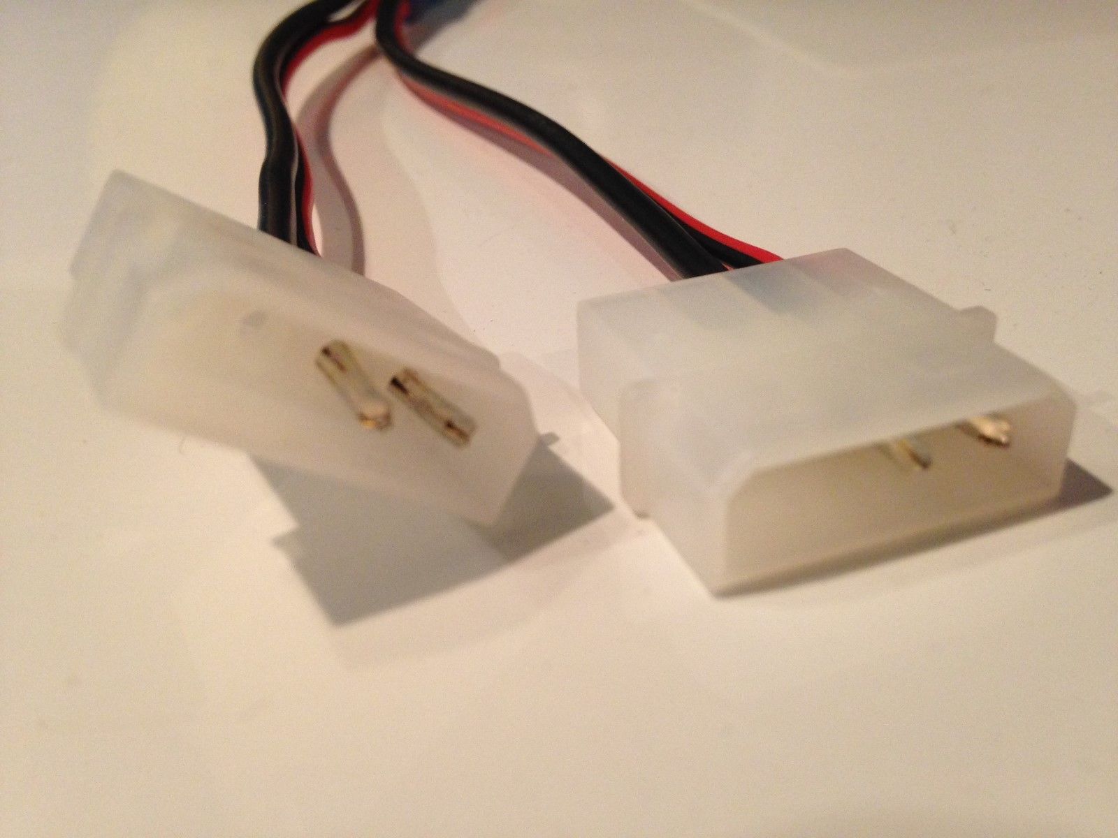

Hey if this helps I had a conversation with scryptminer64 on ebay and asked him to make me a '2 x molex to 12v 5.5mm x 2.5mm DC barrel plug': http://www.ebay.com/itm/-/262278312736? He said he'll make more for anyone who needs it, just incase your squeamish about making wires, like myself. -

@Dschijn reading through this thread I think i might need the 2 x molex mod. I ran a Heavenly benchmark and the fan on the GPU really picked up during the end of it. Right after it finished the computer cut off with a kernel error. That could mean the Akitio isn't getting suffient power from my setup under heavy use correct? Think this'll do it? http://www.ebay.com/itm/381122883263?ssPageName=STRK:MESINDXX:IT&_trksid=p3984.m1436.l2649&afsrc=1&rmvSB=true http://www.ebay.com/itm/2x-5-5X2-5mm-CCTV-Video-DC-Power-Plug-Terminals-Connector-Adapter-Power-99-Good/171633620159?_trksid=p2045573.c100033.m2042&_trkparms=aid%3D111001%26algo%3DREC.SEED%26ao%3D1%26asc%3D20131017132637%26meid%3D1b2eb55e69f2483eb8964c2c9c56a883%26pid%3D100033%26rk%3D2%26rkt%3D4%26sd%3D321110117729 -
