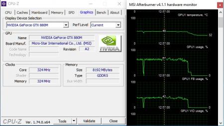

  9. Here is a quick picture of temps here. Idle always is 27C (which i am proud of!) Load was used on Skyrim @1920x1200 all settings ULTRA with AA@8x and AF@16X and FXAA enabled. Mouse cursor shows temps at that current time. I would use Furmark if it didn't decide to start crashing on me after the win10 update. ;-; If you want me to use a specific program for benching/stress temp then feel free to tell me!

  14. I am working on a MSI GT60-0nc. I have a 300watt power brick for this thing just in case i decide to go insane with mods. I7 (i will get model when i am back home, i upgraded this so it isn't stock) 16gb ddr3 1600mhz ram 880m 8gb msi with watercooling 500gb samsung evo pro ssd. I will literally even buy a whole new system just to run this card if the motherboard tries to get in my way of massively OC'ing this card.
  15. I made a topic in the wrong section, so just look at my account and choose the only other topic (not regular to these forums) In a nutshell, i successfully installed a liquid cooling system to my 880m sitting in a MSI GT60-0NC. I know these cards are notorious for overheating and not getting the performance it can put out. This is where my project comes into play. I just got the modded vBIOS for the card, and was wondering who all wanted in on the project and give advice to push this card to its absolute limits!! Temps without modded vBIOS IDLE:27c LOAD:42C-48C (4hr gpu stress) I work 8-5 central time so i might not reply soon but rest assured i will check regularly! Thanks!
