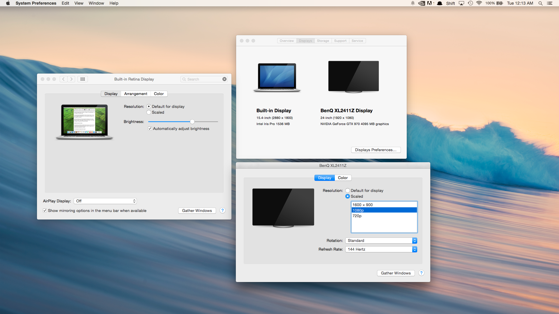

  7. So I took a look running a few games on the OSX side and found that unless I make my external monitor my "main monitor" it will be opening them on the internal screen running with the Intel Iris Pro. As soon as I set my external monitor to the main monitor in the displays tab "about this mac" it now has both monitors coming up as my gtx970. Unfortunately, mine does not revert back to the iGPU when I adjust settings, so I can't really comment on that :/. If you are simply trying to "turn off" the internal screen all you have to do is turn your brightness to 0 and your internal screen is off.
  8. For me I just assumed that was supposed to happen? Your internal screen would be running using Intel Iris Pro and then the external monitor would be entirely by the eGPU so as to not be losing performance due to what is going on, on your internal screen. At least, that I assumed to be happening and what happens when I am on Windows 8.1. I didn't do any benchmarks yesterday so I couldn't say for sure if running anything will it to revert to the iGPU.

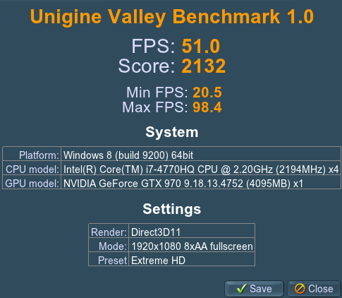

  19. This is what I got for Unigine Valley, no OC:

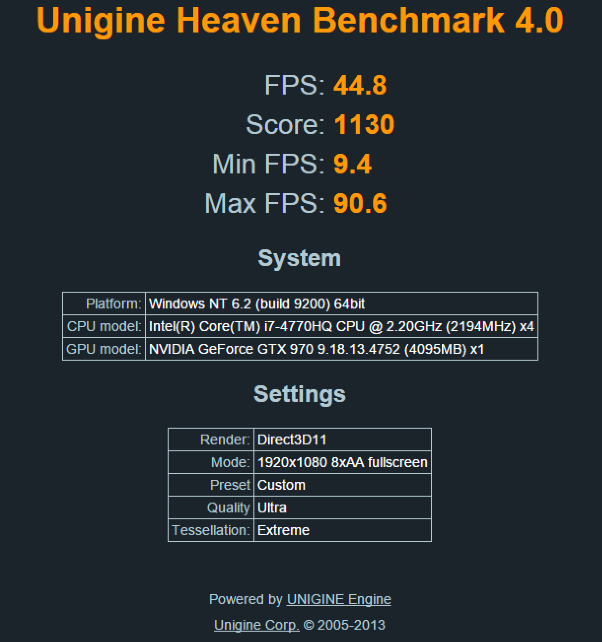

  20. Thanks @Dschijn, I hadn't looked far enough ahead to realize what I needed to get everything in the enclosure. I'm sure I had read the 90 degree riser but I had no idea why until I realized the powered molex riser would not bend enough to fit. For now I have the GPU sitting on its back inside the case and the PCI-e board is attached outside of the case. But I have been running some benchmarks and I don't know if mine seem a bit low for a 970.... In your old guide did you already overclock when you ran your benchmarks? For 3DMark Firestrike I only got a 8514. For Unigine Heaven 4.0: And if ASIC scores mean anything (probably not) I have a 68.8%.
