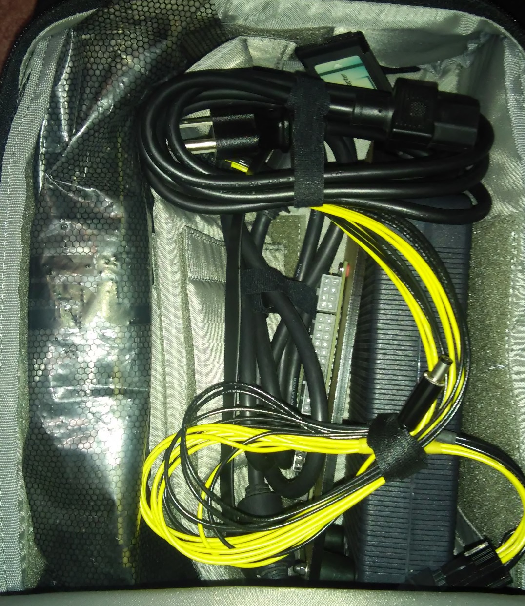

Hardware Dell Latitude E5420 i7-2670QM + Windows 8.1/10 + 16GB RAM GTX 980 PE4C v 2.1a Dell DA-2 PSU Cheap camera bag I got to fit it all in SETUP a) While waiting for your stuff to arrive, check your BIOS version. Later BIOS versions use gen1 link speed, while earlier ones use gen2. I use A02 on mine. Perform a DSDT override to prevent error 12. 1) Boot into Windows with the eGPU unplugged. (If the BIOS detects the eGPU, it will only output video through it, disabling the internal LCD) 2) Once into Windows, plug in the eGPU and see if it is properly detected by Windows a) Open the device manager If the eGPU is not under display adapters or has error 43, unplug the eGPU wait 1 second and plug it in again. If you hotplug too quickly, the fan goes to 100% and it doesn't work. c) Repeat until the eGPU is showing up under display adapters without error 43. 3) Install the latest drivers 4) Once the drivers are done installing, turn off your laptop, unplug the eGPU and turn it on again. This is to prevent the BIOS from detecting the eGPU. 5) Once into Windows, plug in the eGPU until it is detected. Troubleshooting error 12 Perform a DSDT override error 43 Unplug the eGPU and plug it in again until the error goes away. Wait 1 second after unplugging it, or the fan might go to 100%. No internal display Plug a display into the eGPU to see if it is outputting a signal. The BIOS disables the internal display if it detects an eGPU at boot. Only runs at gen1 speed Flash an earlier BIOS version, the later ones default the eGPU to gen1 Works at gen1 but not gen2 This is either a problem with the adapter or GPU. In my case, my gts 570 didn't work, but my 980 did Results
