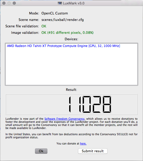

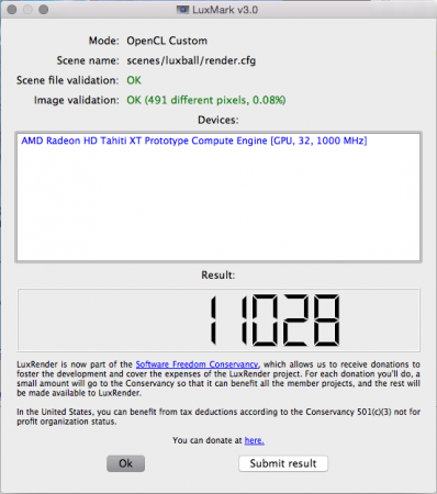

The GPU chewed through the polished ball LuxMark without any issues. Don't know how the score compares, other than that the 7970 got 10 times as many rays/second as my 6750m. Sweet. -
