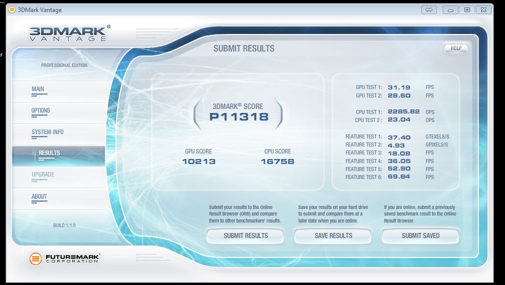

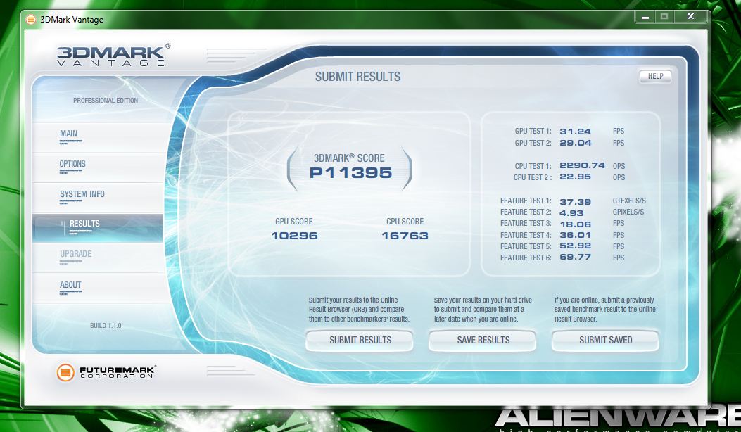

Link to log is below, I grabbed it during a vantage run - driver version is 301.42 thanks for the help
Something is definitely up, this is the score @widezu69 put in the charts -
http://forum.techinferno.com/attachments/alienware-m17x/2370d1316477565-capture.jpg
Given your better CPU score, you should have been lineball or slightly ahead.
anyone out there in T|I land care to lend a hand resolving this I'm assuming drivers is as good a place as any to start?
Recently grabbed this benchmark on my system...upgraded to the GTX580m and so far I am beyond unhappy with the performance gains over the 560m, does this seem right? I have overclocked as far as I can go and even used the modified VBIOS to eliminate the notorious throttling issue but still just feel disappointed - feedback is appreciated.
Still no Joy on this...very disappointing results from this upgrade, anyone have some scores or benchmarks so I can see what the card averages ?
