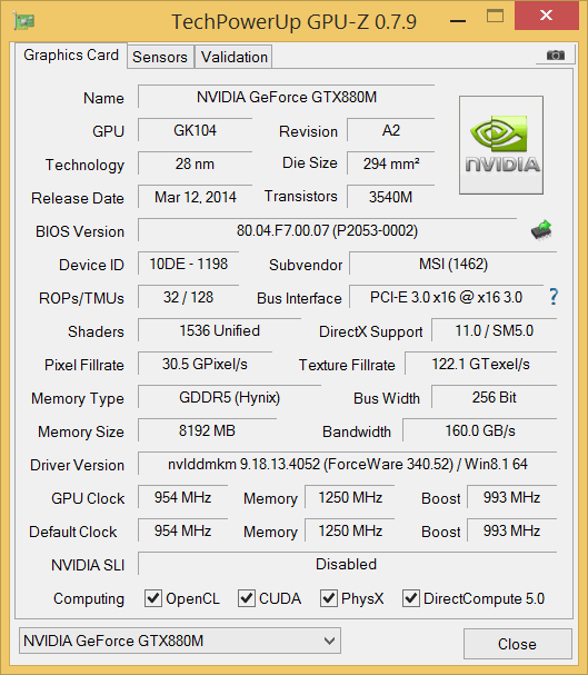

  3. So... a few hours ago I tried to flash the modded vBios for my 800m - I had to use "nvflash -4 -5 -6 *.rom", because there was a mismatch in device IDs. Afterwards I rebooted and Windows didn't recognize my card Was just listed as some sort of general video card and I also couldn't install drivers or read it out properly in GPU-Z (clock rates were at 0 Mhz). Then I had to reflash the stock vbios - I tried the process two times, but there was the same issue.... Do you have any suggestions for me? Below you'll find a GPU-Z screen of my GPU at the stock vbios.
