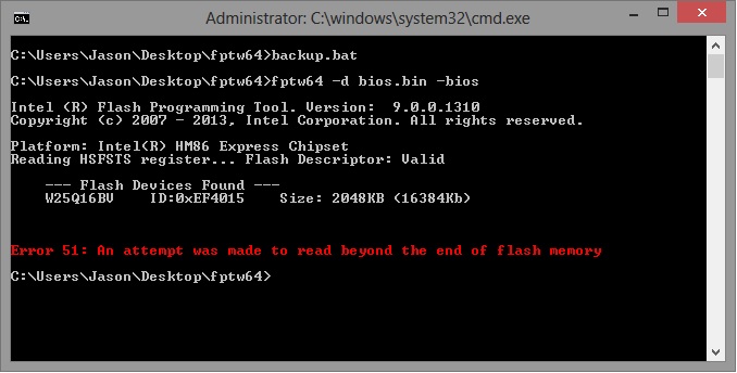

I've tried that. I get "Error 51: An attempt was made to read beyond the end of flash memory".

Using the either of the above 104 fix fparts... "Error 51: An attempt was made to read beyond the end of flash memory".

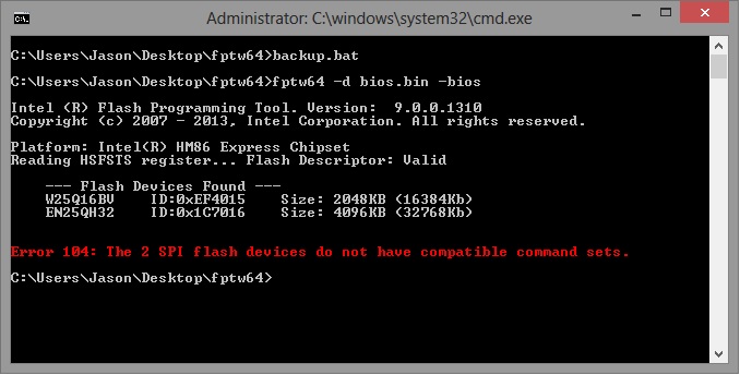

I've downloaded and flashed the stock Lenovo 3.05 bios, downloaded FPTW64, and run it from an Admin command prompt. It returns "Error 104: The 2 SPI flash devices do not have compatible command sets."
I've since flashed to the stock Lenovo 2.07 bios and tried to make a backup of that. I get the exact same error. I've attached a sccreengrab of the error.

Let me know if it works, I get a 104 error.
I've flashed the stock 3.05 bios from the OP, and I'm trying to make a backup using the backup.bat from step 2. I did launch it from an elevated cmd prompt, but I'm getting error:
