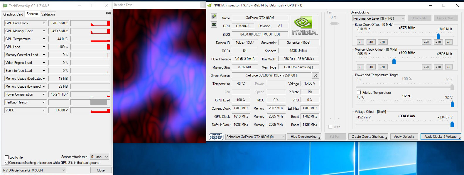

i d also like to give my 980m some more volts than the usual 137.5 temp wise it can handle a lot more as is normally use 137 only for benchmarking is a completely new prema vbios needed or just some minor tweeks?
also it would be very great to have the possibility of undervolting und the lower states as my 980m never shuts off in the pm clevo and i guess for lots of other guys it woul also be a benefit als in the other clevo models the gpu isn t shut off anyways
Try setting it back to adaptive mode then restart the laptop. This should give you back the lower power and volts when nothing is going on.

Will send you the 1.4v later today:
