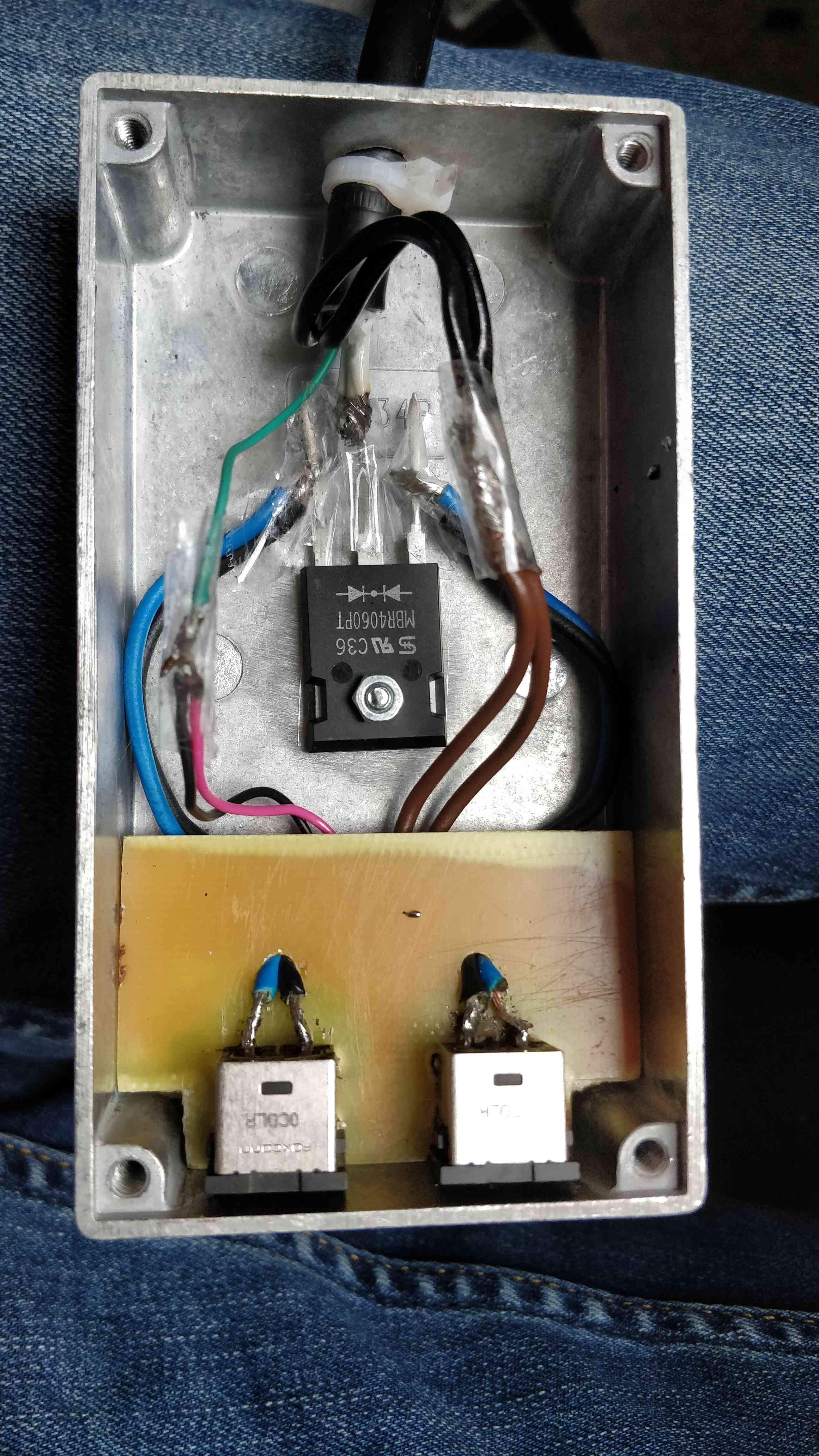

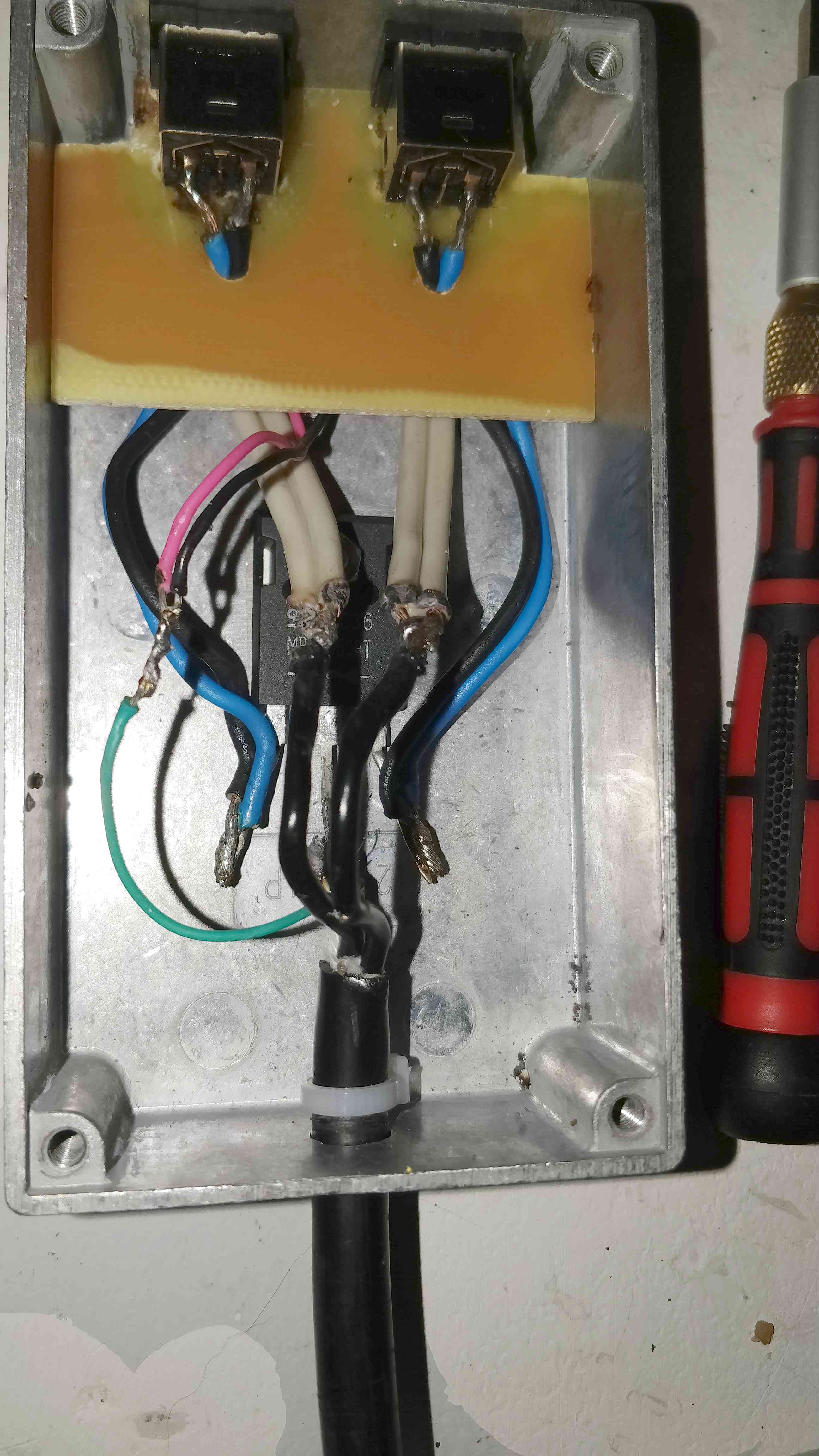

What exactly does the diodes do? Also can you make a simple schematic how you connect them?

And now, out of nowhere the problem is back. I just disconnected everything to move it to a different table so I could clean everything. When finished I turned everything on and boom! Not working!!! I think I just give up... To troubleshoot what can be the problem will probably cost too much money and effort. It can be the rectifier, it can be the inputs, it can be the cables, it can be one of the PSUs or it could be both, it can be the motherboard. The only thing that would be nice, is if someone could make a very cheap adapter, that is tested and working 100% and let me borrow it to see if it is just my build that is the problem.

That looks very professional! At the moment it seems to still be working. Also I am still using my rectifier so it seems like the whole problem was the cables. Today I will try isolate the cables inside my adapter, screw everything together, close it up and call it finished. I am excited to try reinstall windows 10 again. I am pretty sure it will work with the mod. Also I have start making some driver comparison, because I saw a video with Linudtechtips were the tested many drivers to see if Nvidia cripples their GPUs. Their conclusion is no. But they only tested desktop GPU. Laptop GPUs get crippled like hell by Nvidia!!! I already tried the latest driver from Nvidia and compared to 388. It drops around 10 FPS in SLI, and with a single card it drops 20 FPS because it starts throttling. 388 and 383 modified runs flawlessly!

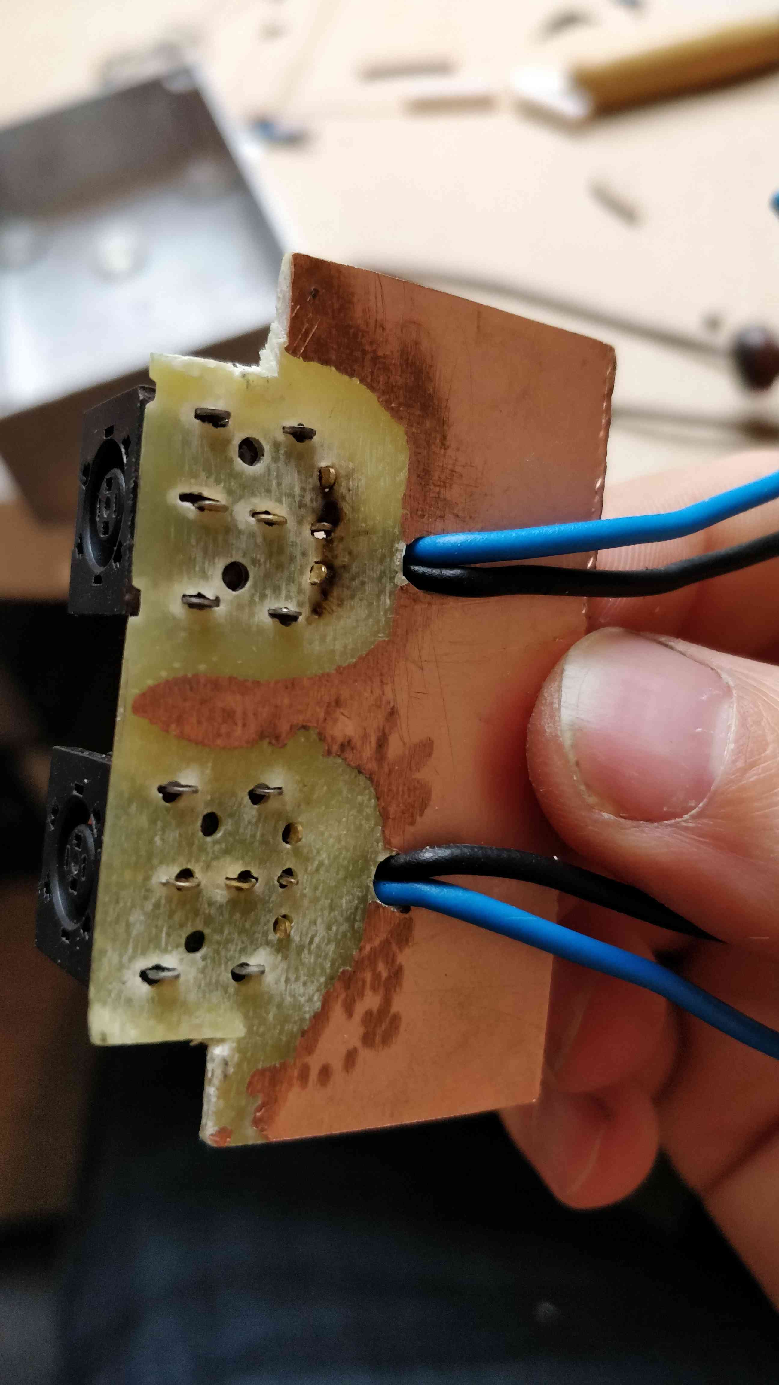

Okay finally, I think I managed to get it to work. To understand what did I need to make some things clear. I have 3 PSUs Two model XM3C3 One model Y90RR The difference is the cables: XM3C3 is having a thick cable with 2 white (+) wires, 2 black (-) wires and 1 green ID wire. Y90RR is having a thin cable with 1 white (+), 1 black (-) and 1 green ID wire. To connect the adaptor to the Alienware I used the cable from a XM3C3. That means I used a XM3C3 PSU and a Y90RR to power everything. Later I tried connecting 2 XM3C3 PSUs, but because I used the cable from the first XM3C3 to connect the adaptor to the alienware, I stole the cable from the Y90RR and connected it to the XM3C3. I was still having problems. What I did to make it work was using the Y90RR cable to connect the adaptor to the alienware instead of the XM3C3 cable. So now I am using 2 pure XM3C3 PSUs to power everything. Also I made sure everything had big surfaces to solder together. I keep my fingers crossed.

Okay I have now completely disconnected the rectifier and soldered all the positive cables together. The problem is still there!!! OMG I AM GETTING FURIOUS!!! WHY IS IT NOT WORKING????? Also I am very confused because I unplugged one PSU the system will shut down under having heavy load, so it is kind of working.
Okay I resoldered everything. But the problem seems to be back. I tried measuring the voltage while the computer was running benchmarks. The output voltage from the rectifier shows between 18,95 volts and 19 volts. The input to the rectifier showed 19,44 volt on both PSU.

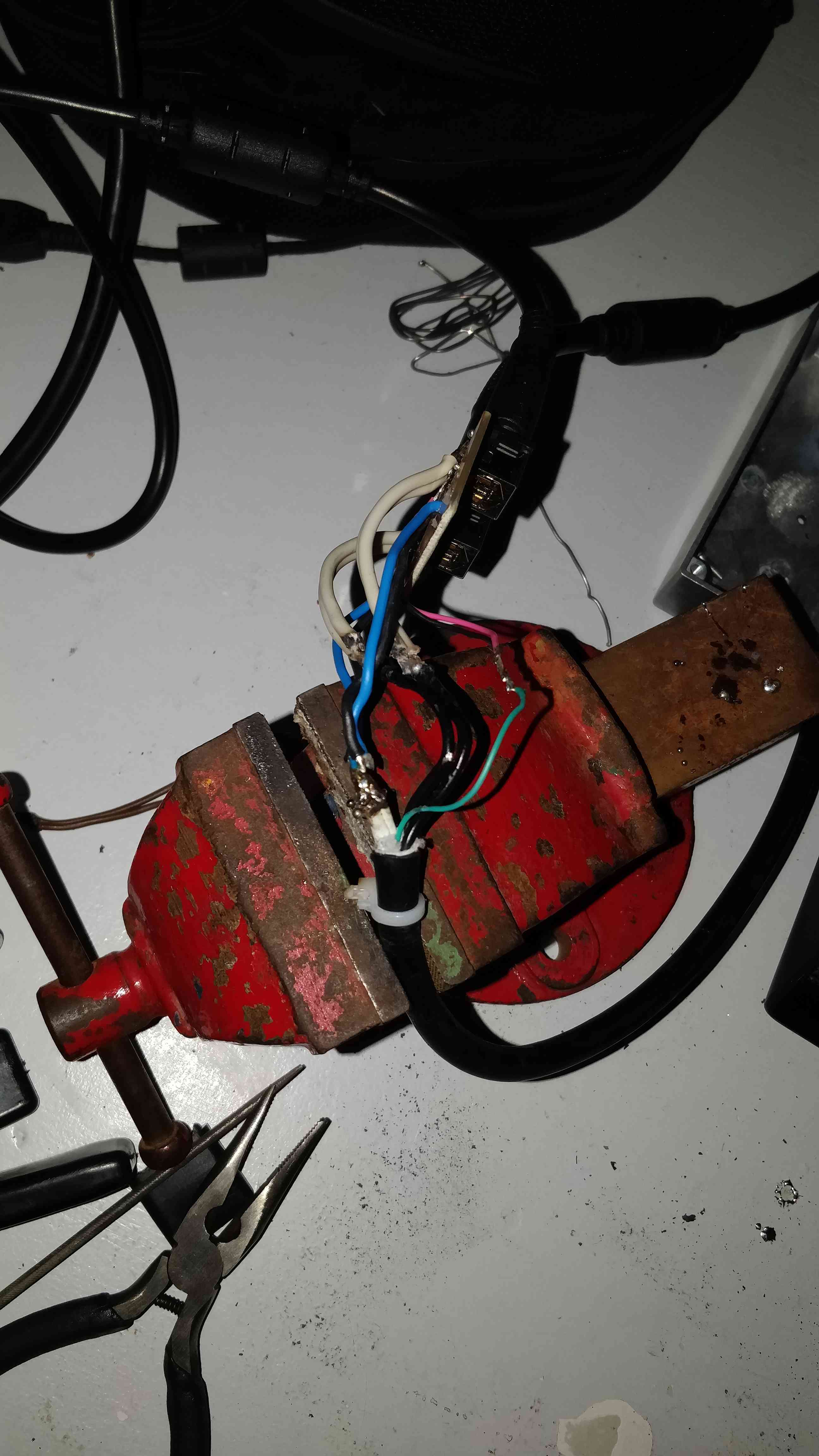

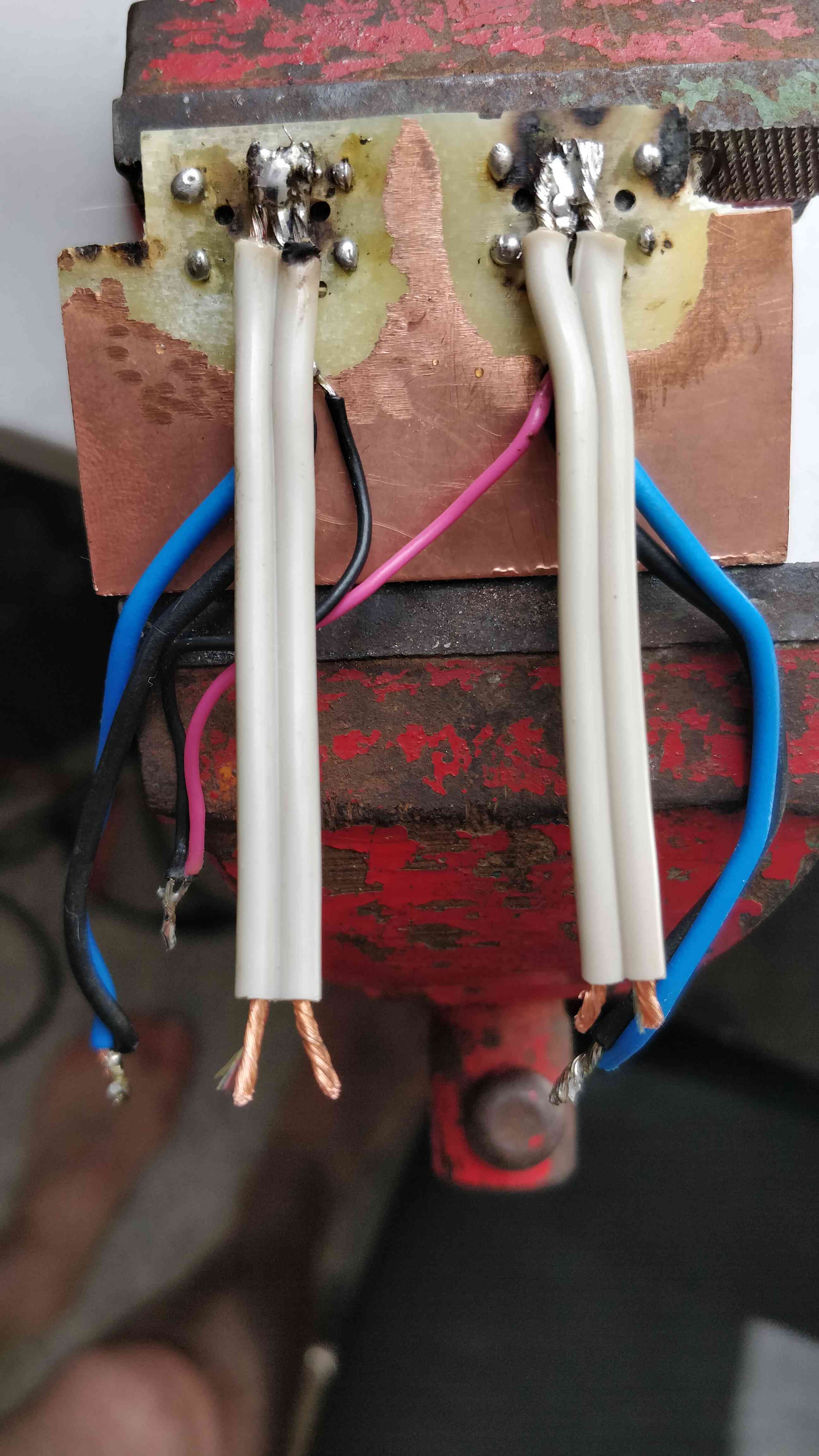

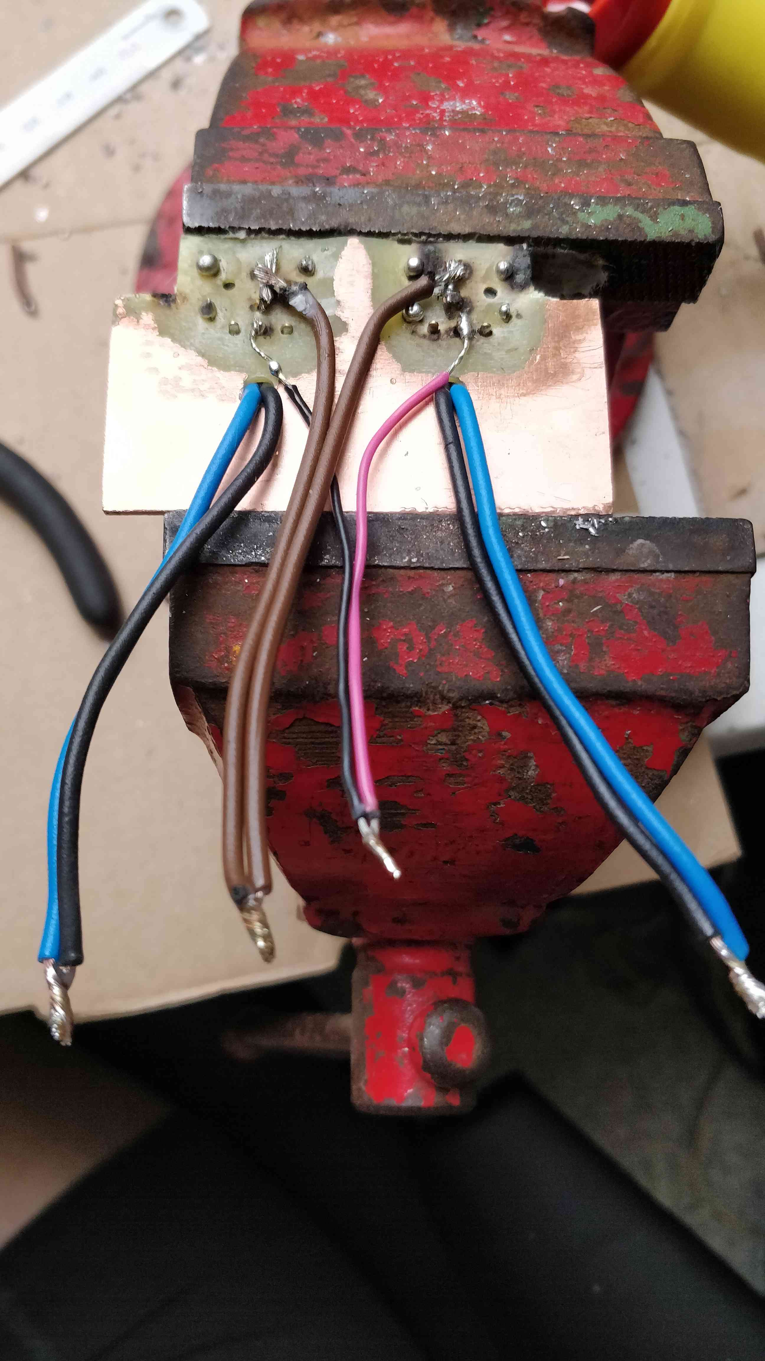

Okay just for the curiosity, I soldered a third PSU directly to the output of the rectifier. A ran some benchmark That will be nice with some photos. English isn't my normal language, so when it starts getting very technical, I really need to put some effort understanding the meaning. The first part about the cables. You mean blue and black cable right? For my understanding you mean it is ok to have 4 positive cables like I have, but I need 4 negative as well instead of 2? About the PSU light. If I connect the positive cable from PSU A to the positive cable from PSU B directly without any diode, lights on both PSU will come on, even if I only plug one PSU to the wall. Is this dangerous to do in the long run? I can assure you my diode is not busted, because the light only comes on for the PSU plugged to the wall. At the moment my setup is still working, I start to suspect more and more it is system related. I will not touch anything for a while, and if it continues working I will try update drivers and running updates but keep testing for each change. Hopefully I can find the source to the problem. Maybe it is the same problem with the Alienware 18 R3?

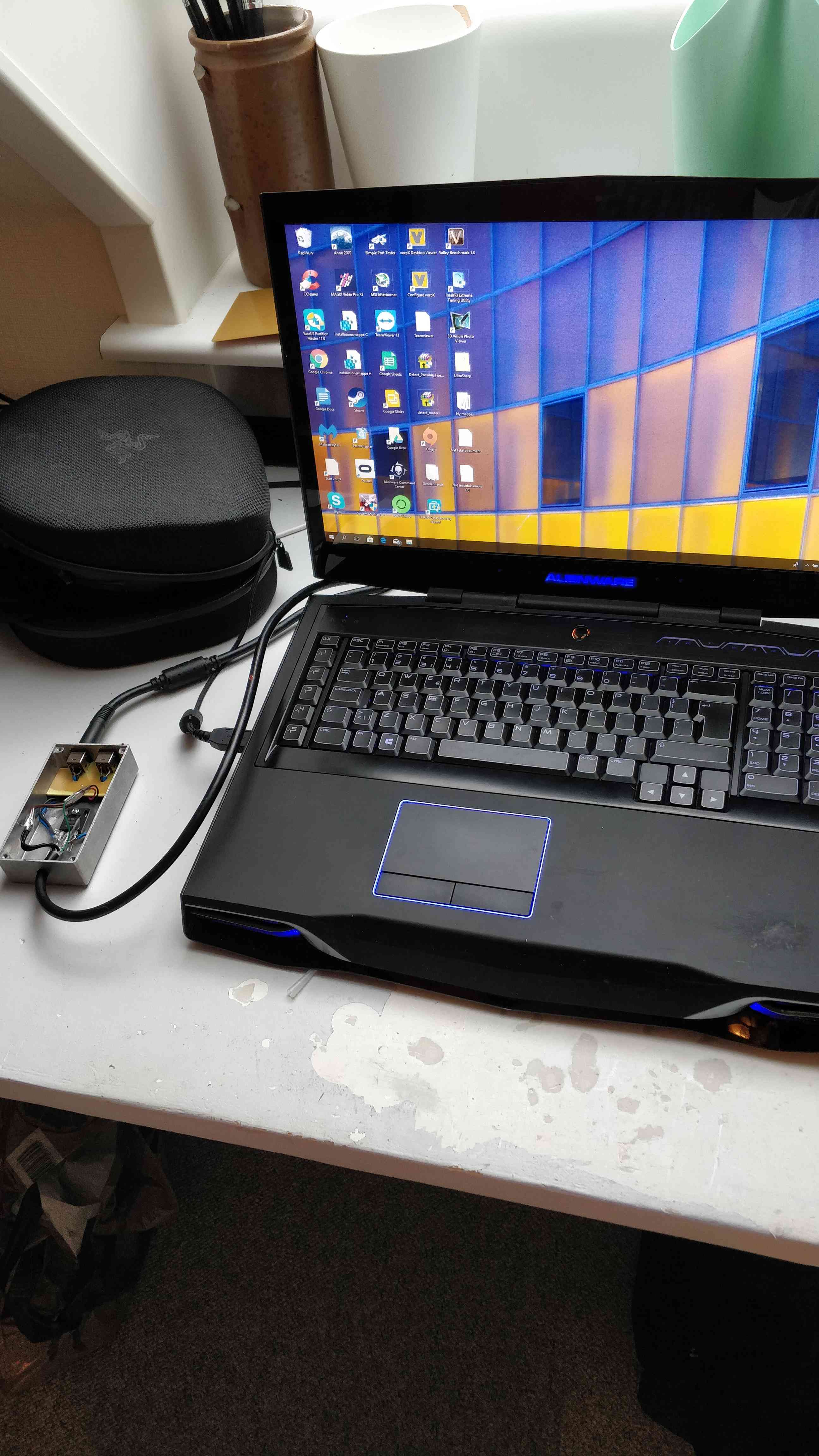

Thanks for answering, I found the solution!!! First I will describe my setup and then what I did to make it work. Alienware m18x R2 Windows 10 pro 64bit Swicks A11 unlocked bios Gtx 980m SLI I7 2960xm 2.9 ghz 16gb 1600 MHz ram It is water cooled, look at my thread here: In my dual power adapter I used this bridge rectifier with 40A and 60volt https://www.mouser.dk/ProductDetail/ON-Semiconductor-Fairchild/MBR4060PT?qs=3csLVnQQLU29uwhOO580Zw== Everything is soldered and the output shows 19,5 volt. First I tried to reinstall windows 10 because I also had problems with my Oculus Rift CV1 loosing too many samples. They had worked flawlessly from the first day I got them until 3 months ago. Also I lost the usb 3.0 functionality in an attempt to fix it, and was stuck at usb 2.0. I was hoping a reinstall would help, also now when I knew how to use throttlestop my CPU would stop throttling to 800 MHz. Oculus rift don't work in SLI but a heavy overclocked gtx 980m can handle it very well. But a reinstall of windows fixed nothing but my usb 3.0 worked again. The maximum power draw was still at 330w - 360w I got frustrated, formatted the computer again and install a fresh windows 7 64 bit with absolutely no preinstalled drivers. I installed all the original drivers from dell and the newest from Nvidia. I ran valley benchmark and accidentally looked at the watt meter which was now showing 565 watt!!! And when activating throttle stop it raised to 630 watt. I also overclock both my gtx 980m 75+ voltage, 271+ core clock 500+ memory clock I should mention my CPU runs at 4.4 ghz but I can get a stable overclock at 4.9 ghz. But 4.4 ghz and 2 heavy overclocked gtx 980m can draw 760watt. But what I suspect to be the whole issue is the chipset driver! Why? Because I had windows 10 on one partition and windows 7 on another partition for music making. Both would never draw more the 360w. Also using the PEG IGFX PEG trick would work until I opened throttle stop and unchecked BD Prochot. When I did that the CPU locked at 4.4 ghz but the GPU started power throttling!. So I did not suspected the Nvidia drivers, it was also not the vbios. Also I tried disabling BD Prochot in bios, it did nothing. So I started suspecting 3 things, it could be a faulty motherboard reading wrong temperature, it could be a faulty CPU or it could be the chipset driver. I am happy I got the power mod to work, now the time will show if my Oculus is working normal again too. P.S. you can build it without a bridge rectifier. I have tested it. But what happens is when you turn on one power supply, the light on the other power supply will also turn on, meaning to are sending power into the other power supply as well. Also I think it felt like the hole on the back of the computer become very hot. I only tested it for a day or two and it worked. But in the long run I don't know if it is a good idea.
If anyone is still reading this thread. I have made a dual PSU mod. But I having trouble to get it to work. I have 3x 330w PSU. The first one always had an issue with switching off under heavy load, the second one works like a champ and the third I bought from eBay for this mod. When using the good PSU and the one from eBay together I could barely pull 330w. The wattmeter showed around 270w on the good PSU and around 60w from the one from eBay. Also I tried connecting them together directly bypassing the rectifier, same problem. When I ran benchmarks I would see my CPU jumping from 4.4 ghz to 798 MHz and back to 4.4 ghz I have gtx 980m SLI and when using throttlestop the CPU locks at 4.4 ghz but then the 980m starts to power throttle. Sometimes I managed to force both to stop throttling but then the system would pull 360w and shut down instantly. I noticed the one from eBay had the model number: Y90RR Also only having 1 white and 1 black cable inside. The good PSU have model number: XM3C3 And having 2 white cables and 2 black cables. So that might be the issue. The sick PSU is also a XM3C3 I tried with "sick" PSU and the good PSU. I is making a difference. Now I can pull 380w max without it shutting down. But still the good PSU pulls more power than the order PSU. The issue is still power throttle! I can't figure out if it is the PSU, the mod or the Alienware that is the issue. I suspect the Alienware for not letting it self pull more power. It is water cooled so the temps are no issue. Can somebody please help I am getting desperate!
