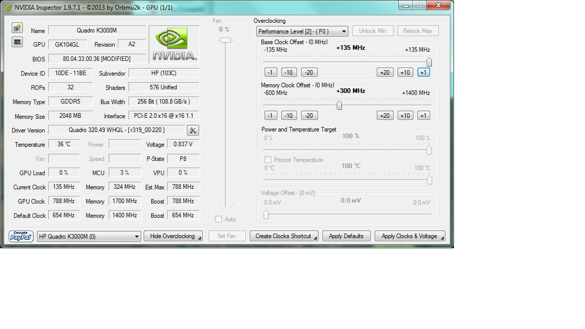

  4. So I downloaded the new driver, (beta). Did a complete uninstall, then rebooted, fresh install, and without trying a new flash it has unlocked the sliders. I am a happy camper! your the man! Thank you so much. I am going to run some benches and report back. I have been running a memory OC of 600Mhz stable for weeks so I will see what the core does.
  5. I will give it a shot. Could you tell if the vbios I posted had the expected modifications? I am trying to determine if the bios is actually being modified. If it is and not unlocking it must be built into the PC. If it isnt being modified maybe I am flashing it wrong or need to do something special for this computer. Thanks for trying so much to help me with this.

  10. here you go. This is the screenshot from inside nvidiainspector.
  11. GPU Slider still locked for GPU. Should it be unlocked for perf level 2.

  14. I'm new to this, should I try and extract the hp vbios first and have it checked out? nvidia inspector reports 80.04.33.00.36 [modified] with a gpu of gk104gl rev. a2
