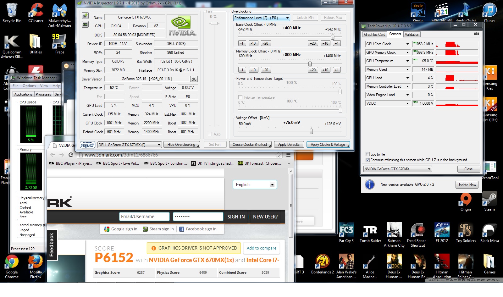

  5. Thought I'd provide a bit of an update to my overvolting/overclocking experiences as it might be useful for people who are trying to tune in an optimum overvolt/overclock. What I've learned is that as overvolting increases then diminishing returns seem to start to kick in, even if temperatures are still kept at the same value. It's easiest to see in table format I think:
    Core Voltage Increase (mv) Core Voltage (V) Core Mhz Core Temp (degC) 3DMark11 GPU Pscore
    +0 0.925 900 63 5511
    +37 0.962 1006 64 6042
    +75 1.000 1060 64 6287
    As you can see, that last step up to +75mv only gave an additional 54Mhz, so as overvolting is increasing, then the amount of increase of stable overclock is also decreasing. Temperatures are the same across the board, because the fans just kick in harder and earlier with the higher voltages, so +37mv is a bit quieter overall than +75mv, so that is a bonus too. Comparing my overall voltage to stock voltages used on the GTX 770M, which is the exact same chip as my GTX 670MX, then 770M has a core voltage of 0.968V, which is pretty much the same as my +37mv overvolt (0.962V). This makes me think that the +37mv overvolt is going to be 24/7 safe, as it is the same as the stock voltage used on the GTX 770M. What do you guys think, do you think in light of that, that my +37mv overvolt will be safe for 24/7?

    Hey svl7, thanks for providing me with that vBIOS, it works! I managed to up the voltage to 1V, which gave an additional 160Mhz on the core up to 1060Mhz on the Core. Memory didn't want to overclock significantly more than the 1100Mhz that it was already at on stock voltage. Please find attached the pic that you asked for showing that all is working well! 3DMark11 GPU score at P6287 (just a hair faster than an average stock GTX 680M), so overvolting gave me 14% increase in performance over my previous overclock at stock voltage. Temperatures didn't go over 65degC, but the fans did spin up faster (sounds like it did when I had my overclocked GTX 560M in there!). I'm going to game on stock voltage at my previous overclock (in my sig), and then perhaps in the future as games become more advanced I'll overvolt for that extra 14% performance.
    OK, once again, great job svl7, I'll give you a donation in the morning, need some sleep now!!
    EDIT: I noticed there's a splash screen after pressing the power button, before posting, where it flashes up your name & tech inferno something or other. What's that for, it wasn't there as part of your previous vBIOS?
    EDIT2: GPU is using about 20W more with the overvolt and increased overclock in comparison to my previous overclock at stock voltage. No surprise really, voltage makes a big difference!
    EDIT3: Yep, there's that beer for you!
    EDIT4: Gees, I love these edits! Just some additional info for anyone reading this, I had to run NVidia Inspector as an administrator in order for clocks & voltage to stick.
