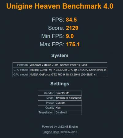

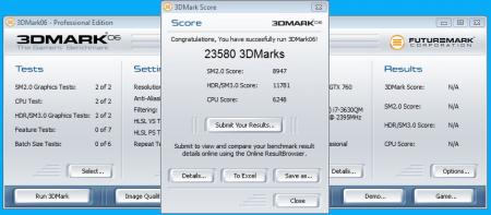

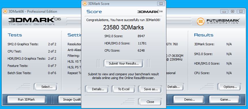

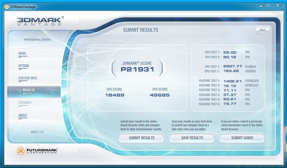

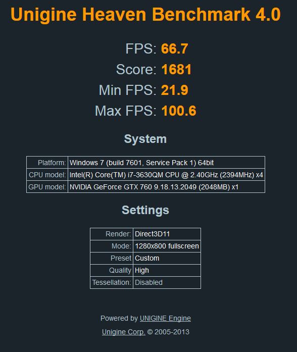

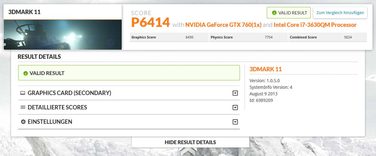

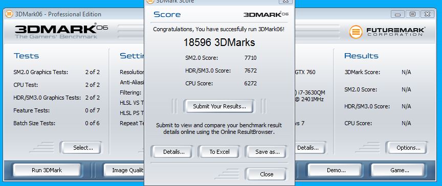

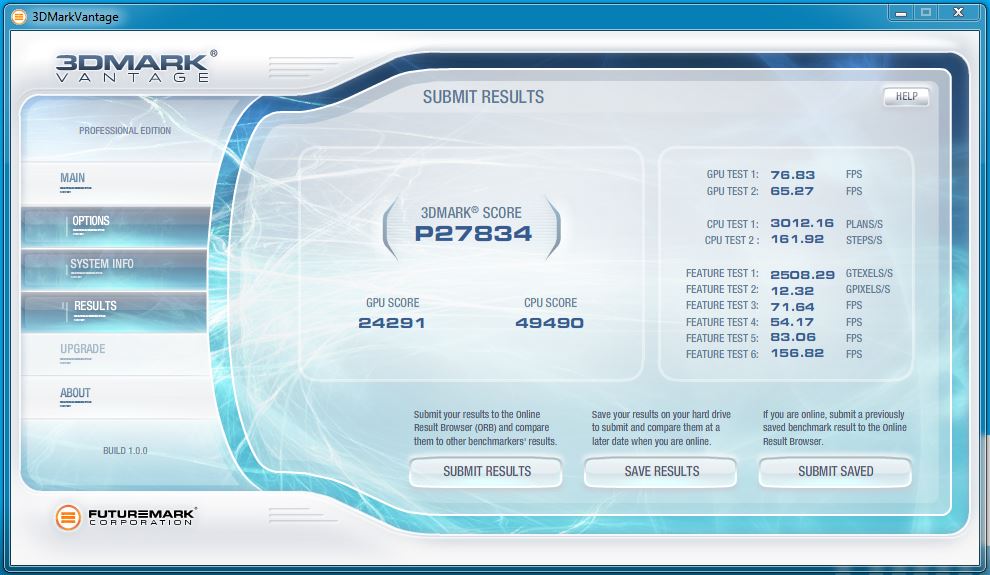

Referring to my old benchmark results, I experimented with some overclocking settings with my GTX 760. I recognized that the clock and memory speed, in comparison to other 760 cards, were reduced by factory. With ~12% overclocking the results are much better. I couldn't believe that the difference would be so huge. Probably I will give also CPU undervolting a try. all with external display: 3dmark06, 3dmarkVantage, 3dmark11, 3dmark13 Specs: Lenovo T530 Intel i7-3630QM, 8GB DDR3 RAM, HD4000 + Quadro 5400M Inno3d GTX760 Herculez 2000s - 2GB - [email protected] Windows 7 Prof. / 64 Bit eGPU setup: PE4L v2.1b with EC2C (100cm) 450W SFX-PSU Setup 1.3 external: 23" 1920x1080 Nvidia driver 344.48

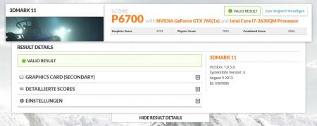

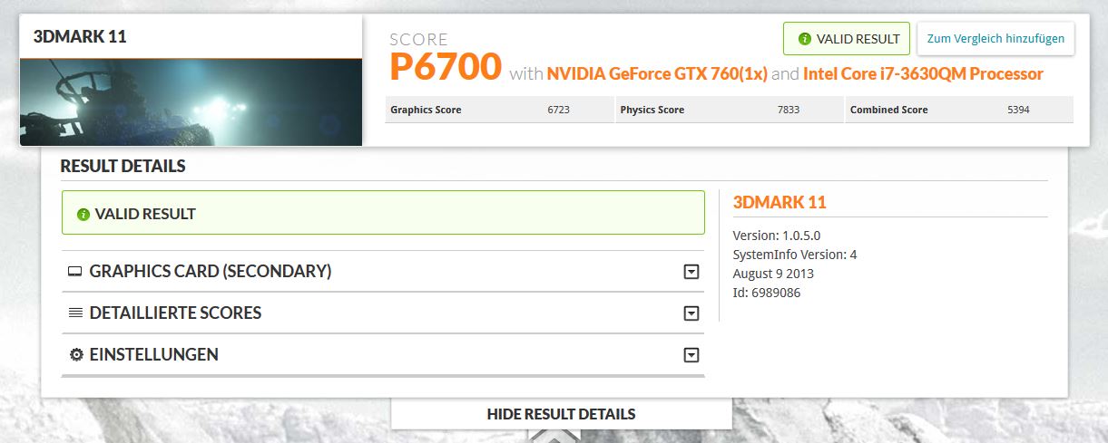

Hm, I reinstalled the driver and now the result is 6867 points in 3dmark11 for the external display. By the way the new GTX760's are only new labeled GTX660 Ti with an higher clock and more bandwith which results in ~10% more performance. I took the new one cause the difference in price was only 17€. -
So I will not be able to complete this benchmark results, cause I alredy sold my old GTX460 Hawk. Now I have a Inno3D GTX760 Herculez 2000s, which fits perfectly in my modified Lian Li Case. Here are my new benchmarks: 3dmark06 (1280x1024):+++++++++++ 3dmark Vantage: ++++++++++++++ 3dmark11: - internal display: +++++++++++++++++ - internal display:+++++++++++++++ - internal display: - external display: ++++++++++++++++- external display: +++++++++++++++ - external display: heaven (1280x800): - internal display: - external display: Specs: Lenovo T530 Intel i7-3630QM, 8GB DDR3 RAM, HD4000 + Quadro 5400M Inno3d GTX760 Herculez 2000s - DirectX11 - [email protected] Windows 7 Prof. / 64 Bit eGPU setup: PE4L v2.1b with EC2C (100cm) 450W SFX-PSU Setup 1.x (110b5) with Update for Intel7-Chipsets external: 22" 1680x1050 LCD Nvidia driver 320.49
