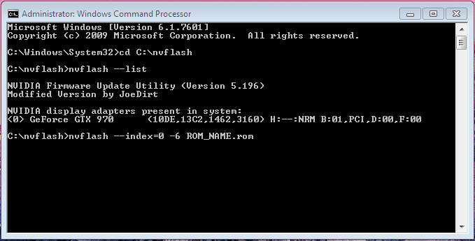

when your flashing are you doing --index -0 -6 gtx870m3g.rom ? it should override board id mismatch

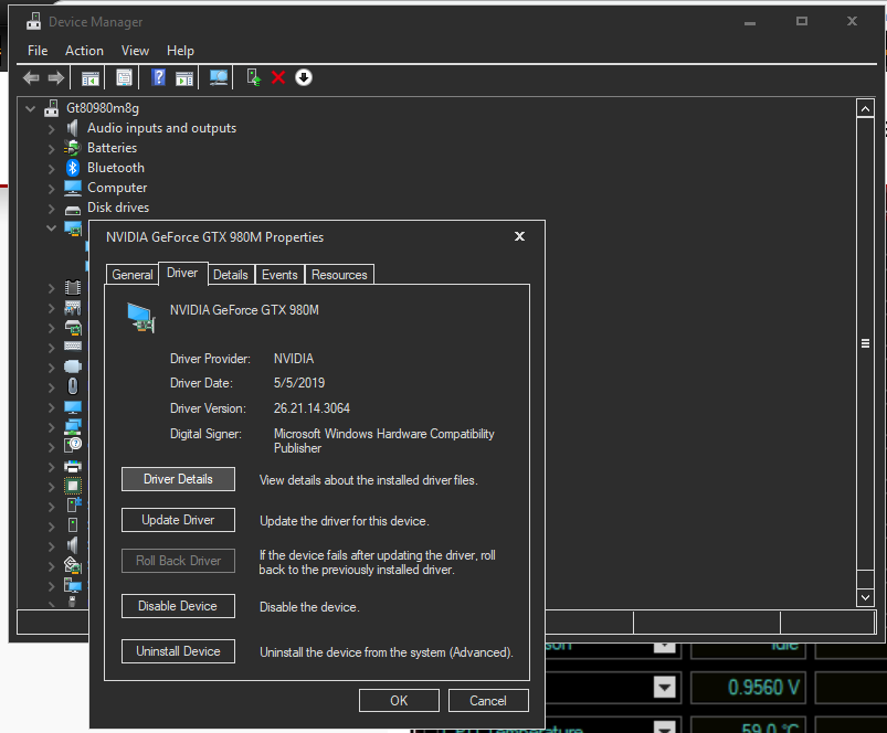

also is the gpu disabled in device manager before flash ( lol just checking ..one can never be too sure )

Well, I was going to try to disable it, however, it won't let me do that. It probably has something to do with there not being any onboard graphics.

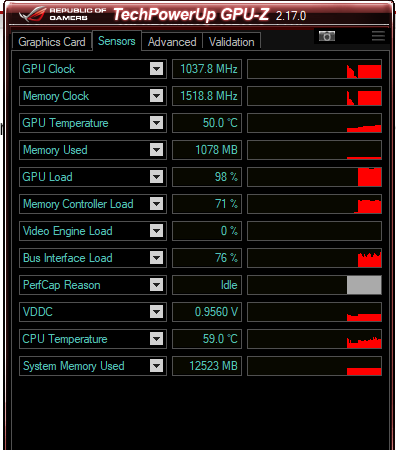

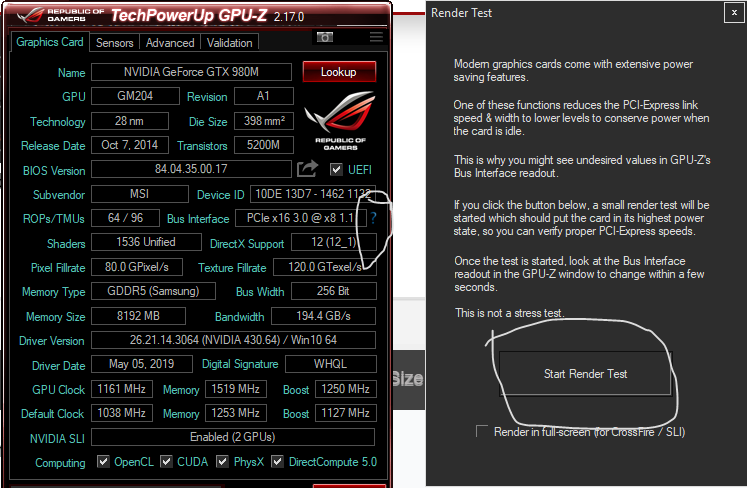

do you have GPUz it should show the clocks and will show whats holding the card back
as for the device manager if right clicking the gpu doesnt work in properties it should allow you
In device manager, the box where it says to disable the GPU is grayed out. This could be that there's no internal GPU.

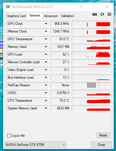

As for GPUz I have a screenshot of that too.
What did you use to stress the GPU? I was just using BeamNG

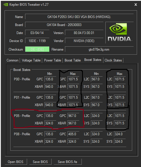

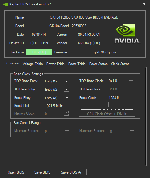

this is the bios
on the second image are the phase states ( p00 p01 p05 )
if its stuck at 967mhz for some reason it's stuck P05 state

On nvidia inspector it shows that the power state is on P0. I don't see power states in GPUz.
Also, apon flashing the vbios. When I reboot, it should show that the bios is modified on GPUz, right? GPUz or Nvidia Inspecter.
i have a dual screen set up  most of the time i run a game on one screen and look at gpuz on the other
however gpuz has a benchtest
as far as i know gpuz wont show (modded) but i do know nvidia inspector will show if its modded or not
so even with an over clock its still stuck at 967mhz?

I've also tested to see if the vbios you gave me actually flashed to the card. I used NvFlash to get the vbios off of the Gfx card and I put the vbios file in Keplar BIOS Tweaker. The boosts clocks are there in Kepler BIOS Tweaker.

you can mess with it with the bios keplar tweaker  on boost states but it varies from card to card
