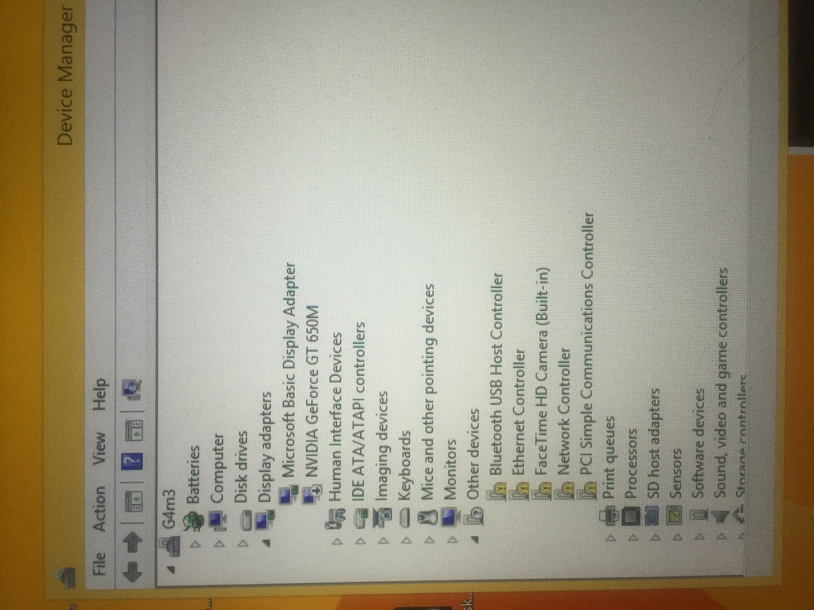

So I managed to install win 8.1 EFI on external USB3 HD
All checked in system32 info that it is EFI indeed
two issue:
-my device manager does not see my external GPU :/ The GPU works just fine in OSX so there is no hardware issue
-whenever I install the GPU drivers I end up with a black screen.
These issue seem to be linked to an inappropriate EFI on my machine ?
Would someone have any workaround by any chance ?
Black screens like I have and EFI installations are documented over the web but is it the end of the road ?
Since my HD is external I guess refit would be useless ?
Im not too sure why windows does not see the card at all
Installed latest bootcamp drivers except nvidia; thunderbolt drivers should be installed. I also tried to install manually from the bootcamp drivers all intel chipset but can't get the card detected at all.
My machine is 2012 MBPRD with windows 8.1 installed with EFI on USB3 HD
please help, Im soooo close :D
