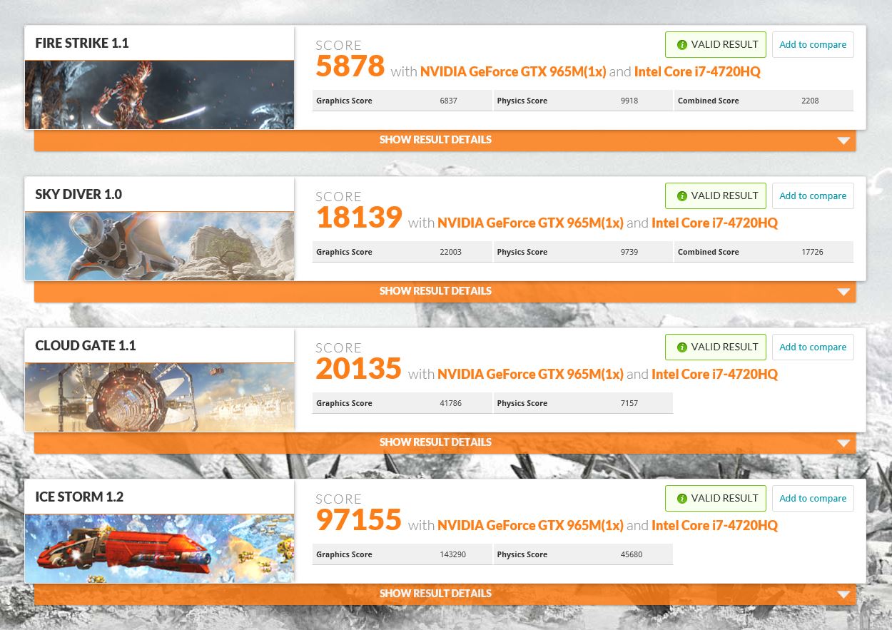

a424c6459624856.jpg 4a9b33459624882.jpg 6122ad459624913.jpg 1d5f80459624950.jpg 2e4438459624968.jpg 6d0ab2459624996.jpg 8e586a459625041.jpg dec9e5459625124.jpg cde0d1459625166.jpg 9aee5b459625208.jpg f28153459625220.jpg 7f9b2d459625230.jpg e51459459625254.jpg 32e820459625272.jpg

Nice system & bench! :)
We have a benchmark section here:
Your vBIOS looks way off and heavily miss-adjusted. It doesn't match the sensor log at all...
GTX965M stock turbo should be 950Mhz and not 823Mhz. With an OC of  492Mhz+ the 3D base should show 1023 and not 745...
IIRC I made a vBIOS for your system for someone a while back...if you want I can search for it.

Hey Prema! honestly I'm a beginner in overclocks and I'm trying to understand by myself what I'm doing, with support of some forum... last BIOS was not stable, for example memory gave me a lot of errors with OCCT, so I kept it at standard value... also sometime I have a Perfcap Pwr that I don't know if that's related at Power Tables or Voltages... maybe I can give you my mod for a review (attached BRIDE.zip)? but I want understand where I made a mistake... also you can give me  your version and I'll compare it, up to you :) I also bought a PSU from 150W to180W, we will see...
