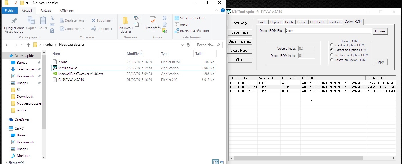

hi, im traying to OC my gtx960m But i've got a problem.here is the step i've done.

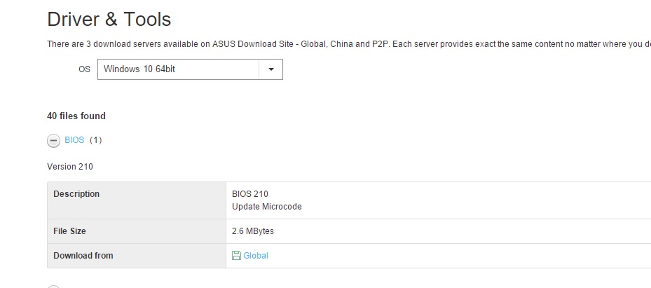

step 1 : get the bios.

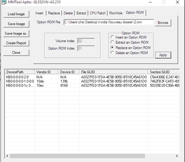

step 2 : get the vbios with MMTool.

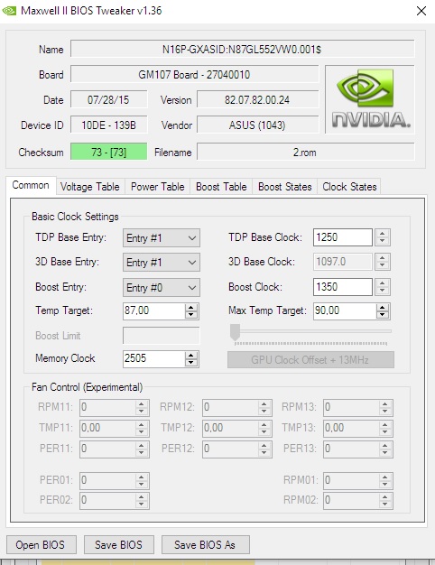

step 3 : customise the vbios with MaxwellBiosTweaker.
step 4 : update the bios with the dumped vbios.

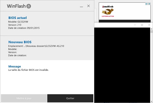

step 5 : flashing the bios but it says that is not the good size.
bios.jpgmbt.jpg.e9e05dd5ff7178c793b89a1a4451425d
