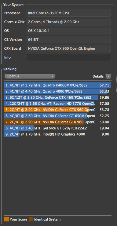

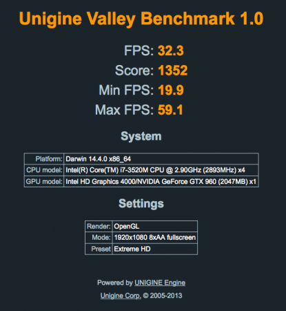

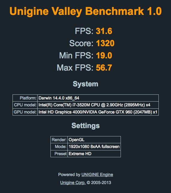

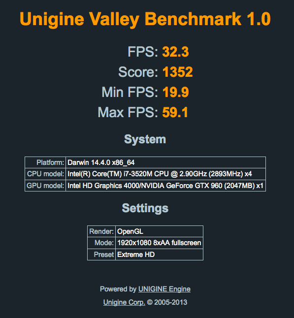

I don't get the same huge improvement, but there definitely is some improvement, ±2~7%.
Might be somewhat bottlenecked in my setup, but idk for sure.
Setup: Macbook Pro 13" Mid-2012, i7-3520M @ 2.90 GHz + GTX 960, OSX 10.10.4 [link]
Unigine Valley
31.6 fps » 32.3 fps
Cinebench R15
50.40 fps » 53.78 fps
The bottleneck for you is Thunderbolt, Those test's are inside a Mac Pro through pcie 2x
Great OpenCL performance gains though
