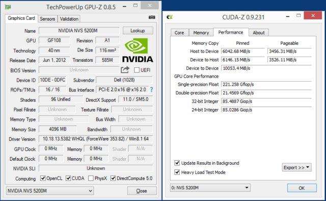

Rbrito Posted December 6, 2023 Share Posted December 6, 2023 Hello, I know this is a old thread but i got a problem that can't findo anywhere. My NVS 5200 stop to show on bios and i simply can't install anu driver (besides the Micorosft basic displau). GPU-Z detects his presence however without any memory or clock frequency. Is it dead? Can i revive it by reflashing his firmware (wich is another problem: can't find it anywhere). Any help will be much apreciated. Quote Link to comment Share on other sites More sharing options...
