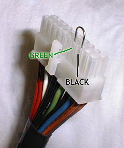

1. Using the 'paperclip trick' to turn on the ATX PSU
atx.gif atx-power-bypass.jpg Connectiong PS_ON (green) to COM (black) on the ATX motherboard plug using a paperclip as seen on the left turns the power supply on. Means the 12V/pci-e power outputs will then be active.
- for ATX PSUs with a OFF/ON switch : when when you attach the mains cable into the PSU and switch ON/OFF to ON the ATX PSU to ON, it will become active
- for ATX PSUs without any OFF/ON switch :when you attach a mains cable into the PSU it will become active. If you require an OFF/ON, then wire through a on/off switch in place of the paperclip OR just pull the mains lead.
There are many google images of how to attach the paperclip if the ones on the left are unclear.

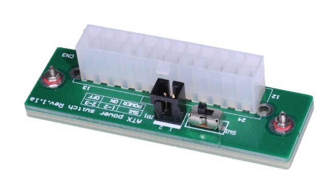

2. Using a SWEX to turn on the ATX PSU
SWEX%20V1.2_A1.jpg A US$9 BPlus SWEX wires through the PS_ON# and COM leads in exactly the way as the paperclip trick does above. It does however include a nice on/off switch plus includes a JP1 connector which can accept an externally wired active_low signal to power on the PSU.

As a more temporary solution, you can also shove the paperclip on the "wire-side" of the 20/24-pin plug. I've done this when forcibly jump-starting a motherboard (to my surprise it actually worked).

For eGPU and other more permanent solutions I recommend getting a SWEX. It is a very safe and very reliable method.
