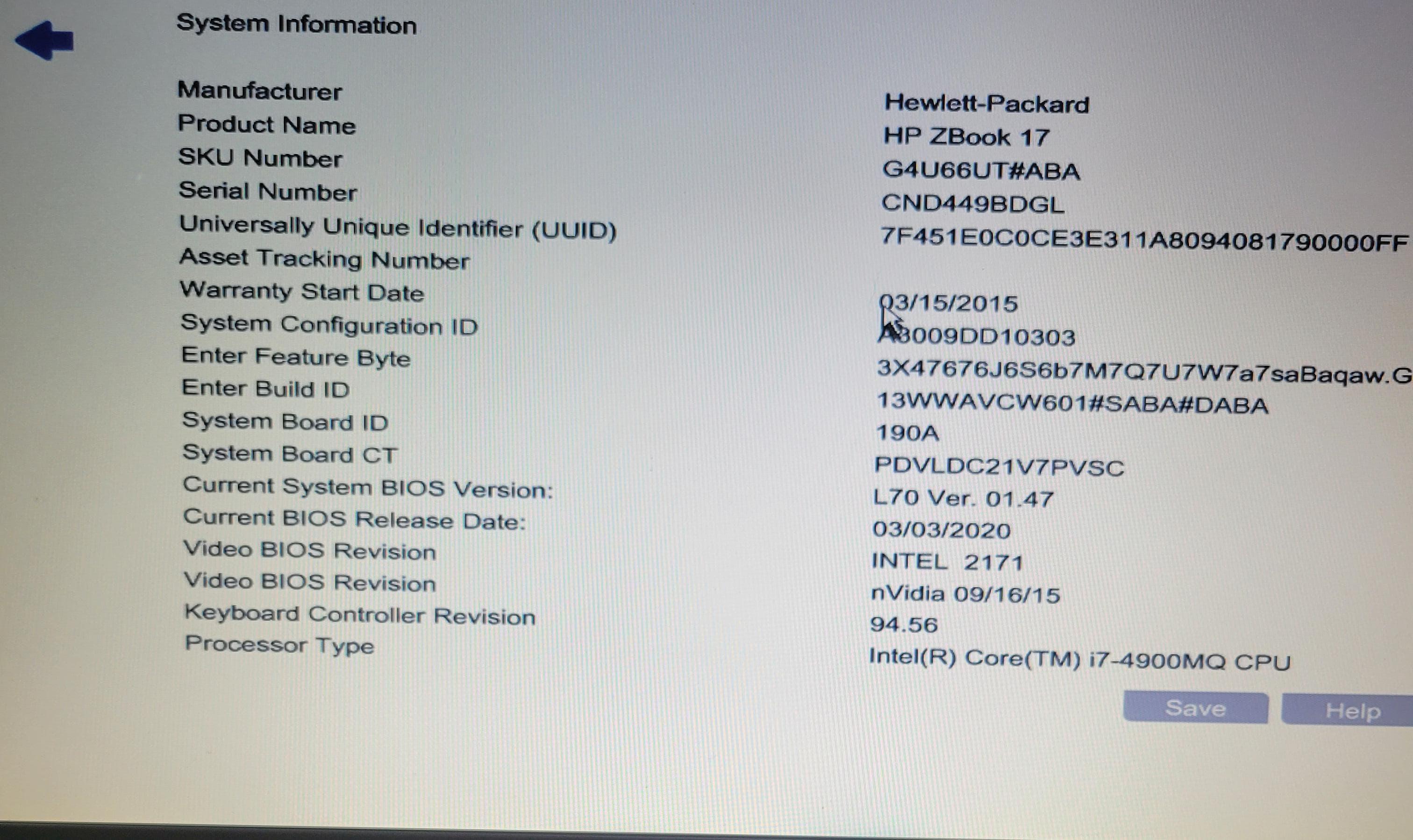

This is my question: I currently have an HP Zbook 17 G1, which has a Clevo GTX 980M installed, everything is fine, but the DP and MDP (Thundervolt) ports do not offer video, but the VGA does. The laptop's BIOS is 01.47 Rev.A and as you can see it is detected by the BIOS. I would like to know if anyone has experienced this situation with this laptop and if a small solution is possible.
PS: I had an M4000M installed and the DP port worked and the BIOS did not detect it.
