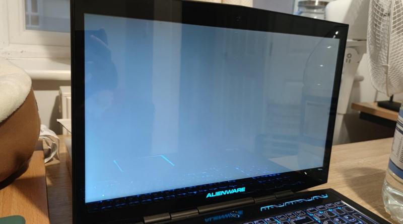

So I contacted prema mod directly and they sent me the files necessary for the 980m on Windows 10 with my M17xR4. After installing I still get the same problem as when I manually edited the .inf files and my screen just goes blank and is unresponsive.
Any ideas how to fix this? Have I done something wrong?
