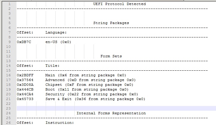

1.found setup and transferred to txt - the main menu shows 6 items, which are only five when the BIOS is loaded, there are no Advance and Chipset items (the Advance item is visible when started bios and the Advanced(from a Setup.txt file) - different item)

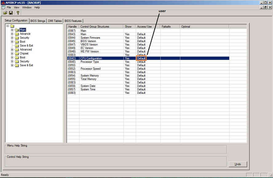

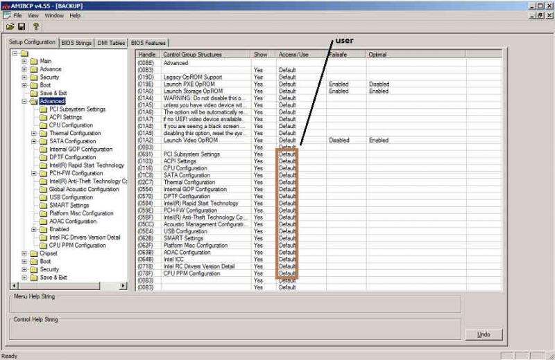

2.also found the sequence 01 00 00 01 01 01 00 00 00 00 in the extracted amitse, , which was corrected by me (01 01 01 01 01 01 00 00 00 00) and flashed.
This did not work. Can someone have a solution or thoughts on unlock the hidden settings and change the logo? I will be happy with any help or advice.my bios region
