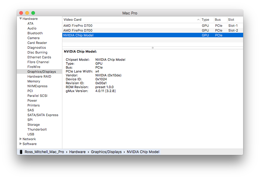

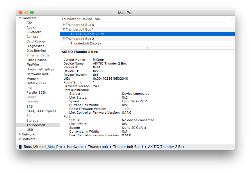

I have tried this multiple ways, each after an uninstall, reboot, and a fresh install. The options I've tried:
-a
-skipdriver
-m
In all cases, the behavior has been the same. The eGPU is visible under System Report (see attached screen shots). However, since this is a Tesla card, it does not have any video out connections (strictly for GPGPU / CUDA). I do not have an external monitor connected to the eGPU. This appears to cause problems after reboot (main monitor, Apple Thunderbolt) is on, but "dark" (slight blueish glow, but nothing displayed, shortly after the Apple logo appears).
Also, if I logout, I lose the main display, same features as above.
It looks like the driver really really wants a monitor attached to the eGPU.
Is anyone aware of a potential fix for this issue?
