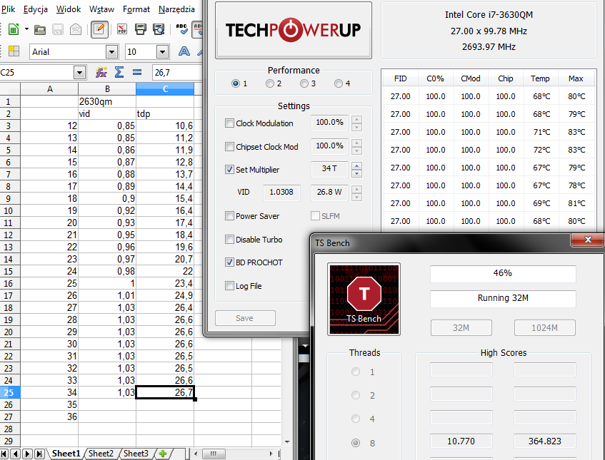

I need to check 3630QM one more time. Cause after swap from 3630QM to 3632QM I wasn't able to run benches (x12 to top) If I didn't restart throttlestop. Maybe the same happened when I got x27 on 3630QM (on the picture You can see during top 3630QM setting, throttle sees only 27x).- 1884 replies

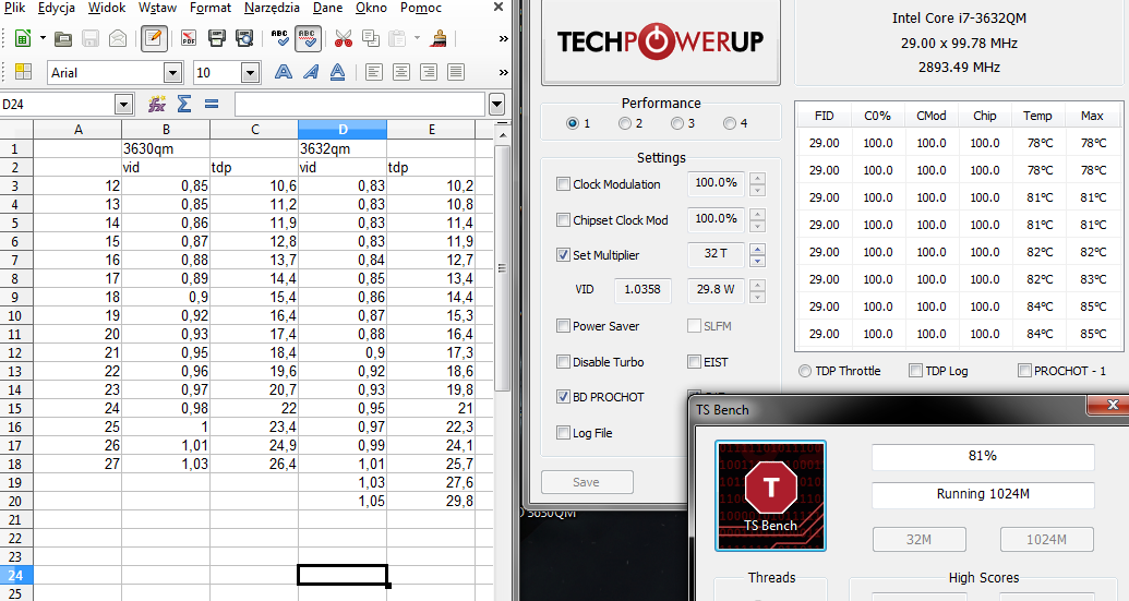

Yes, This is correct. x12 x13 x14 x15 x16 x17 x18 x19 x20 x21 x22 x23 x24 x25 x26 x27 x28 x29 i7-3630 VID 0,85 0,85 0,86 0,87 0,88 0,89 0,9 0,92 0,93 0,95 0,96 0,97 0,98 1 1,01 1,03 NA NA TDP 10,6 11,2 11,9 12,8 13,7 14,4 15,4 16,4 17,4 18,4 19,6 20,7 22 23,4 24,9 26,4 i7-3632 VID 0,83 0,83 0,83 0,83 0,84 0,85 0,86 0,87 0,88 0,9 0,92 0,93 0,95 0,97 0,99 1,01 1,03 1,05 TDP 10,2 10,8 11,4 11,9 12,7 13,4 14,4 15,3 16,4 17,3 18,6 19,8 21 22,3 24,1 25,7 27,6 29,8 [ATTACH]10068[/ATTACH][ATTACH]10069[/ATTACH]- 1884 replies

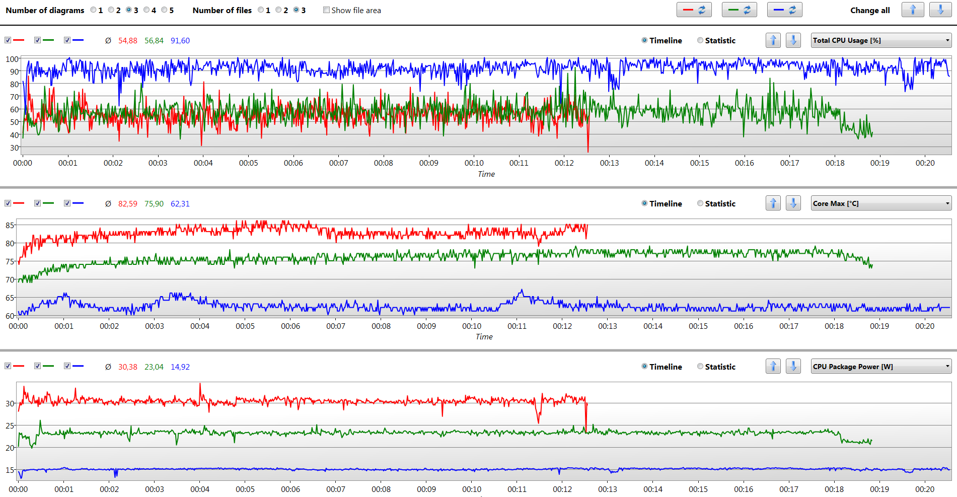

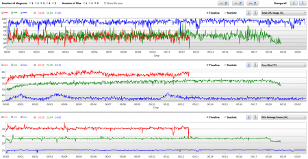

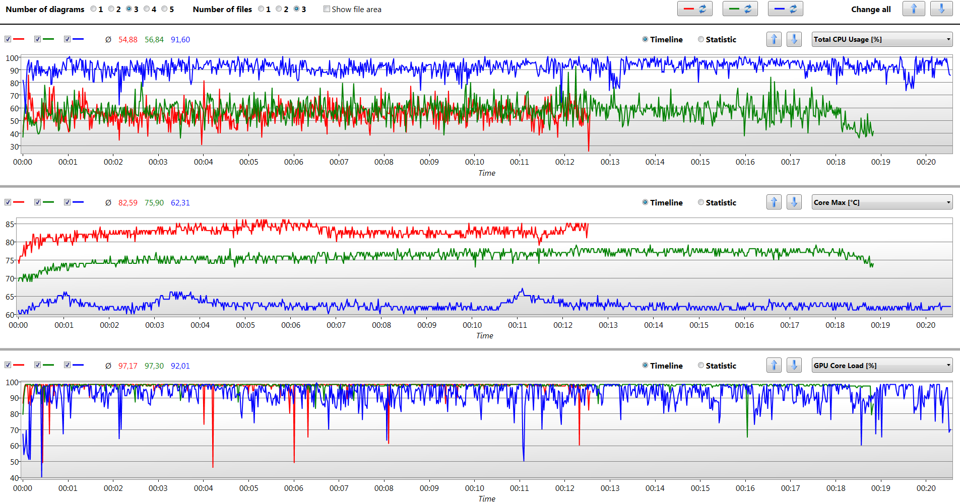

But there is a one difference. Core load playing on i5 is not so stable loaded as during i7QM. It should improve min and avg fps in playing, theoretically. First plot: GTX670 on i5M vs i7QM, BF4, FHD, medium, 32x32, blockade. Second plot: GTX670 vs GTX680 on i5M, BF4, FHD, medium, 64x64, blockade.
comparison between GTX670 PowerEdition MSI TFIV vs GTX680 OC MSI TFIV. i5-3230M+BF4+medium+FHD+64x64+blockade. few pages ago I mentioned that there is no difference between GTX670 with M and QM CPU, and unfortunatelly probably the same situation will be here, cause this GPU are very similar. Pity there is no differences between GTX670 and GTX680.
