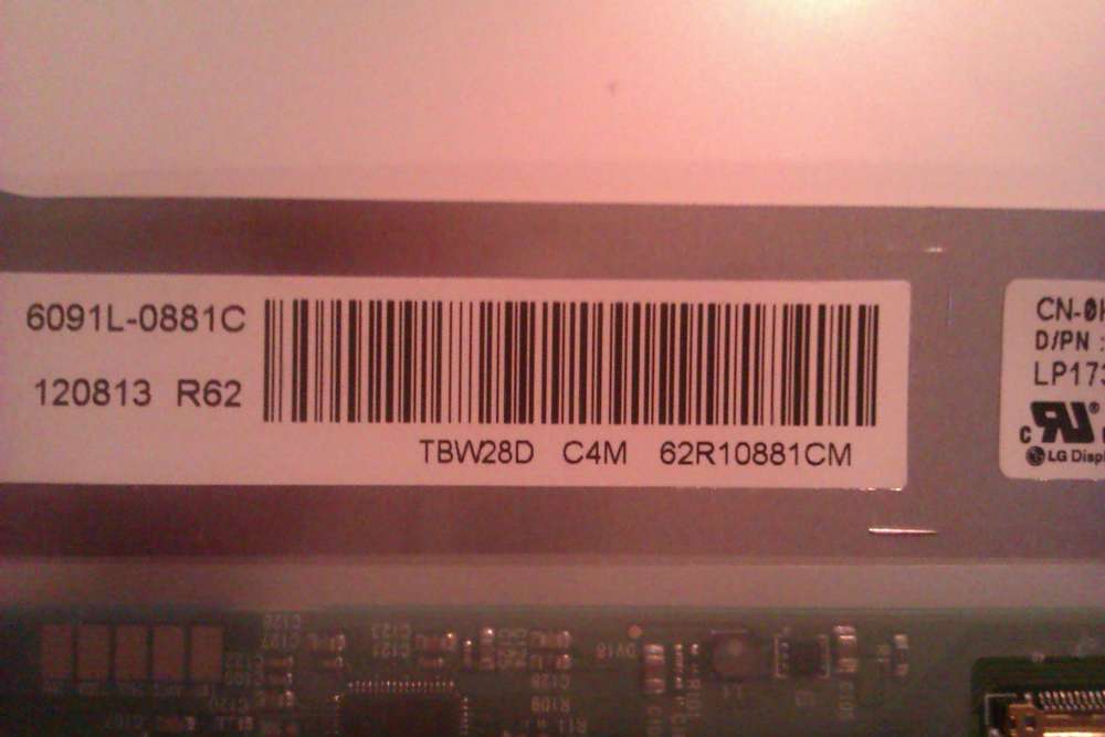

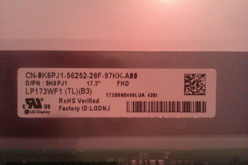

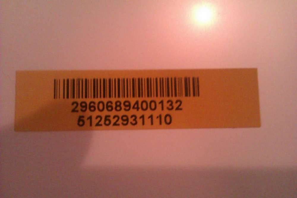

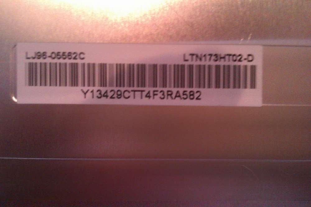

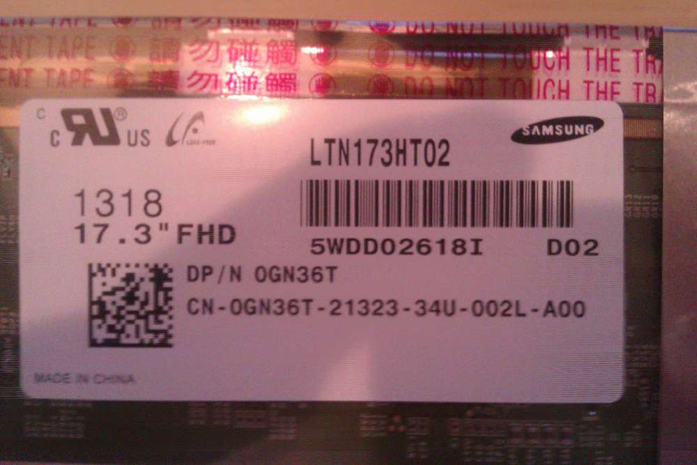

    Here are the model numbers of the screens as jpg
  2. Broke my original screen, bought a new one from https://www.laptopscreen.com/English/model/Dell/ALIENWARE~M17X~R4/
    but decided to go for the new 3D version instead of the original i broke. Popped the new one in, and woops the machine is dead, 7 beeps when putting in the battery, all else is black.
    Put back the original screen, same 7 beeps of death. Both screens are virualy identical exept that the 3D version is 120hz, the rest is the same : 17.3-inch WideScreen WUXGA (1920x1080)...
