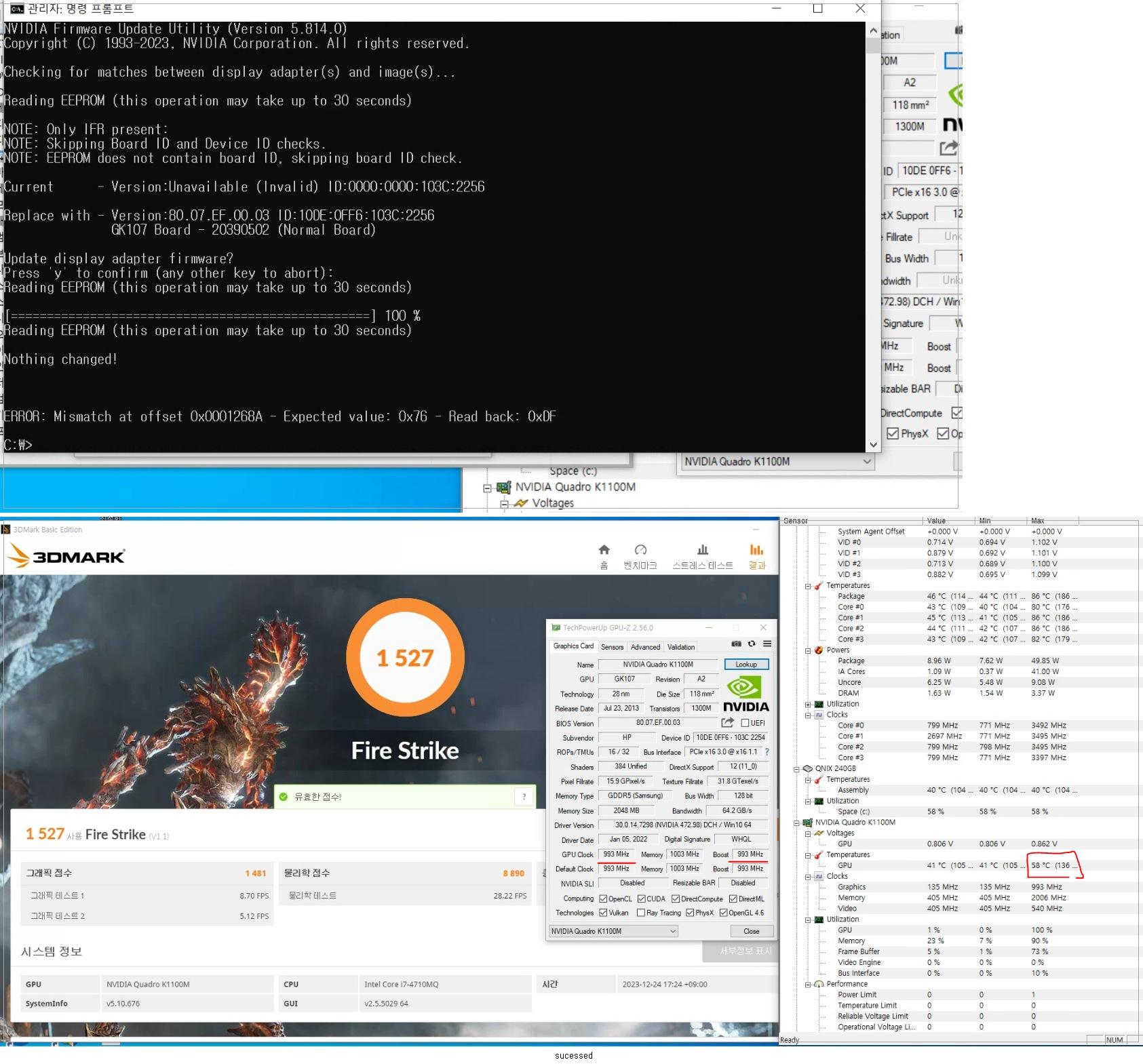

  2. I tried it alone today. I immediately thought I had failed, but I succeeded. 0. In GPU-Z, I dumped the BIOS with the SIV utility because “BIOS reading not supported on this device.” 1. Downloaded the gtx750m bios and modified the values similarly in kepler bios editor. 2. Disabled the display and proceeded with the latest nvflahs64. 3. The first time I tried Nvflash, a mismatch error occurred. However, when I tried it again, no error occurred. 4. The clock was changed, but the screen was bricked because the existing Afterburner was not deleted before Nvflash. 5. After deleting Afterburner in safe mode, it worked normally again. 6. The GPU operated normally at 1150Mhz, but intermittent errors occurred during 3DMark and it was a bit unstable, so I lowered the clock again. 7. For now, I have tried to compromise by adjusting the table so as not to increase the temperature. This is enough to increase performance compared to before. I think it might be helpful to someone. So, I am sharing the quadroK1100m BIOS for the overclocked stabilized HP Zbook G2 here. This operates normally in both non-hybrid (non optimus) and hybrid (optimus) modes of HP Zbook G1 G2. The modified vBIOS of Quadro K1100M has almost the same performance as GT750M. Plz,refer to the attched file hp_k1100m_over.rom

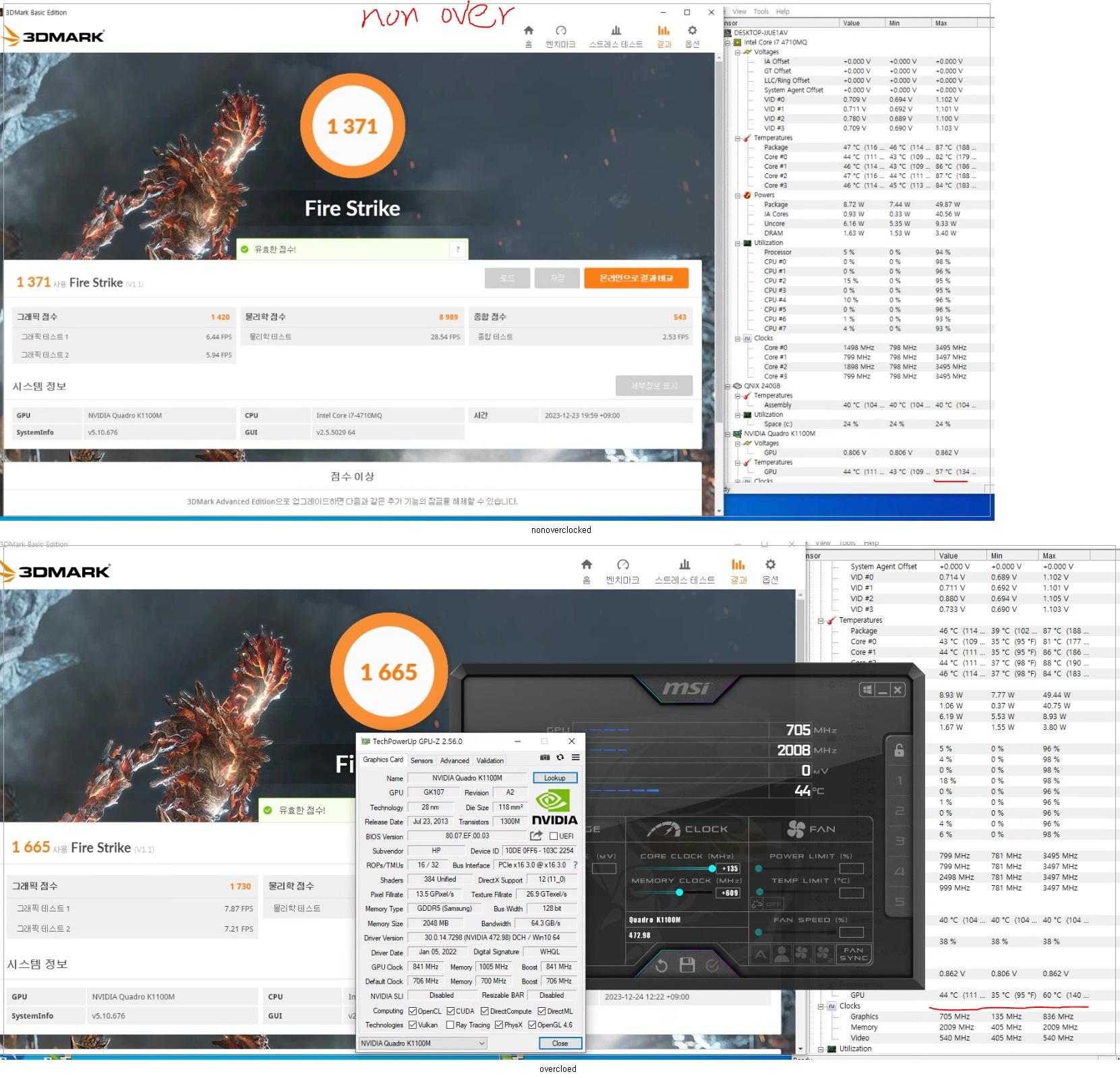

  3. Merry Christmas and Happy New Year. I am using an old HP zbook g2 laptop. This GPU cannot be overclocked using nvidia inspector. I succeeded in overclocking using the AfterBurner tool. However, AfterBuner only supports +135Hz clockover. Therefore, 841Hz is the limit. I want to increase it to 941Hz, but I think that will be possible only by modifying the Vbios and flashing it. The results have definitely improved. However, the maximum temperature of the GPU only increased by 3 degrees. Therefore, it is a card capable of additional overclocking, and is the same platform as the GT 750M. I would like to modify the vBIOS of this GPU. The original ROM is in the attachment to this article. Any help with fixing the vBIOS would be greatly appreciated. ㅇ r HPK1100M.rom
