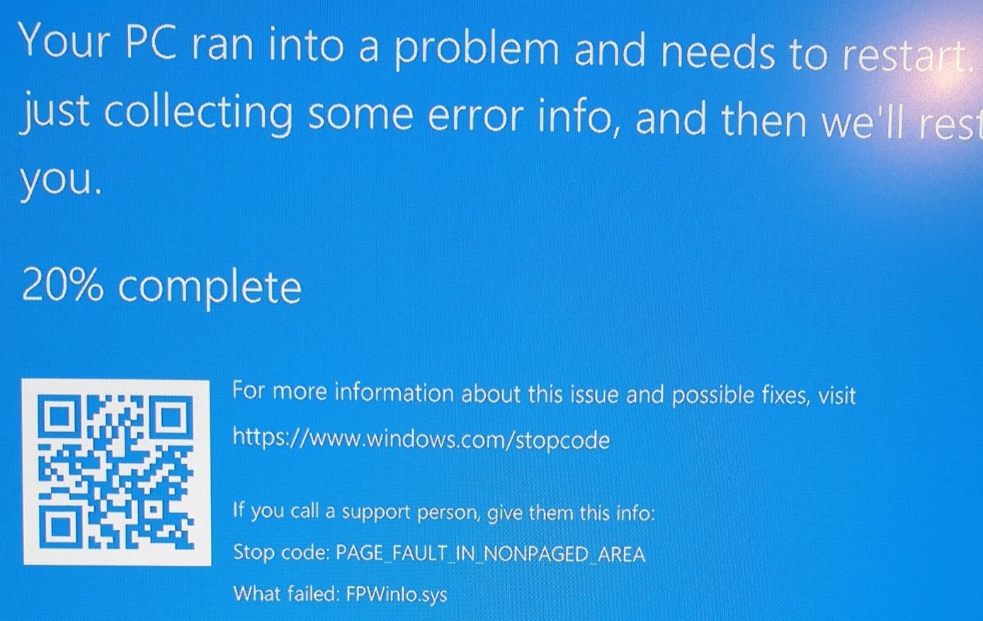

I ran the driver booster to try to speed up the system and got this, i can't do anything about it. What should i do? Nothing is working...

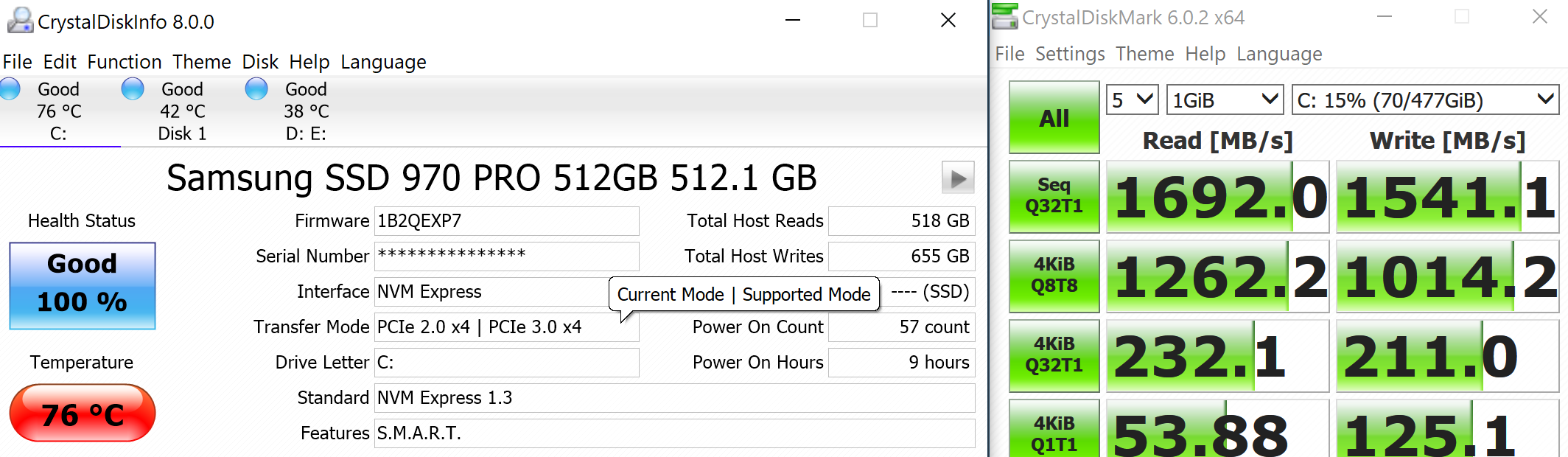

yes, i used it,and it worked perfectly. i am now writing this from the cloned system on my new NVMe! it's smooth it is very good! the only thing is that the speed is not as expected, but that is probably due to the machine which is old... or? do you think something could be done about the speed? i already installed the newest Samsung NVMe Driver 3.1. And i also ordered a heatsink from AliExpress because i don't think any other would fit and it's copper so that's good. https://www.aliexpress.com/item/Copper-Heatsink-Cooler-Heat-sink-Thermal-Conductive-Adhesive-For-M-2-NGFF-2280-PCI-E-NVME/32945025573.html?spm=a2g0s.9042311.0.0.3da24c4d8LsXN4 The only thing is that i don't know if i should use it with the provided thermal conductive adhesive, or with a paste... i think maybe the paste is better. The NVMe is getting far too hot unfortunately (during the test up to 78°C)

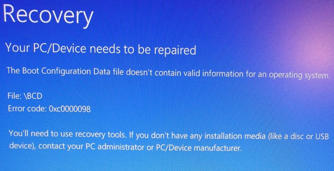

OMG! It's working like a charm! Man, you are genius!! One thing though. Now that it is all set up, i can not seem to boot the system from my old sata ssd any more. I just get a black screen and a white line blinking, like in dos. What to do?
