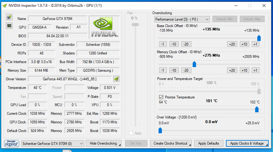

No, It's not grayed out. THe max i've ever tried without overvolting via MSI Afterburner was +102. It wasn't as stable past that.
With overclocking it goes above 967 mhz. I don't think I can change the voltage though.
I've also tested to see if the vbios you gave me actually flashed to the card. I used NvFlash to get the vbios off of the Gfx card and I put the vbios file in Keplar BIOS Tweaker. The boosts clocks are there in Kepler BIOS Tweaker.
With a +60 Mhz offset on the core it gets 1027 Mhz on the core.
With a +100 Mhz on the memory it gets 2601 Mhz on the memory.
It goes past 967mhz when overclocked.

Hello. I have a GTX 970M 6GB clevo card I want to overclock. It's limiting me to +135Mhz on the core, and I want to push it higher. I have also noticed the over voltage doesn't work. If you could help me, that would be much appreciated.
Below is the attached VBIOS I pulled from my GTX 970M.
