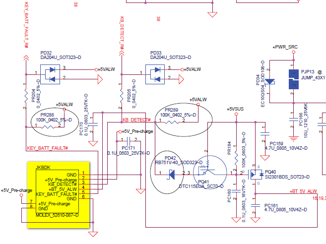

I have a theory that I can mod my vacant mPCIe slot to mSATA, since I have an useless second SATA connector on the MoBo. I've compared couple of schematics and everything that is different is the 4 data lines - in the mPCIe they are obviously PCIe lines, and in the mSATA - SATA. So all I have to do is cut the PCIe lines and solder the SATA lines from the connector which is conveniently placed right behind the mPCIe connector. I'm yet to try this mod, so so far it's just a theory.
