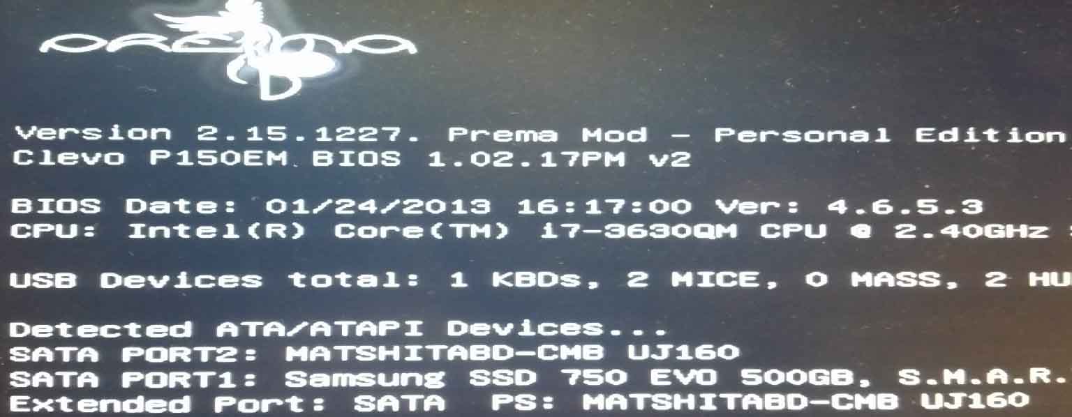

  3. Hello I have a problem with the Clevo P150 I have installed various drivers, old ones, Windows 7 SP1 , Widows 10 and the same problem. Graphics card error and no sleep and hibernation and trouble with Wi-Fi long time to connect around 4/5 min. After installing the drivers most often, the laptop stops responding when the Windows LOGO is displayed. It also happens that it will enter the desktop and then a black screen will appear with the cursor in the upper left corner. When trying to install new drivers, for example, Intel pops up a window: "Your computer does not meet the minimum hardware requirements" After analyzing the problem, I came to the conclusion that it was a power problem and it was not a fault of power supply or motherboard just Prema Bios. My version is: 1.02.17PM v2 Ver 4.6.5.3 If the bios is bad and you have the same opinion, then please provide a link to the latest version and explain step by step how to upload it. Another issue is graphics drivers Which drivers are best for HD7970m amd-catalyst-9.1.0.0 amd_catalyst-12.4.0 amd_catalyst-15.7.1 Or maybe with crimson you are acting eg amd crimson -17.7.2 Maybe I need to change the bios in the graphics card to the drivers from Crimson to work with HD7970m Let's know whether someone succeeded and thanks to him running Battlefield 1 If so please write down how to step by step. Underneath screenshots:
