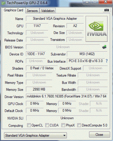

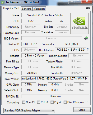

Flashing in dos? or via nvflash in windows? if in windows open gpu-z and try again, it seems unless you activate the gpu it won't see it. That's what I've found anyway. If in dos I have no idea.
OK, well now it sees it. I made it see the card by going to nvidia control panel and adding nvflash to use the dedicated card. Now I have this issue:

I have a msi 16f3 (gt60 barebones) with a 675mx. When I try to install the mod with nvflash, I get "ERROR: No NVIDIA display adapters found". I can confirm my card is working, its the 4gb 675mx, scores 4300 stock on 3dmark 11. Any help would be appreciated, ive seen some get to 6000 on 3dmark 11 with this mod and id love if I could do the same. Thanks.
