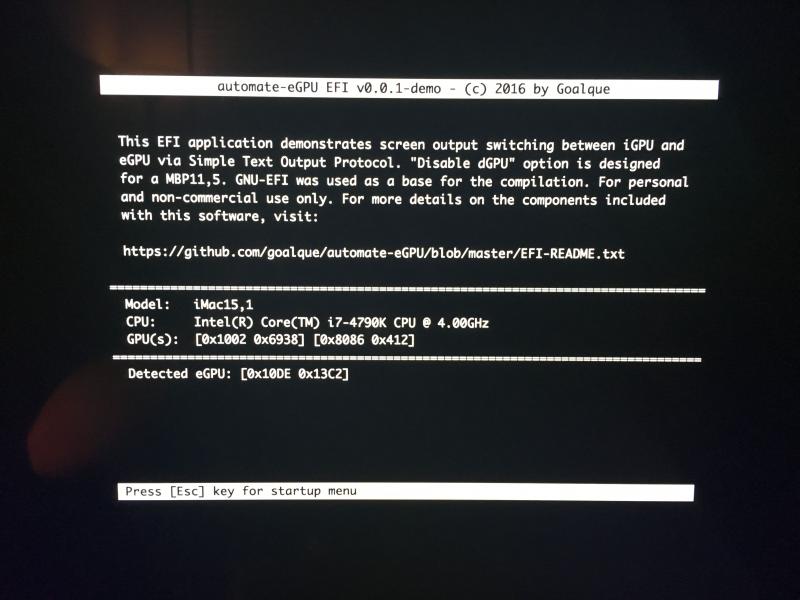

With Load GOP set to on, I press F1 and it reboots into macOSX, but nothing is recognized. This is without your script being installed and without the Nvidia drivers installed. I can see on the EGPU boot drive that an eGPU.efi file is created and a settings fie as well. Do I still need to have the Nvidia drivers installed even with the eGPU EFI? I get a black screen though, any time I try to boot back into the eGPU EFI. I have to delete the settings and eGPU.efi file to get it to come back up. I have a Nvidia brand card. It comes up as this device https://www.techpowerup.com/vgabios/165256/nvidia-gtx970-4096-140826 however the VBIOS and other specs actually match this one https://www.techpowerup.com/vgabios/183593/183593 -

@goalque So I finally had some time to test this out some more this past weekend. I am currently running macOS beta 2 so I understand I'm already pushing the limits of whats available at the moment. The results so far are this, I was able to get the correct ROM (eGPU.rom) file for my board and add it to the boot USB. When I select the drive to boot up, your EFI loader appears and recognizes the card and lets me set Load GOP drivers ON/OFF and changed the Switch screen option to either iGPU or eGPU. I am not able to view anything on an external monitor via the eGPU when I change these settings. But I believe since I have a dedicated graphics card already in my iMac the eGPU can only be used for CUDA functions correct? macOS will boot normally but will not recognize the eGPU at all, even after a few F1 restarts. However using your script I am able to get the macOS beta 2 (Nvidia has beta drivers for macOS Beta 2 367.05.10.05b07 already) to recognize the eGPU card fully and install the CUDA drivers. BUT I cannot get any CUDA applications (CUDA-Z, Resolve, etc) to recognize the eGPU at all. Tried with and without an external monitor plugged into the eGPU. When booting into Windows 10 I have to "time" the plugging in of the external eGPU to right before the login screen, otherwise I get a blue screen crash. If I time it correctly it works very well in Windows 10 and I am even able to drive my Oculus Rift just fine. Hardware: iMac (Retina 5K, 27-inch, Late 2014) Echo Express III-D with Nvidia GTX 970 -

I was able to boot to the eGPU EFI but when I select GOP the screen flashes but doesn't switch output to the external monitor. I wasn't able to extract the VBOIS from my card and GPU-Z says it's not UEFI compatible (does that matter?) When I select lookup it takes me to an incorrect card that says it is UEFI compatible. I tried that ROM version since it's closer to what my card says. I will put the card in a PC and get the real ROM and try again. -
