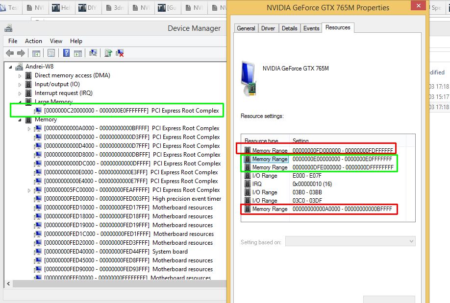

One more question. If I go with the DSDT substitution, and I compact the dGPU to the 36bit space (only dGPU, no eGPU connected) why I still see some resources in the lower space? Shouldn't be everything starting over 1.0000.0000 address? I'm ok with memory addresses allocated in the green rectangles, don't understand the red ones. -
Hi there. I'm trying to get a GTX 680 running using a thunderbolt connection to my Asus G750JW notebook, but so far can't get both cards working at the same time. eGPU = MSI GTX 680 dGPU = Asus GTX 765m iGPU = there is no iGPU, Asus disabled this entirely. So far, using compaction (3.87 & 4 GB) I was able to replace the dGPU with the eGPU, so eGPU was working fine while dGPU showed error code 12. After struggling to make this work, I tried with DSDT substitution (Windows 8.1), I've created my file, then went in Setup 1.3 and called the command: pt MEM writefromfile 1 0x5CB12228 dsdt.aml(0x5CB12228 is my DSDT start address) then tried again compaction on 36bit space, but no success, the computer restarts after trying to load Windows 8. I can confirm the Large Memory Block, if I don't compact, and go to Windows 8.1, I see the Large Memory Block entry there, but eGPU shows Code 12 as usual. Any ideas?

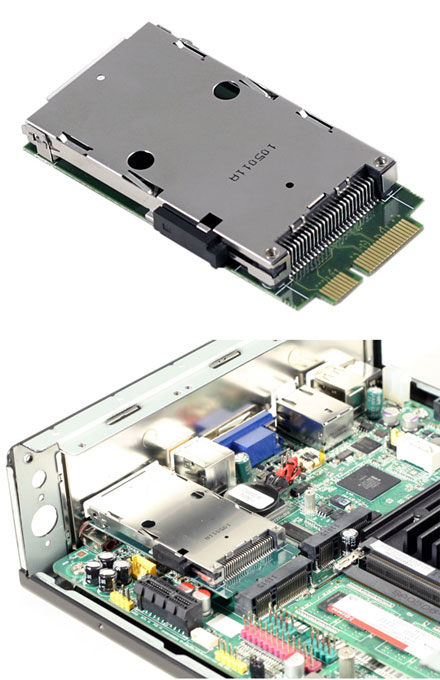

Saw this mPCIe to Expresscard 34 adapter online today. The price is kinda affordable, if I could find a good mPCIe extender capable of Gen.2 I could make a DIY enclosure in the space for the optical bay unit to be able to connect via an expresscard. I'm thinking about a custom caddy, to host a 2.5 inches HDD and also the expresscard slot. http://www.cartft.com/catalog/il/1531
