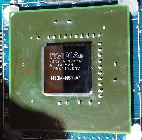

  1. 40K resistor was right one. With 1K resistor, notebook was detecting GT620M, with .960 resistor notebook was detecting some Nvidia Tesla model, without resistor, notebook was detecting some audio device.
  2. Well i am quite confused. Timohour said 1K, you said 40K. That's little bit different value. Thank You anyway.
  3. Thank you! Yes, VGA works, but neither of the monitors which I am using has no VGA input.
  4. Yes, there is difference with it missing. Whole dGPU is not working, so any digital video output is not working, even in dock.
  5. Hello, I changed the thermal paste on my e6430 and I accidentally damaged (it's lost now) one SMD part of the GPU. Does anyone know what the component is (capacitor/resistor/something else) and what is its value? I know I'm an idiot. :/
