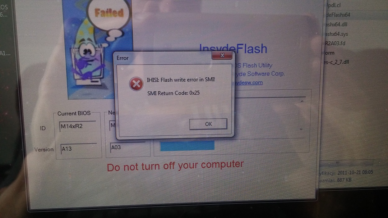

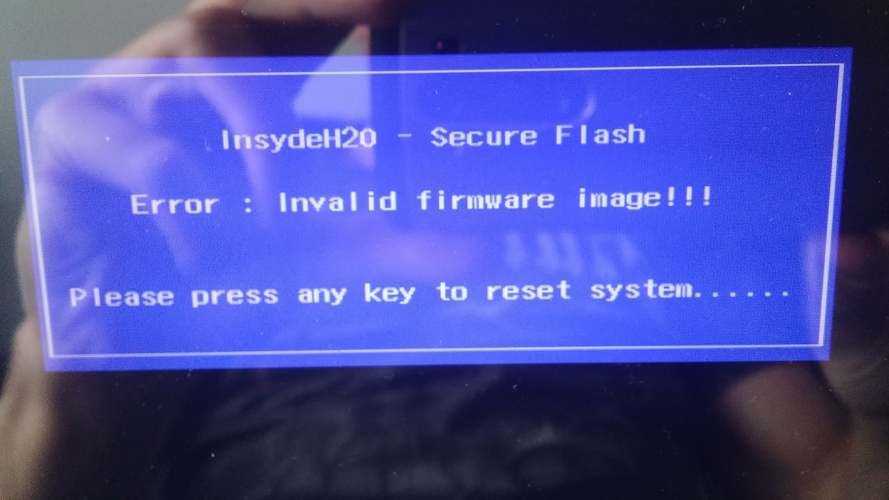

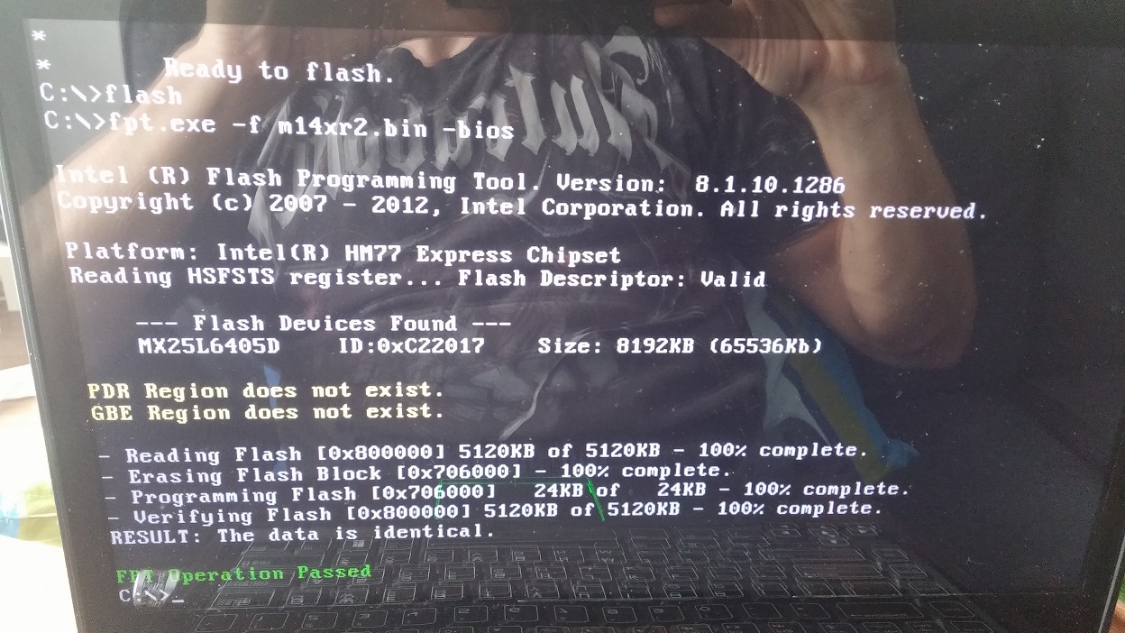

  2. cutting off power and removing the CMOS battery gives nothing. flashing bios from windows not work - a03 stop in windows, a10 stop after restert. flashing bios from dos not quite work. BIOS version varies but is still locked. I do everything step by step how in this topic. I tried to impose a13unlocked on a13stock, a11unlocked on a13stock and wile other combinations.

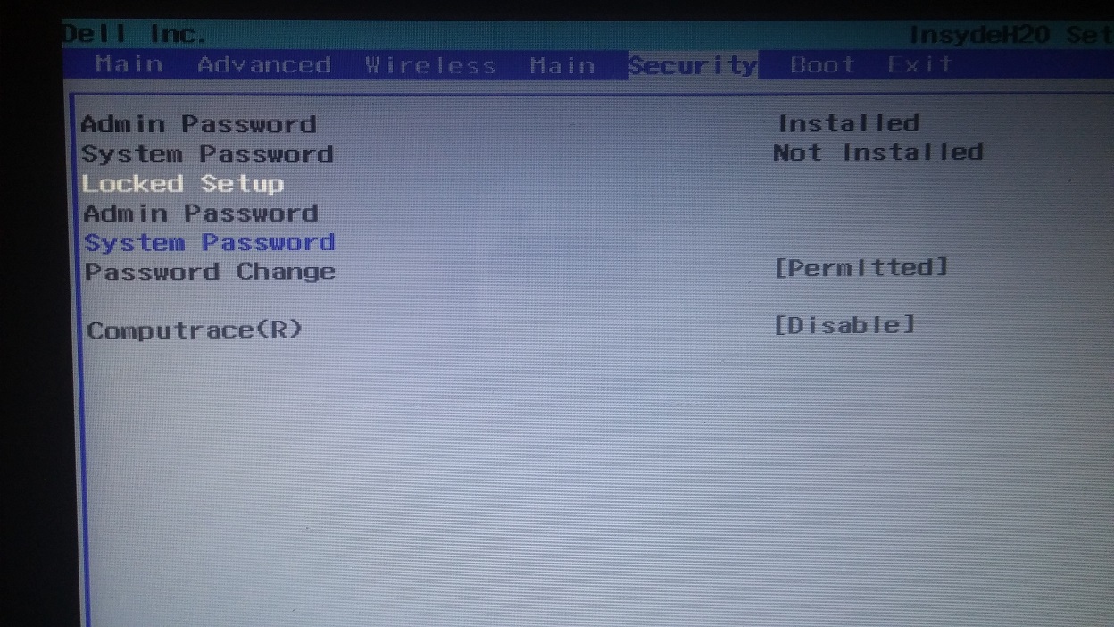

  3. hello I have alienware m14xr2, servis tag - 8J619W1. In BIOS a have admin password instaled. How can I unlocked it??? Upload unlocked BIOS changes nothing beyond BIOS version. administrator password is still installed. Someone can help me??
