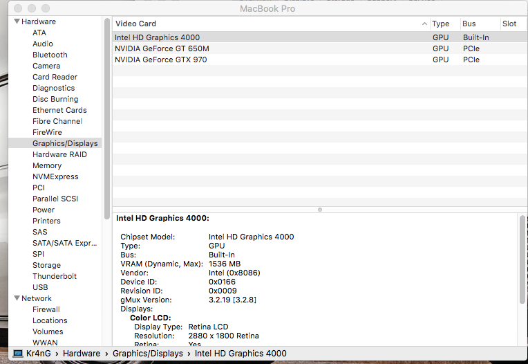

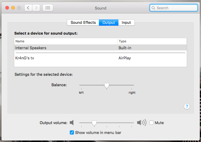

Thank you for the answers. I got answers to questions 2 : 4 : 5. So can someone let me understand question 1 and 3 ? As far as the audio coming out of the egpu I had no luck. Take a look at my screen shots. Ignore the output to my tv that is actually my apple tv not turned on at the moment or plugged in. Can anyone else confirm that they are getting audio out their egpu unit and not the laptop speakers or jack. Also, is it safe to close the laptop or do I need to use an app to make it turn off.

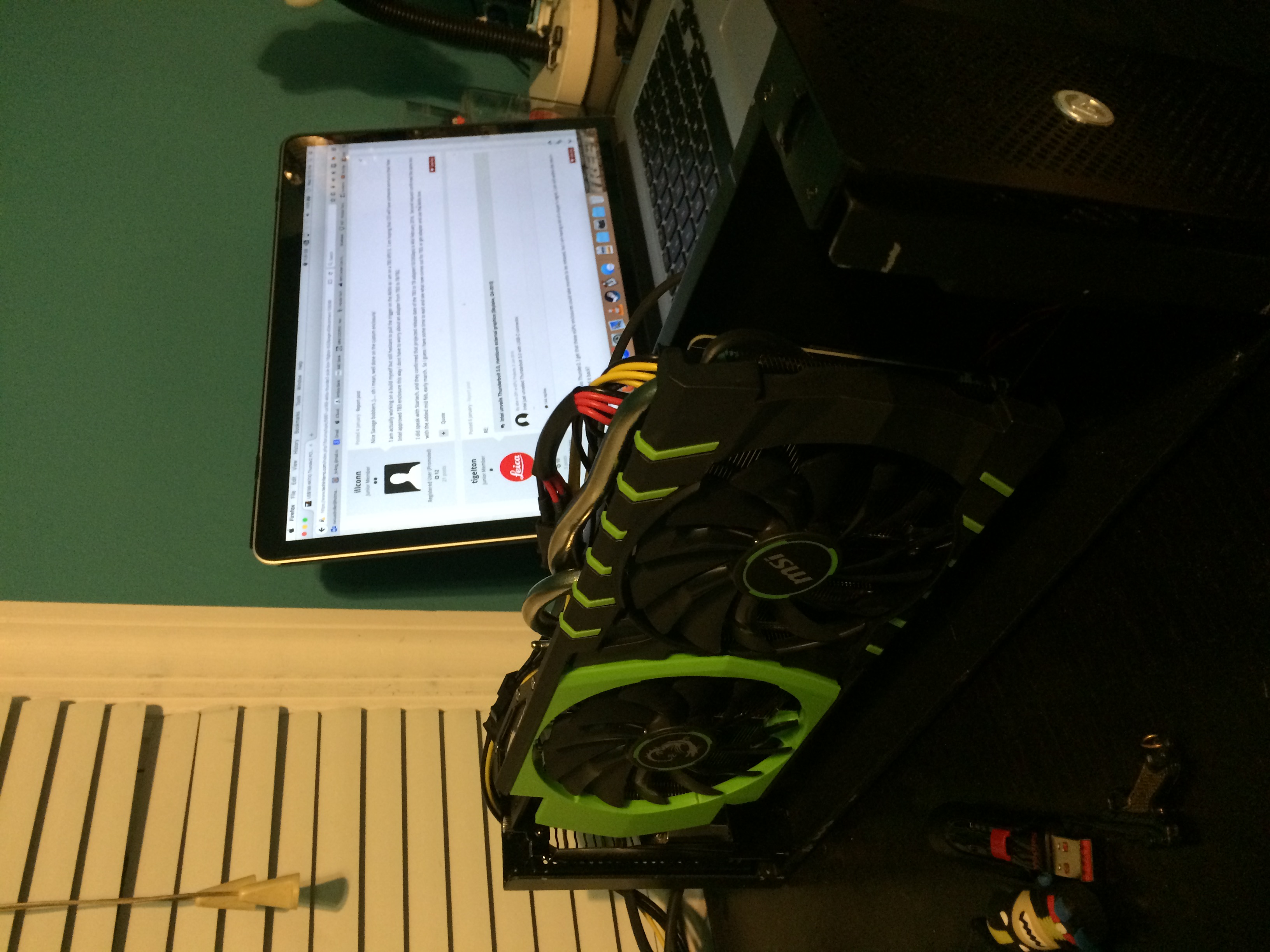

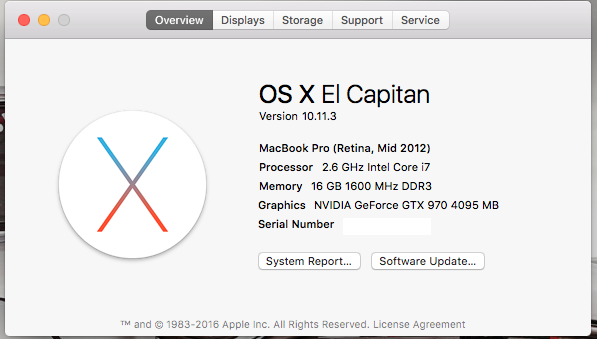

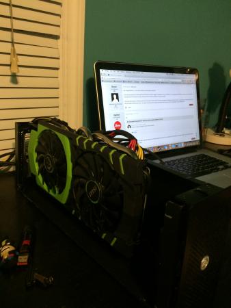

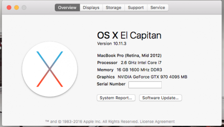

Hello everyone, I just got my egpu running on my mid 2012 macbook pro retina with the gtx 970 MSI 100ME using El Capitan 10.11.3. I used the script to get it going but I have a few questions someone on here could help me out and answer. 1. When I plug my tv/monitor into my egpu my audio comes out my mac and not my tv. Is this normal? Shouldn't I have audio out my tv since I'm using the hdmi cable? Is their a fix to this or do I just have to use my laptop internal speakers or headphone jack. 2. Do I need to plug in a monitor into the video card in order to get the egpu performance? Or this is how it is suppose to be..meaning the performance boost is only their when their is a monitor plugged into the egpu only. In other words, is it possible to get the internal monitor running as the gtx 970 egpu without attaching a monitor to the egpu. It seems that when I dont have a monitor connected to the egpu the mac is doing all the work. Is this normal? 3. What is metaltest.swift (benchmark program I believe). How come I get an error trying to run it. Says: etaltest.swift:1:8: error: no such module 'Metal' import Metal ^ <unknown>:0: note: did you forget to set an SDK using -sdk or SDKROOT? <unknown>:0: note: use "xcrun -sdk macosx swiftc" to select the default OS X SDK installed with Xcode What do I do at this point with it? Can I fix it in a way? 4. Can I reboot and put "csrutil enable" back to the way it was after I installed my egpu and script? Or do I need to let it be at csrutil disable. Instructions told me to make it disable but im not sure if i should enable it back to keep the malware away. 5. I also installed the cuda drivers from the nvidia website. Did I mess anything up? Were they necessary? I would really appreciate if someone could answer my noob questions for me. If you guys need screen shots or pictures let me know. THANKS A LOT EVERYONE.
