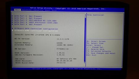

Perfect! Updated smoothly. Didn't fix the G-Sync loss. Going back for repair in Feb anyway. -
BIOS has been updated to 1.05.05. Performed a fresh installed of Nvidia drivers. Still no G-Sync! Laptop is due for hardware based repair in February.

Hi, My reseller recently replaced the screen in my P775DM1-G. A single dead pixel appeared. I figured I'd take advantage of a 28 day dead pixel guarantee. After the reseller returned the laptop to me, G-Sync has gone from Nvidia Control Panel. Was working fine before sending it back. Pendulum G-Sync demo will not allow me to select G-Sync. I'm waiting for their response on why this has happened. Reported on Saturday, not come back to me yet. In the meanwhile, does anybody have any suggestions on how to further diagnose? The laptop was returned to me with a LP173WF4-SPD1 fitted. From a semi reliable memory.. I'm sure that the factory fitted screen was the LP173WF4-SPF1. Could this be the issue? I've checked the CPU ID , and the same CPU is fitted before the repair. The ASIC of the fitted 980 didn't change during the repair, so doesn't look like anything changed there. Just a panel refit. Diagnose so far: 1. Performed Nvidia install with 'perform clean installation' checked. 2. I've performed a DDU clean, and reinstalled latest nvidia drivers. 3. Another DDU clean, and I've gone back to the 359.00 version of clevo nvidia drivers 4. CMOS clear (disconnected battery for 30 sec) New panel: Monitor Name: LG Philips [Unknown Model: LGD046C] Monitor Name (Manuf): LG Display LP173WF4-SPD1 EDIT: 15/05/16 This was resolved when the reseller did a straight screen swap for a SPF1 with a SPF1. New screen and G-Sync active. Looks like getting a SPD1 fitted was the sole issue at the time.
